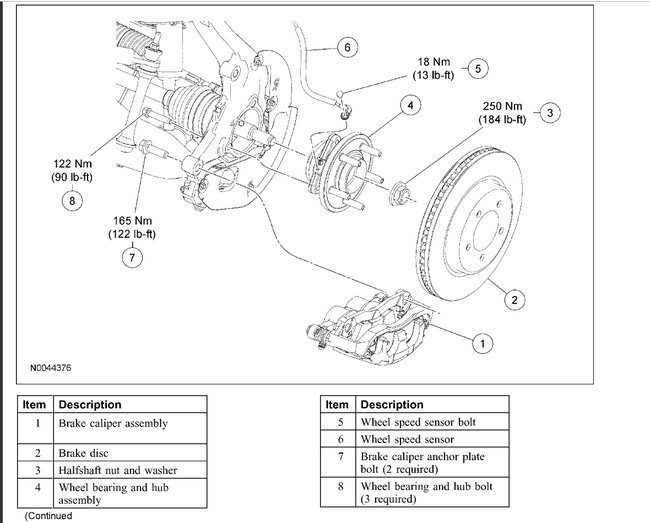

I just bought a 2006 Ford Explorer 4 wheel drive. On the way home the traction control light came on, then it started hesitating when I pressed on the gas peddle.
Feb 16, 2016 at 12:17 PM
  • 55,399 POSTS
It sounds like you have a front axle bearing that is going out which houses the ABS sensor. This will cause the ABS light to come on and the car to catch and hesitate.
Here is a guide to show you what you are in for when doing the job.
https://www.2carpros.com/articles/bearing-hub-replacement
Here is what it will be like for your car (below)
