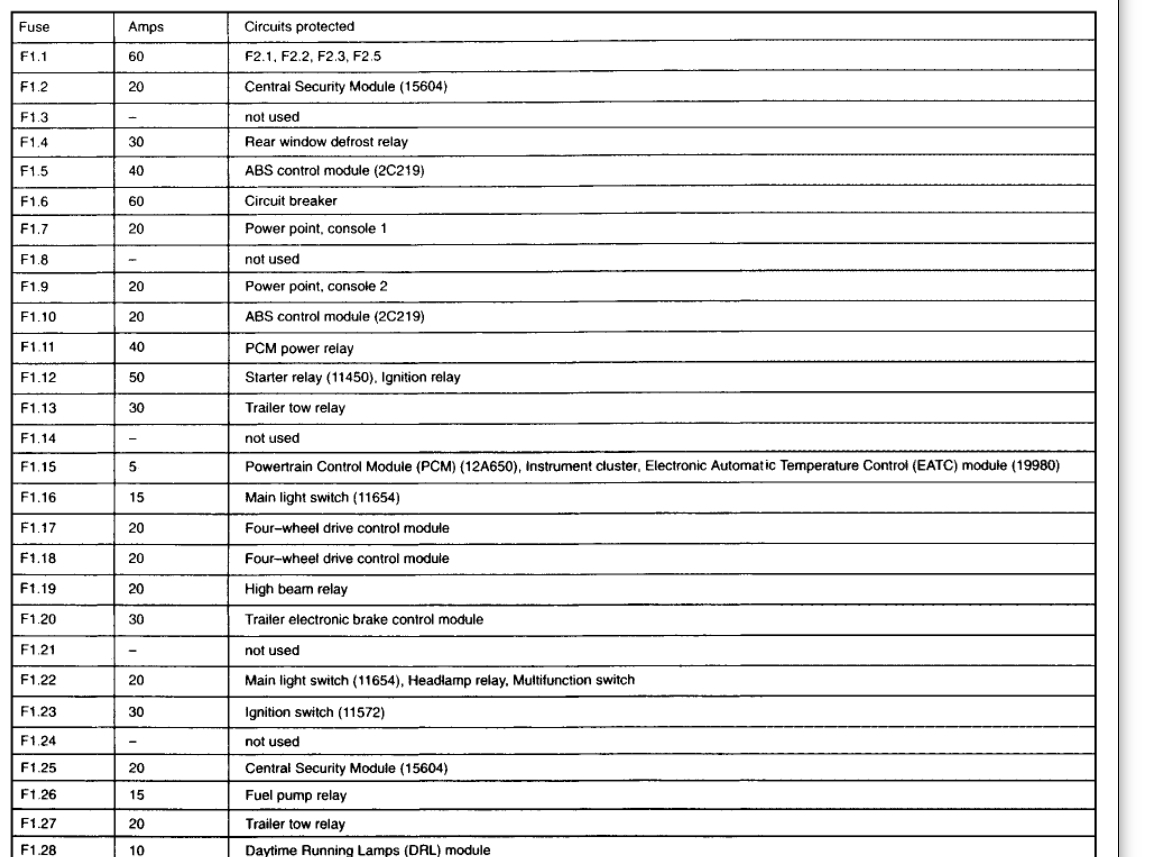

My power seat and adjustable pedals are not working. I think it might have been due to an 8 gauge wire grounding out on the drivers door that ran an amplifier. I checked the fuses and the fuses are fine. I also have the memory position that is not working since it controls both the pedals and seat. Do you think my problem resides in the memory switch. I dont think its the motor or the seat switch since the pedals and seat went out at the same time. Please help me know where to go with my problem now.
Feb 3, 2010 at 9:47 PM
RACEFAN966
  • 5,029 POSTS

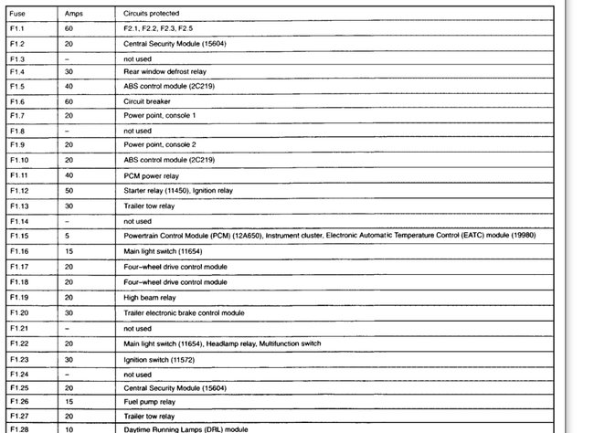

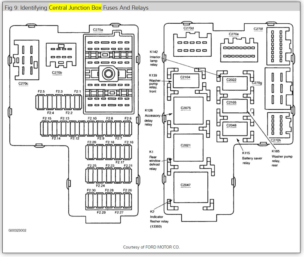

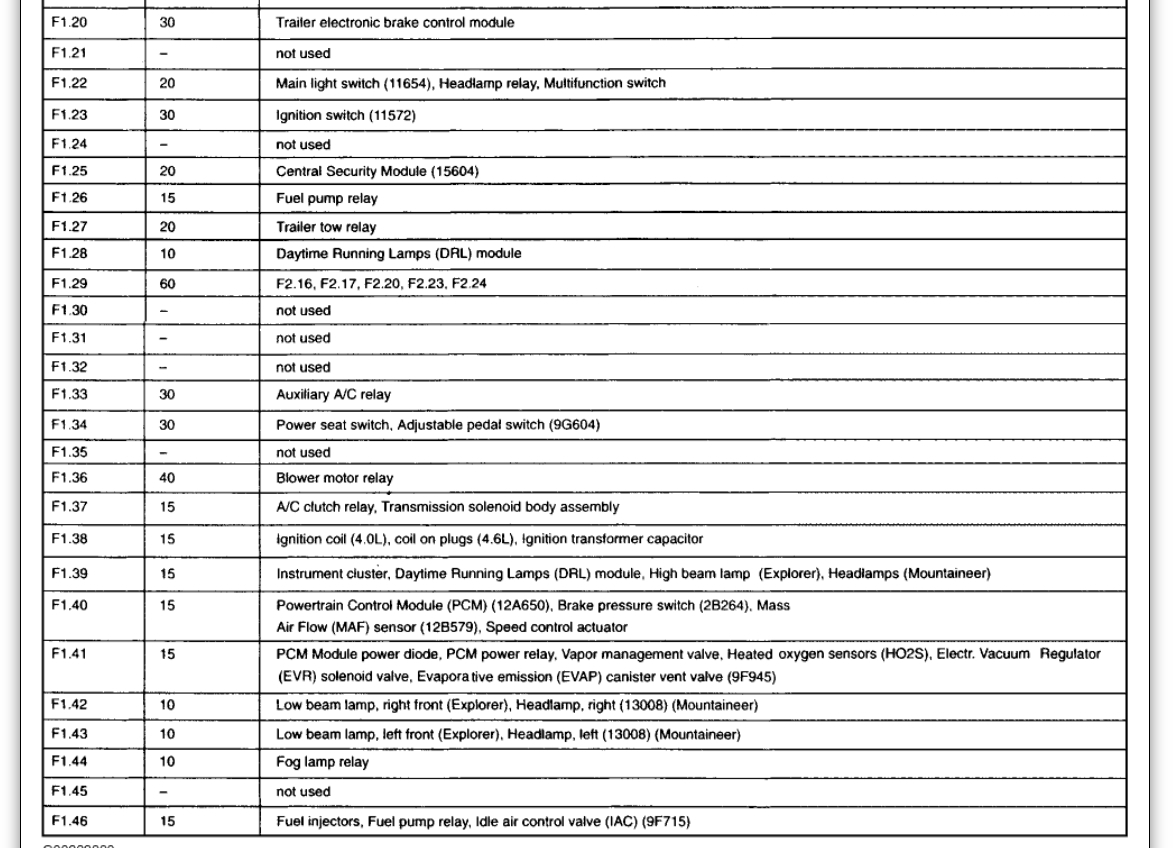

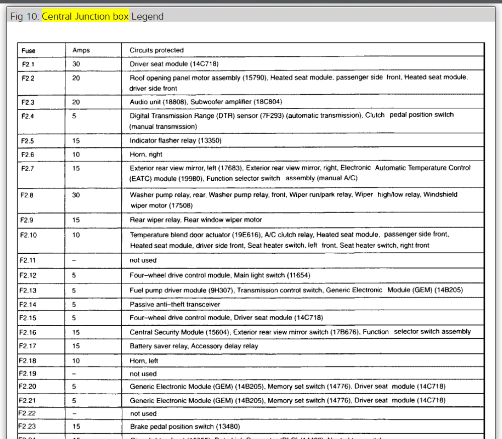

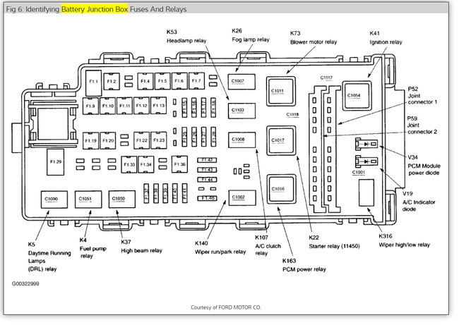

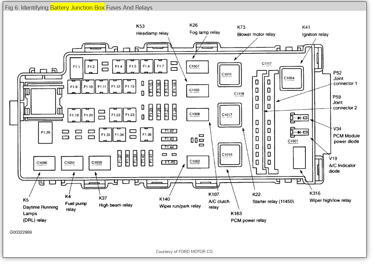

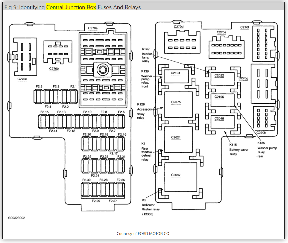

The drivers seat module in the drivers seat controls all this. I would first check fuse 1 30amp if this is good then make sure the module has power at the green wire. Also check the ground to the module it is located in the left rear of the car. Here are the fuse locations in the diagrams below with a guide to help you check them.
Feb 5, 2010 at 10:30 AM
SHMILY335
I checked the green wire and it had power. I checked the ground in the rear and it was grounded tight and secure. The module under the seat controls both the pedals and seat so does that mean I have to replace the entire module under the seat now? It also has a memory button on the door for seat positions. Could this make it so that both would not opperate?
Feb 6, 2010 at 11:49 AM
RACEFAN966
  • 5,029 POSTS
If you have power to the module it is most likely the module under the seat sorry.

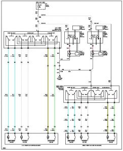

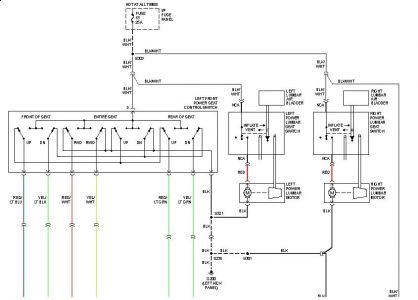

GRAGG56
Interior problem
1998 Ford Explorer 6 cyl Four Wheel Drive Automatic
Changing Drivers seat from standard to power. How to wire without burning it out?????
Aug 25, 2020 at 1:02 PM (Merged)
DAVE H

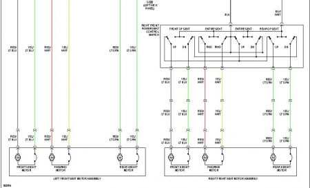

  • 13,384 POSTS
https://images.2carpros.com/forum/automotive_pictures/266999_exp_7.jpg
DAVE H
  • 13,384 POSTS
Hey. If you put you mouse cursor over the diagram, click the right mouse button, click on save picture as .. you can save the diagram to your computer and enlarge and scroll around it ! hope this helps
https://images.2carpros.com/forum/automotive_pictures/266999_AAA2_1094.png
DAVE H
  • 13,384 POSTS
https://images.2carpros.com/forum/automotive_pictures/266999_x1_1.jpg
https://images.2carpros.com/forum/automotive_pictures/266999_x2_1.jpg
