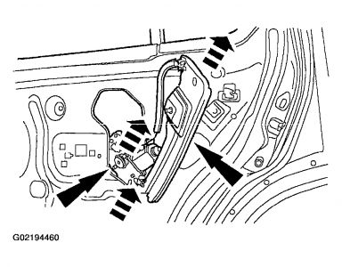

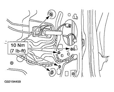

How do you change out the power window motor/regulator on 2002 explorer?
I have the door panel off, and wiring unpluged.

Disconnect the rear door window regulator and motor assembly from the door.
Remove the nuts.
Remove the screws.
Fig. 92: Disconnecting Rear Door Window Regulator And Motor Assembly From Door
Courtesy of FORD MOTOR CO.
https://www.2carpros.com/forum/automotive_pictures/266999_door_2.jpg
Remove the window regulator and motor assembly from the door.
Fig. 93: Removing Window Regulator And Motor Assembly From Door
https://www.2carpros.com/forum/automotive_pictures/266999_door_3.jpg
