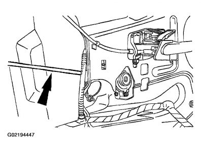

HOW is the window regulator replaced
Feb 18, 2009 at 1:09 AM
DAVE H
  • 13,383 POSTS
Front Door Window Regulator And Motor Removal and Installation Raise the front door window glass to the half-open position. Remove the front door trim panel. For additional information, Remove the inside glass weatherstrip. Remove the watershield. Disconnect the lock rod at the latch assembly. Fig. 80: Disconnecting Lock Rod At Latch Assembly

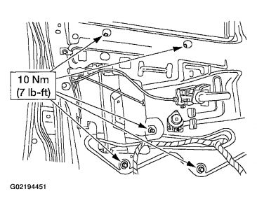

NOTE:Some vehicles may use rivets to attach the glass to the regulator. Remove the bolts that attach the glass to the regulator. NOTE:The window must be in the full up position for this step. Support the window glass. Disconnect the window motor electrical connector. Disconnect the regulator and motor assembly from the door frame. Fig. 84: Disconnecting Regulator And Motor Assembly From Door Frame
https://images.2carpros.com/forum/automotive_pictures/266999_84_2.jpg
Remove the regulator and motor assembly through the door opening. To install, reverse the removal procedure.
