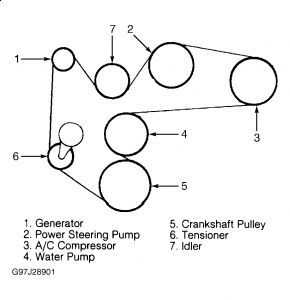

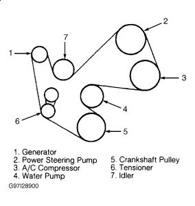

This is weird so when you start up wheel is not moving? touch it and back and forth it goes? until engine off? do tires move? can you hold wheel and keep it from moving? does your pump have resivor off to side or on back of pump? which belt routing do you have?
https://images.2carpros.com/forum/automotive_pictures/198357_Graphic_75.jpg
https://images.2carpros.com/forum/automotive_pictures/198357_Grafic_3_32.jpg
Aug 29, 2009 at 6:27 AM
EXPLORER2000
  • 19 POSTS
very weird . right now tires are off but knuckle and rotor move right along with steering wheel .
it is the second picture but the power steer pump and a/c compis switched around
i can hold steering wheel but actually hard to keep from moving .
pump res . on back of pump . pump part # 20-7271 from advanceauto parts . the local ford dealer told me to call ford and see what they have to say about it
