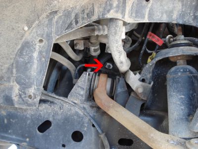

2000 Ford Explorer OIL GAGE
YILDIRAY
  • 2000 FORD EXPLORER
  • 6 CYL
  • 2WD
  • 150,000 MILES
When I started the car. Oil gage do not move.I am thinking I have oil sensor problem. When I drive couple miles it goes up. HOW I CAN CHANGE OIL SENSOR
Monday, December 7th, 2009 AT 1:48 PM
RICKMAR
  • 170 POSTS
Start by taking the drivers side tire off and remove the rubber splash guard inside the wheel well.
Look in from the wheel well. The red arrow indicates the oil sender right on the side of the engine block with the single white/green wire coming out of it.

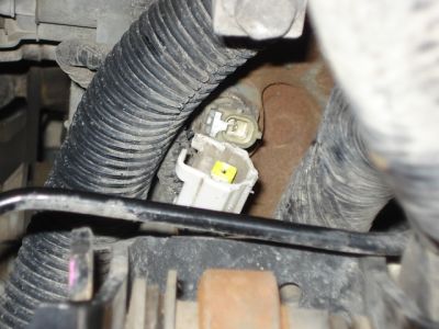

Unplug the connector.
https://www.2carpros.com/forum/automotive_pictures/433905_Drivers_side_wheel_well_1.jpg
Unplug and unscrew it using a deep socket.
https://www.2carpros.com/forum/automotive_pictures/433905_Oil_sender_unplug_1.jpg

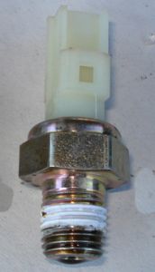

New oil sender
https://www.2carpros.com/forum/automotive_pictures/433905_Oil_Sender_1.jpg
Put a little plumbers "Teflon" pipe tape or silicone "High Temp." RTV on the threads before installing to prevent any oil leakage after installation.
