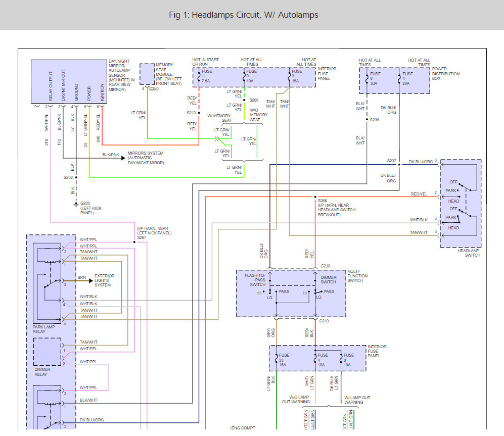

The problem started with the loss of the driver side low beam. Lamps, fuses, relays and every less ok. Then the loss of the other (right side) lamp. now we have only high beam lights. The combination switch is ok - turn lights - high beam - flash switch etc. Yes I have checked the lamps - there is NO POWER ! There is power for all the lights except the low beams. Yes I have checked very thing. The vehicle does not have DRL and/or if it does they do not work. The vehicle has auto lamp. Now WHAT?

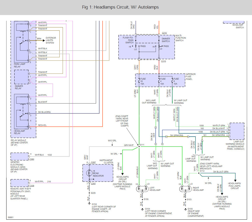

It sounds like you have a lamp out warning module that has gone out but to be sure here is a guide and some headlight wiring diagrams so we can confirm the problem.
Light Out Warning Module - In instrument panel console.

You guys are the best you nailed it. I remove the instrument cluster and I could see burnt connections I got a used unit and installed it worked like a charm. I love this site keep up the good work guys!
