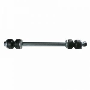

Have you looked under the vehicle to check if the say bar links are broken? Here is a picture of what they look like. There will be one on each side of the vehicle connected to the sway bar.
https://www.2carpros.com/forum/automotive_pictures/249084_5_66.jpg
If they look good, my first guess is the tracking arm bushings are bad.
Let me know what you find.

One of them was broken and I took it to a mechanic who told me thats not what the noise is coming from, that it was the front end drive shaft, so I had that replaced and the noise still continues. Any chance it could be the CV joint? I can feel it coming from pretty much right underneath my feet.

Honestly, it sounds like a tracking arm busing. Have they checked them?
