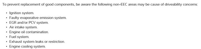

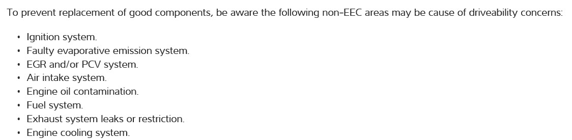

the 171 and 174 are lean codes so this can very possibly be a pump problem 153 is slow response which can also be effected by low fuel pump pressure.455 is an evaporator purge leak which should be smoke tested by a mechanic sometimes it is a solenoid on evap which is by the gas tank along frame 1131 and 51 are both O2 sensors indicating rich which on fuel pressure may be the regulator so a few of these codes may be checked by fuel pressure. in picture it shows area to check so it can be a vacuum leak like the evap canister and or broken hoses. also check all engine grommets and air duct to throttle body to make sure it has no holes/disconnected. see picture. also, if you have not changed oil and drive short distances all the time like under ten miles each way that can do it as well. see picture.
