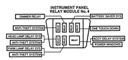

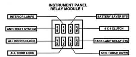

The battery saver relay is located in relay module behind center of dash. I have 2 diagrams here because I do not know which is installed in your vehicle.
https://www.2carpros.com/forum/automotive_pictures/192750_RelayModule96Explorer_1.jpg
https://www.2carpros.com/forum/automotive_pictures/192750_RelayModule96Explorer4_1.jpg
