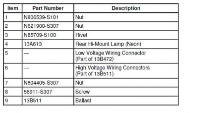

It shouldn't be this tough but. How does one get to the light bulb for replacement? Thanks

It's actually a neon lamp..you have to remove the rear hatch trim panel and then the remove the third brake light assembly to replace it..
