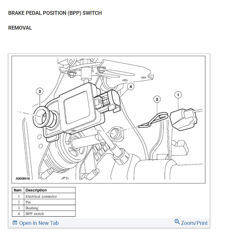

My brake lights wont go off. I disconnected the batttery last night but when I reconnected it this morning they came on again. They are stuck. What can I do?

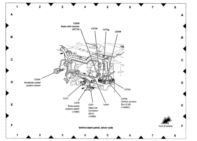

Above the brake pedal under the dash, you will see a switch with a 2-wire connector going to it. Disconnect that connector, and the brake lights should go out. If so, replace the switch, and that will return the brake lights to normal operation. Here are the instructions in the diagrams below to help you see how to change the brake light switch out to fix the problem. Check out the diagrams (Below). Please let us know if you need anything else to get the problem fixed.

Thank you that fixed it the site rocks.
