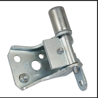

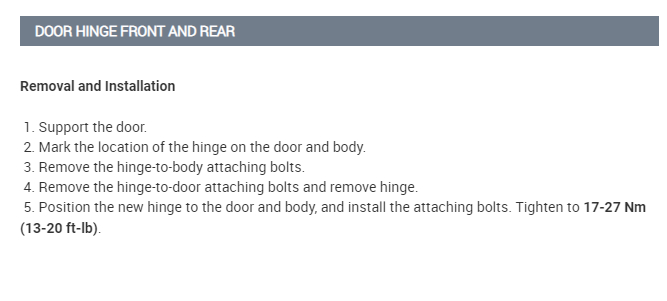

How difficult is it to replace the drivers side front door hinge
Mar 17, 2010 at 8:06 PM
This is not a difficult task at all. Basically, you want to support the door with a floor jack and block of wood just so it doesn't drop when you loosen the hinge.
Here is a guide that will help with using a floor jack in case you need this info:
Lastly, I am attaching the process from the manual and a picture of the hinge which will show which bolts to remove.
Please run through this info and let us know what questions you have.
