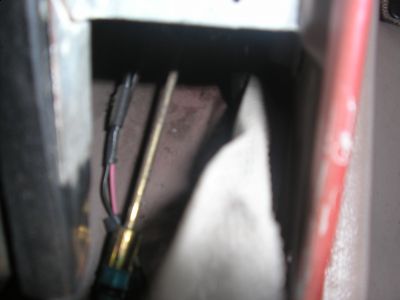

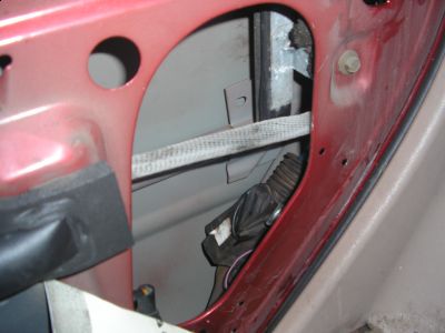

It's hard for me to picture what you are dealing with. Is it possible for you to take a picture and upload it for me to see?

https://images.2carpros.com/forum/automotive_pictures/391066_P1010148_1.jpg
https://images.2carpros.com/forum/automotive_pictures/391066_P1010147_1.jpg
Here are two pictures. I hope this helps. Thanks!
Aug 3, 2009 at 4:23 PM
  • 110,194 POSTS
Can you unbolt the lock mech?

I don't think I can because I think it is attached to the latch and the bolts for the latch are on the inside jam of the door, so I can't get to the until I get the door open. The door doesn't have a key lock. So I think it is all one piece. Thanks!
