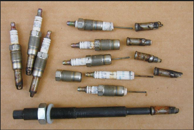

During replacement of spark plugs, I found all spark plugs are broken in head , mechanic advise to open the engine, please suggest
May 16, 2009 at 2:57 AM
  • 110,194 POSTS
What part is broken? If it is the white part, chances are you broke them when trying to remove them. THat would not justify removing the cylinder head, and the car wouldn't have run prior to replacement. If the steel part the is threaded and bolts to the head is stripped, then the head will need removed to repair the problem. But again, the car wouldn't have been running prior to this.

Yes, the plugs commonly break off because the upper and lower parts of the plug are only connected by glass.
There is a tool made for removing the broken piece.

Trying to change spark plugs and the base is stuck in side
How can I remove this part the new plug on left in pic and the one
I removed that broke on right. Can you tell me how to remove this at my home
Without spending any more money. I bought motorcraft spark
Today and tried to change them the first broke on me.
I'm the only owner of this 2007 bought new and it started to act like it wanted
To die when I came to a stop so I purchased
Plugs and a fuel filter.
Jan 5, 2020 at 1:53 PM (Merged)
DOCFIXIT
  • 18,828 POSTS
Wish had good news but Mr. FORD kinda screwed up on that engine. The plug reach is very long and extends into combustion chamber thus threads become coated with carbon. Which results in broken plugs. A TSB was published on proceedure to remove plugs 1/4 to 1/2 turn spray Motocraft cleaner around plug screw back repeat,repeat,repeat till comes out or brakes. Bummer is need special tools /Tap to remove broken plug.I do not think tools are available from anyone but Ford tool maker rotunda. Short of pulling head and taking to machine shop or seeing if Ford dealer will loan tools ......
