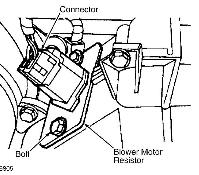

Where is the blower motor resistor located?

Hi:
What I was able to find for you was both the resister and the relay. The relay is in the centrial junction box. Here is a picture:
https://www.2carpros.com/forum/automotive_pictures/249084_relay_1.jpg
I don't know how well you can see it, but the fan relay is the one on the bottom right.
Now the resister is another story. It appears to be located on the firewall from what I can tell (aprox center) but the schematic I found is hard to read. I hope it's helpful.
Here is a picture:
https://www.2carpros.com/forum/automotive_pictures/249084_resister_1.jpg
Let me know if this helps. If you can't blow it up enough to read, let me know and I'll try to figure something out for you.

My ac only blows on high and I was told it was probably the resistor. I am trying to replace the resistor on my ac. I know it is behind my glove box but don't know how to get to it. I have removed 3 screws; two from inside the glove box and 1 from underneath but that is all I could see. How many screws are there?
Wednesday, January 13th, 2021 AT 5:29 PM (Merged)
HMAC300
  • 48,601 POSTS
Check all glove box for all screws you may have to squeeze glove box to get it out or if connected to door push down to get it to drop. Then get resistor
