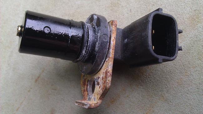

I just had this same exact problem with my 95 escort the solution is simble but a pain in the butt
Douse the oem or the aluminum left with pb blaster
go under the car on the back of the sencor it sticks out about one centimeter use a good sharp chisel and a hamer put the chisel right under the lip and smack it hard may have to do it a few times but it should pop loose
hope this helps it took me two days to find a good spot to get it out from

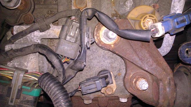

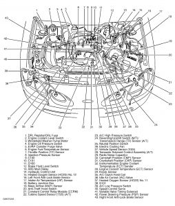

OBXAUTOMEDIC
  • 3,718 POSTS
Hello, The only sensor you have not changed that is the most likely cause is the Turbine Speed Sensor. I cannot find a good diagram that show exactly were it is located. But here is a diagram that will give you a good idea. In the diagram it is labeled #22.
https://images.2carpros.com/forum/automotive_pictures/188069_99exscortzx2turbspeedsensr_1.jpg
press CTRL + to zoom in... .

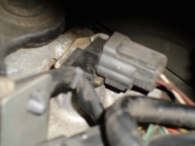

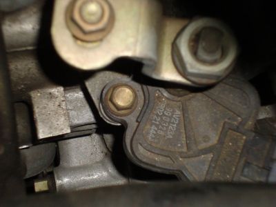

OZZX2
  • 7 POSTS
I took these pictures from the location of your diagram. Are one of these the turbine/input speed sensor?
https://images.2carpros.com/forum/automotive_pictures/554052_ZX23_1.jpg
https://images.2carpros.com/forum/automotive_pictures/554052_ZX22_1.jpg
https://images.2carpros.com/forum/automotive_pictures/554052_ZX21_2.jpg
Jul 26, 2020 at 3:55 AM (Merged)
OBXAUTOMEDIC
  • 3,718 POSTS
I am sorry for delay in getting back been very busy.
Anyway, I believe it is the top picture.
The bottom picture is the transmission range selector switch.
Not sure about the center picture.

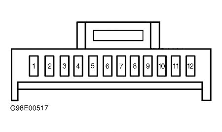

Do you have a wiring diagram for the instrument cluster?

OZZX2
  • 7 POSTS

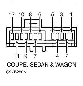

Finally! This is the correct wiring diagram for my instrument cluster. Thanks. The one in my Haynes Manual does not match. Neither did the one from the ARRC database (or any I have found online).
The voltage at the instrument cluster for the VSS is showing 8.5 volts. Is this correct?

OBXAUTOMEDIC
  • 3,718 POSTS
I found this. Not sure it will help. Have not been able to find volts for the VSS at the cluster, but shows Ohms in tests below. TEST D: SPEEDOMETER/ODOMETER INACCURATE Coupe 1.Turn ignition off. Connect scan tool and retrieve Diagnostic Trouble Codes (DTC) following manufacturer's instructions. If no DTCs are present, go to next step. If DTCs are present, see appropriate SELF-DIAGNOSTICS article in ENGINE PERFORMANCE. Repair DTCs as necessary, then retest system. 2.Using scan tool, observe Vehicle Speed Sensor (VSS) output Parameter Identification (PID) while assistant drives vehicle over range of speeds on various road surfaces. If VSS PID varies smoothly with vehicle speed, go to next step. If VSS PID does not vary or is erratic, see appropriate SELF-DIAGNOSTICS article in ENGINE PERFORMANCE to diagnose VSS. 3.Remove and check OBDII 10-amp fuse in engine compartment fuse box. If fuse is okay, reinstall fuse and go to step 5 . If fuse is blown, go to next step. 4.Turn ignition off. Remove instrument cluster. See INSTRUMENT CLUSTER under REMOVAL & INSTALLATION. Disconnect all instrument cluster electrical connectors. Measure resistance between ground and instrument cluster harness connector C253 terminal No. 1 (Green wire). See Fig. 7 . Resistance should be more than 10 k/ohms. If resistance is more than 10 k/ohms, replace OBDII 10-amp fuse and go to next step. If resistance is less than 10 k/ohms, repair short to ground Green wire between instrument cluster harness connector and fuse. See WIRING DIAGRAMS . 5.Turn ignition off. Remove instrument cluster. See INSTRUMENT CLUSTER under REMOVAL & INSTALLATION. Disconnect instrument cluster electrical connectors. Measure voltage between ground and instrument cluster harness connector C253 terminal No. 1 (Green wire). See Fig. 7 . Voltage should be more than 10 volts. If voltage is more than 10 volts, go to next step. If voltage is less than 10 volts, repair short to voltage in Green wire between instrument cluster harness connector and fuse. See WIRING DIAGRAMS . 6.Turn ignition off. Disconnect Vehicle Speed Sensor (VSS) harness connector C132. Measure resistance of Blue wire between VSS harness connector and instrument cluster harness connector C252 terminal No. 11. See Fig. 6 . Measure resistance of White/Black wire between VSS harness connector C132 and instrument cluster harness connector C252 terminal No. 1. Resistance in both tests should be less than 5 ohms. If resistances are as specified, go to next step. If resistances are not as specified, repair open in White/Black or Blue wire. See WIRING DIAGRAMS . 7.Measure resistance between ground and instrument cluster harness connector C252 terminal No. 1 (White/Black wire). Measured resistance should be more than 10 k/ohms. If resistance is more than 10 k/ohms, go to next step. If resistance is less than 10 k/ohms, repair short to ground in White/Black wire. 8.Turn ignition on. Measure voltage between ground and instrument cluster harness connector C252 terminal No. 12 (Black/Yellow wire). See Fig. 6 . Voltage should be more than 10 volts. If voltage is more than 10 volts, go to next step. If voltage is less than 10 volts, repair short to voltage in Black/Yellow wire between instrument cluster connector and fuse. See WIRING DIAGRAMS . 9.Turn ignition off. Visually inspect instrument cluster printed circuit for damage, cracks or hot spots. If instrument cluster printed circuit is okay, replace speedometer. If instrument cluster printed circuit is damaged, replace printed circuit and gauge contact clips. Sedan & Wagon 1.Turn ignition off. Connect scan tool and retrieve Diagnostic Trouble Codes (DTC) following manufacturer's instructions. If no DTCs are present, go to next step. If DTCs are present, see appropriate SELF-DIAGNOSTICS article in ENGINE PERFORMANCE. Repair DTCs as necessary, then retest system. 2.Using scan tool, observe Vehicle Speed Sensor (VSS) output Parameter Identification (PID) while assistant drives vehicle over range of speeds on various road surfaces. If VSS PID varies smoothly with vehicle speed, go to next step. If VSS PID does not vary or is erratic, see appropriate SELF-DIAGNOSTICS article in ENGINE PERFORMANCE to diagnose VSS. 3.Remove and check OBDII 10-amp fuse in engine compartment fuse box. If fuse is okay, reinstall fuse and go to step 5 . If fuse is blown, go to next step. 4.Turn ignition off. Remove instrument cluster. See INSTRUMENT CLUSTER under REMOVAL & INSTALLATION. Disconnect all instrument cluster electrical connectors. Measure resistance between ground and instrument cluster harness connector C252 terminal No. 12 (Green wire). See Fig. 6 . Measured resistance should be more than 10 k/ohms. If resistance is more than 10 k/ohms, replace OBDII 10-amp fuse and go to next step. If resistance is less than 10 k/ohms, repair short to ground in Green wire between instrument cluster harness connector and fuse. See WIRING DIAGRAMS . 5.Turn ignition off. Remove instrument cluster. See INSTRUMENT CLUSTER under REMOVAL & INSTALLATION. Disconnect instrument cluster electrical connectors. Measure voltage between ground and instrument cluster harness connector C252 terminal No. 12 (Green wire). See Fig. 6 . Voltage should be more than 10 volts. If voltage is more than 10 volts, go to next step. If voltage is less than 10 volts, repair short to voltage in Green wire between instrument cluster harness connector and fuse. See WIRING DIAGRAMS . 6.Turn ignition off. Disconnect Vehicle Speed Sensor (VSS) harness connector C132. Measure resistance of Blue wire between VSS harness connector and instrument cluster harness connector C252 terminal No. 7. See Fig. 6 . Measure resistance of White/Black wire between VSS harness connector C132 and instrument cluster harness connector C253 terminal No. 9. Resistance in both tests should be less than 5 ohms. If resistances are as specified, go to next step. If resistances are not as specified, repair open in White/Black or Blue wire. See WIRING DIAGRAMS . 7.Measure resistance between ground and instrument cluster harness connector C253 terminal No. 9 (White/Black wire). Resistance should be more than 10 k/ohms. If measured resistance is more than 10 k/ohms, go to next step. If resistance is less than 10 k/ohms, repair short to ground in White/Black wire. 8.Turn ignition on. Measure voltage between ground and instrument cluster harness connector C252 terminals No. 8 and 4 (Black/Yellow wire). See Fig. 6 . Voltage should be more than 10 volts. If voltage is more than 10 volts, go to next step. If voltage is less than 10 volts, repair short to voltage in Black/Yellow wire between instrument cluster connector and fuse. See WIRING DIAGRAMS . 9.Turn ignition off. Visually inspect instrument cluster printed circuit for damage, cracks or hot spots. If instrument cluster printed circuit is okay, replace speedometer. If instrument cluster printed circuit is damaged, replace printed circuit and gauge contact clips. Fig 6
https://images.2carpros.com/forum/automotive_pictures/188069_99escortzx2clstrc252_1.jpg
Fig 7
https://images.2carpros.com/forum/automotive_pictures/188069_99escortzx2clstrc253_7_1.jpg

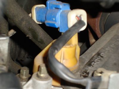

SASSEYBOO
1998 ford escort 4door sdn , speedometer works sometimes, believe it may be speed sensor, unable to locate on vehicle. can you help? thanks
  • 75,988 POSTS
[quote:b98086f250="sasseyboo"]1998 ford escort 4door sdn , speedometer works sometimes, believe it may be speed sensor, unable to locate on vehicle. can you help? thanks[/quote:b98086f250]
Located at lower rear of the transaxle

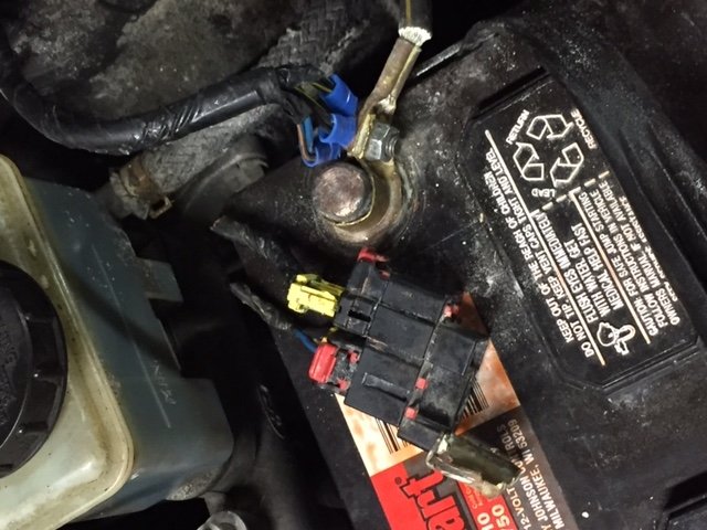

My Fix 7-2018:
Speedometer goes to 0- zero - when I try to set the cruise control.
This only applies if you do not have a DTC (code) and the service engine soon soon light is not on. If a code specifically the VSS P0500 is present it may be the vehicle speed sensor and this is not relevant. However, this fix is is only a couple of dollars verses more than $50.00for a new VSS sensor, so it may be worth trying first.
Check and clean the ground block attached to negative terminal on battery. I had severe corrosion on the wires (not just the terminal) that attached to the negative terminal (1999 Ford Escort ZX2). I cut the wires, reattached with a ring terminal to the negative battery terminal and it fixed my speedometer and speed control/cruise issues. Still works great a month later.
The attached picture shows how I cut-off the ground block and used ring terminals to attach the ground wires back to the negative battery terminal.

car sat for 3 years and speedo was working then if you could help locate the sensor maybe it has bad connettion
MUSTANG87
  • 261 POSTS
the speed sensor is on the transmission . just look around to spot it .its black bout 2 inches long with a wire connection to it. go here to see a pic of it .www.kragen.com you should first just clean out the connectors may have dirt and corrosion u might not need a new one.if the speed sensor is not the prob u may have a bad speed cluster.its a bit odd that it was working before and sat for some time then stopped.also posibly u just need to drive car like that for a while till it un sticks ,the needle.posible just sticky.god luck

I removed and checked the connectors at the battery's negative terminal. The plastic connectors look fine; not brittle; still have a little bit of that clear gel that I assume Ford puts on them to keep the metal clean.
But I suspect a wiring problem.

There are a few connectors atop the transmission. I worked on the only connector with two wires. Held on with one 10 mm bolt.
The connector/harnesses terminals look fine. The two wires do not look brittle or frayed. They feel solid in the connector.
Resistance across the two male prongs on the speed sensor is 399 Ohms while bolted on the trans. Measures 386 Ohms when removed.
I'm amazed how easy it was to remove. After removing the one bolt, I lifted out the sensor immediately--not even a twist required.
Turns out, there seem to be two types of speed sensors listed for Ford Escort 2.0L SPI engines (including for my 1998). One is longer, with a gear that sits down in the trans, and the electrical connector sticks straight upward. The other type (mine) is short, has a copper pulse sensor instead of a gear, and the electrical connector sticks out to the side--at a right angle (photo attached).
Autozone and other parts stores show only the longer sensor with the gear. But, some parts suppliers show the sensor without the gear, listed (for example, at TascaParts) as part # F32Z-7F040-A "Speed Pulse Generator." It's about 107 bucks, instead of 70 for the one with the gear. I'm tempted to pull one from the local salvage yard.

I think I made a mistake. That's the turbine shaft speed sensor--the photo in my previous post.
The photo below is looking down. Front of car is to the left. The turbine shaft speed sensor is the gray connector at the photo's bottom center.
Which is the VSS? Am I looking in the wrong place?

I found the VSS, behind the engine, 18 inches below the hood, roughly centered between driver & passenger. The connector's and harness' terminals look fine, and are not brittle or frayed, and feel solid in their connectors.
The resistance across the two male prongs on the VSS is 218 Ohms.
(while unplugged from the wiring harness)
What is that resistance supposed to be?
