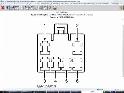

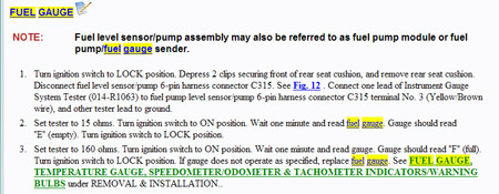

MERLIN2021
  • 17,250 POSTS
To test it, you need a tester that can produce resistance, or two resistors of the values shown.
https://images.2carpros.com/forum/automotive_pictures/62217_FGa_1.jpg
https://images.2carpros.com/forum/automotive_pictures/62217_FGb_1.jpg
