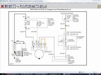

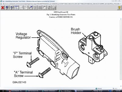

have a bosch alternator to refit.
but forgot what wires go where on the alternator?

Hope this helps...
