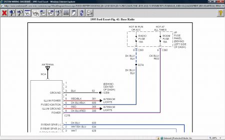

1995 Ford Escort
How do you install a stereo to the Ford?? I can't understand Why there are five wires coming from the ford and it only takes three to trun it on. We KNOW the CD plsyer itself is good. It worked in a GEo Tracker but not the ford. Can you please tell me why?????
Jul 14, 2008 at 2:41 PM
MERLIN2021
  • CAR REPAIR CONTRIBUTOR
  • 17,250 POSTS

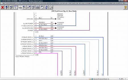

arkBlu/Blak is to the ACC side of the ignition and shuts the radio off when the key is turned, Dark blu/red goes to constant power, for the memory. Here are the diagrams.
