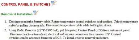

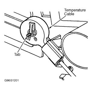

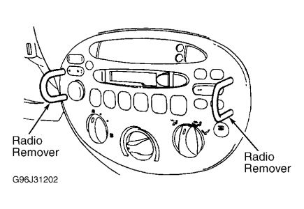

I want to put in a aftermarket radio. I have a used heater control plate to install the new stereo. my problem is I'm not sure how to get the old stereo out. something seems to be holding it in. I believe its the two heater controls on the left and center. not sure how they come off the center(temp setting)control has a cable going to it and the stereo doesnt come out enough to get a good look at.

https://images.2carpros.com/forum/automotive_pictures/261618_Noname_1629.jpg
https://images.2carpros.com/forum/automotive_pictures/261618_Graphic_324.jpg
https://images.2carpros.com/forum/automotive_pictures/261618_Graphic2_48.jpg
