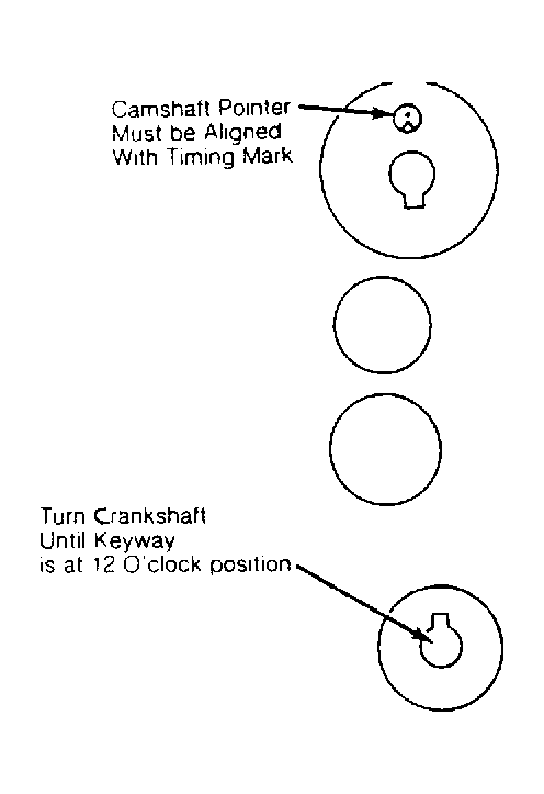

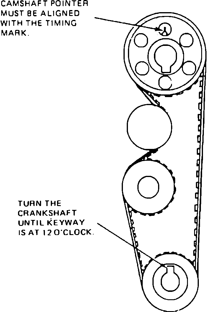

Would the timeing mark also be on top dead center on crank
Monday, September 28th, 2020 AT 10:53 AM (Merged)
DOCFIXIT
  • 18,828 POSTS
Crank shaft key is up cyl #1 TDC
MSELL61
I replaced the timeing belt 1 month ago and yesterday it sputerd right before I shut it off now it has a miss and a constant ticking noise sounds like its the #1 cylender its been runing like a top till now

Regardless, there is a timing belt tensioner but not an automatic one. Here are the directions for removal and replacement of the belt. The attached pics correlate with the directions. It wouldn't hurt to check to make sure everything is together properly.

Fig. 9 Aligning Camshaft To Cylinder Head Timing Marks
See Pic 1
1. Disconnect battery ground cable, then remove accessory drive belts.
2. Remove timing cover. Align timing mark on camshaft sprocket with timing mark on cylinder head. Fig. 7
3. Install timing belt cover, then ensure timing mark on crankshaft pulley aligns with TDC mark on front cover.
4. Remove timing belt cover.
5. Loosen both timing tensioner attaching bolts using torque wrench adapter T81P-6254-A or equivalent.
6. Pry tensioner away from belt as far as possible, then tighten one attaching bolt.
7. Remove crankshaft pulley, then the timing belt. Discard timing belt if damaged.
8. Install timing belt over sprockets in a counterclockwise direction starting at crankshaft. Ensure belt span between crankshaft and camshaft is kept tight as belt is installed over remaining sprocket.
9. Loosen belt tensioner attaching bolt and allow to locate against belt.
10. Tighten one tensioner attaching bolt using previously mentioned tool, then install crankshaft pulley, drive plate and pulley attaching bolt.
11. Retain crankshaft pulley using tool No. YA-826, then torque pulley nut to 74-90 ft. Lbs.
12. To seat timing belt on sprocket teeth, proceed as follows:
a. Connect battery ground cable, then crank engine for approximately 30 seconds.
B. Disconnect battery ground cable, then rotate crankshaft as necessary to align timing pointer on cam sprocket with timing mark on cylinder head.
C. Position timing belt cover on engine, then ensure timing mark on crankshaft aligns with TDC pointer on cover.
D. If timing marks do not align, remove belt, align timing marks and repeat steps 8---12.
