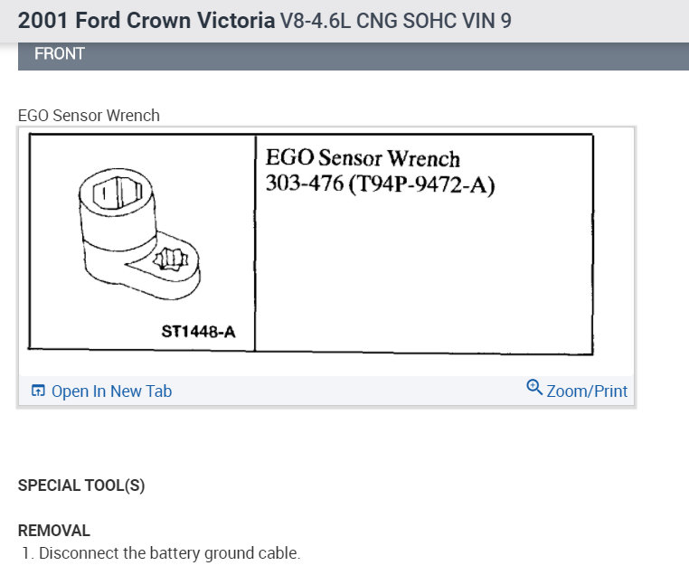

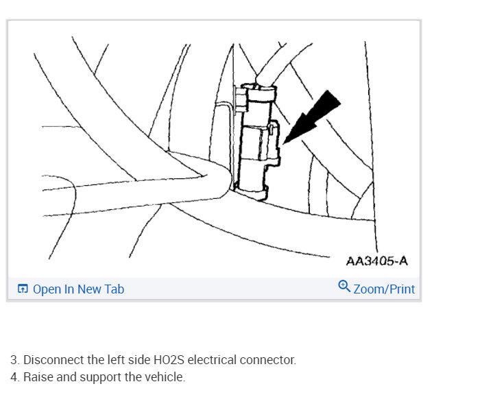

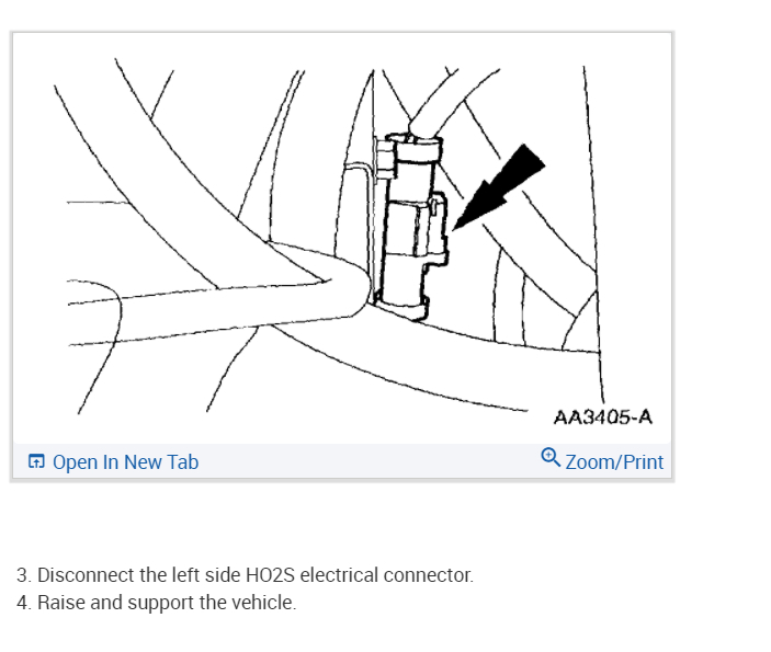

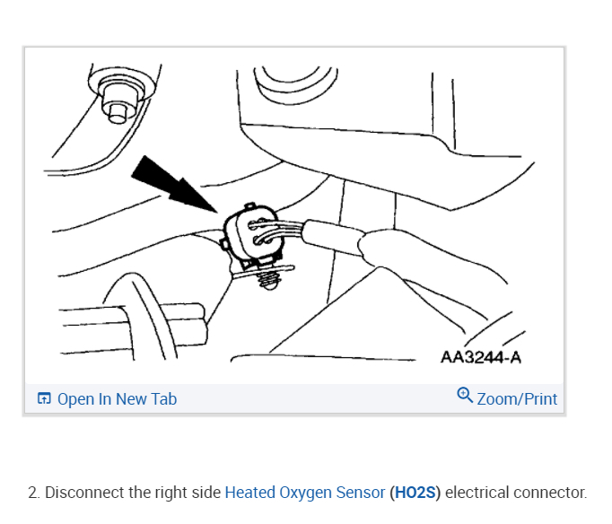

I need to find out where the o2 sensor is in the car so i can replace it. the computer code said that bank 1 sensor 1 was bad
Please help! Steve
Dec 29, 2008 at 4:33 AM
DAVE H
  • 13,384 POSTS

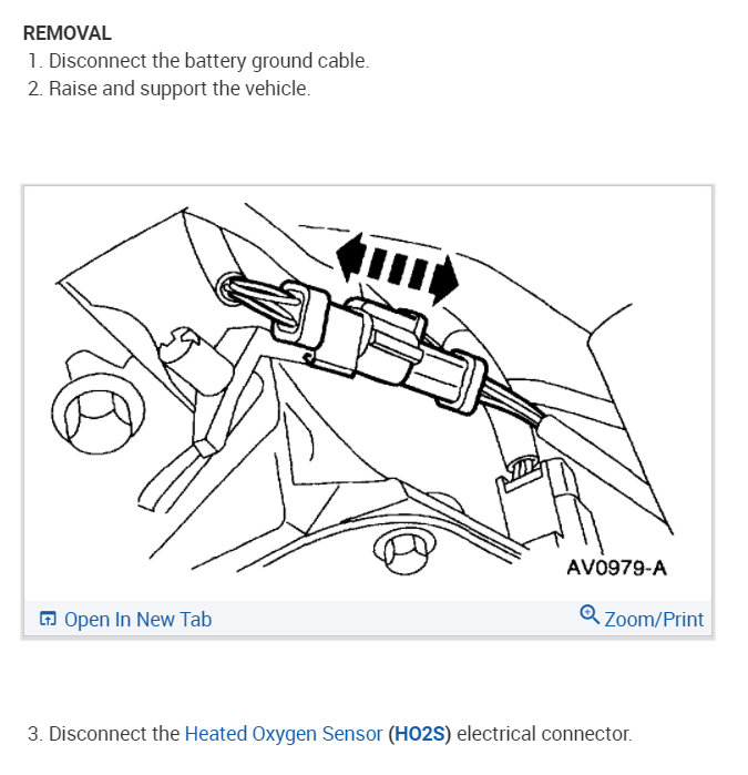

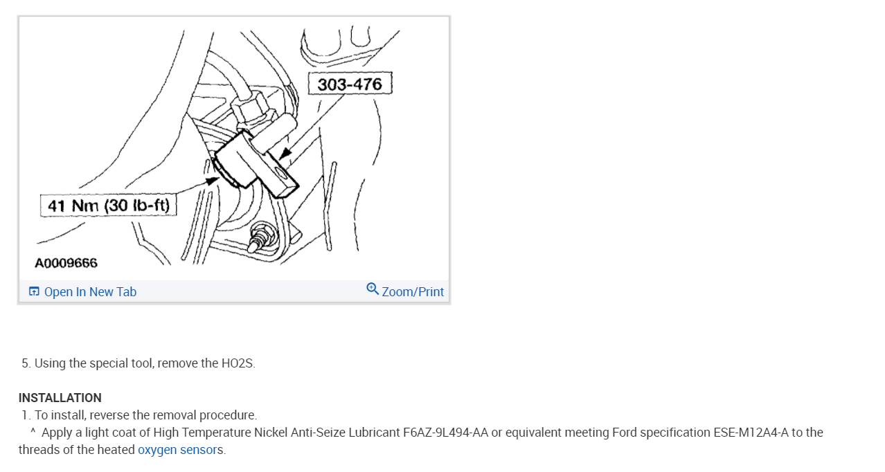

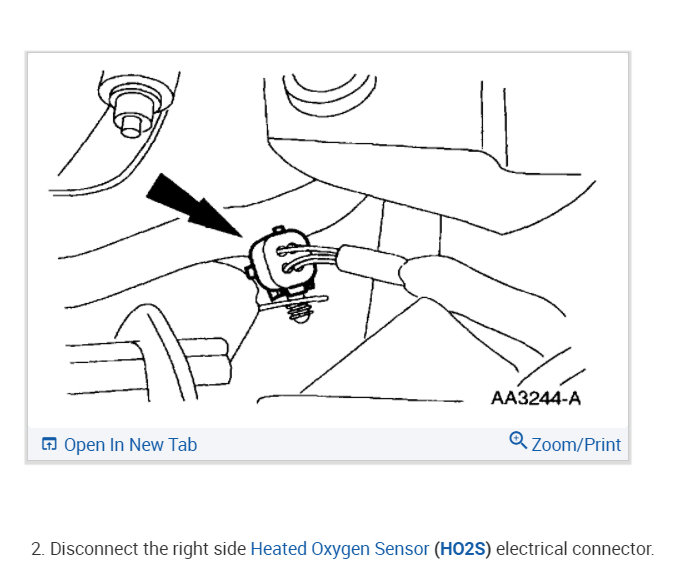

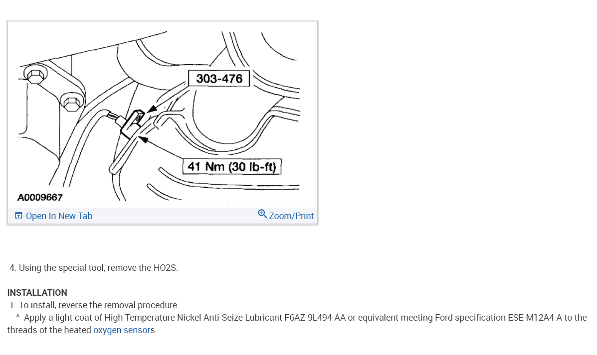

Here is a guide to help you step by step with instructions in the diagrams below to show you how on your car.
https://www.2carpros.com/articles/how-to-replace-an-oxygen-sensor
Heated Oxygen Sensor No. 11 (Right)Lower right rear of engine, in exhaust manifold.
Heated Oxygen Sensor No. 12 (Right)In exhaust, rear of catalyst.
Heated Oxygen Sensor No. 21 (Left)Lower left rear of engine, in exhaust manifold.
Heated Oxygen Sensor No. 22 (Left)In exhaust, rear of catalyst.

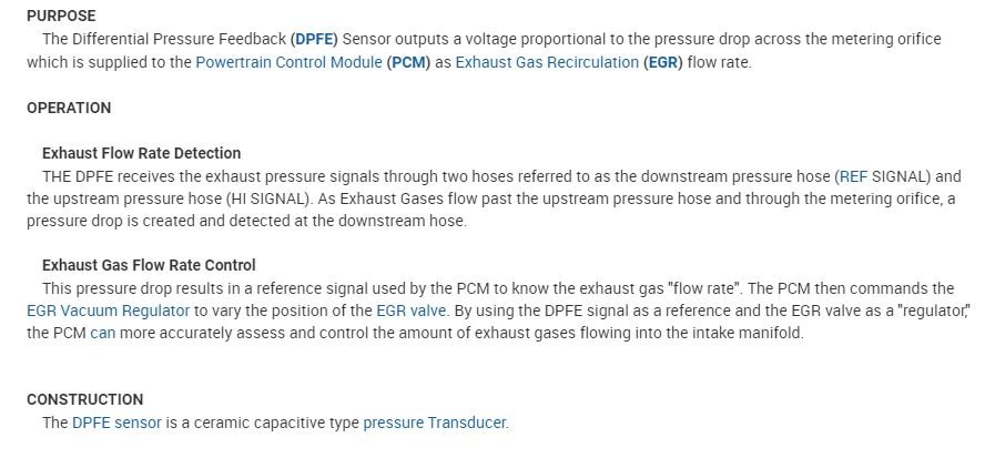

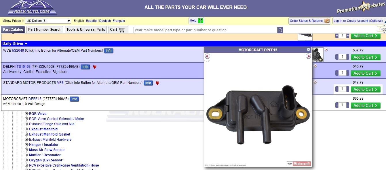

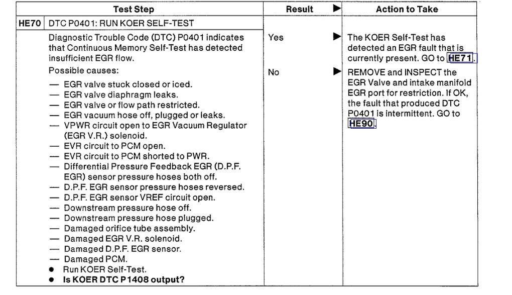

PRIDESEAN8

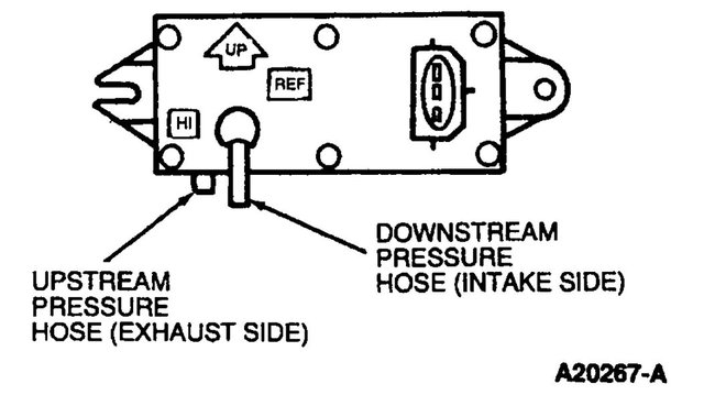

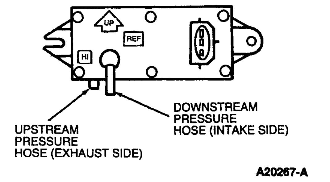

The engine light was on, so I put a ob2 reader on it and said p1401 as a code. So I replaced EGR valve and I reset engine. And light came back on again so I put computer back on said o2 sensor were low voltage. So I replaced all 4 o2 sensors. I reset again this time engine light stays off ran it for 1 hour light was still off. So when I started next time engine light comes back on. I need to smog it but worried about not passing. Can someone please explain why?
Aug 15, 2020 at 3:43 AM (Merged)
Good afternoon,
Can you list all the codes for me?
The 401 code is a bad DPFE sensor. I attached a picture for you and a description.
