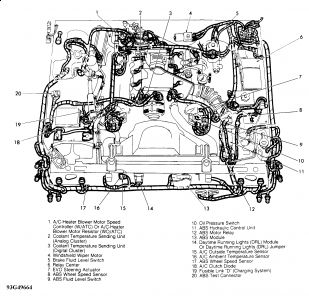

Okay, we have no oil pressure, the car has died on me but did restart. Motor still sounds fine. We dont hear anythin unusual? We have been told so many things. Im hoping and praying this is it. Where is the oil pressure sending unit located. How hard to change out? Anything specific needed to be known for this....

Weather the stalling is related or not is yet to be determined, but the oil pressure switch is worth replacing first. Ideally removing it and checking it with a gauge would be the best way to check it, but for the $20, I'd replace it. There are 2 different options depending on if you have a electronic instrument cluster or analog. Buy it first so you see what is looks like and have the right size socket to remove it. It is on the lower driver's side above the oil filter. Sometimes pulling the filter off helps.
https://images.2carpros.com/forum/automotive_pictures/30961_cv_2.jpg
https://images.2carpros.com/forum/automotive_pictures/30961_cv_3.jpg
If there is still no pressure, need you to check the actual pressure with an auxilliary gauge.
