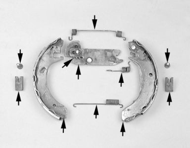

I replaced the both wheel cylinders and brake shoes. After going through hell of replacing the shoes with the almost impossible hardware to work with. I can't seem to get the shoes to compress enough to slide the drum back on. That (stupid design) of a brake aduster won't seem to allow enough space for the drum.
I even tried diconnecting the emergency cable to see if it was causing it. But nope.
All I can think is the problem is that d@#$ adjuster.
I matched the old shoes with the new ones at the auto store and the wheel clynders.
PLEASE, Any insight on the problem or tips? I need to get it back on the road. I'm currently driving my other car that isn't legal for the road but have to get to work.

You have to get the adjuster to colapse. Once removed you need to twist the screw all the way in then you should be able to get the drum on. Now as far as adjusting them from there set and release the parking brake or use a brake spoon and adjust to very light drag.

I appreciate the advice. but this doesn't have the standard wratchet type adjuster. It's one I never seen before. Operates on a spring and a type of swivel. I can retrac it from behind with a small screwdriver. It also seems to have a small bit of play. But I can't get the shoes to compact enough to slide the drum. I replaced lots of drum brake shoes but not like this.

Can you include a good pic of the adjuster? I looked and they don't seem to sell it at any parts stores so I am having a hard time trying to explain when I am blind as to what the adjuster looks like.

Found one. It's between the shoes (og course).
https://images.2carpros.com/forum/automotive_pictures/256611_0900823d801bd877_3.jpg

Ok I see it is mazda style. These are kind of a pain anyway if you look at the side that adjusts it is like a ratcheting divice. You use a screw drive and pry ightly and get it to rachted up like it is before you put it back in place so that way the shoe will goe all the way into the notch. This style readjusts by using the ebrake once the drum is on. Hope this helps

I GOT IT!! It took alot of tweeking (and a few choice words) but it's on and working. Thank you again for your support.
