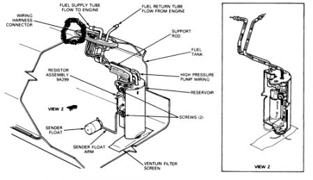

Stopped running in the middle of a turn. Now I do not hear the buzzing that is normally present with the key in the ON position which is usually the fuel pump or the pump relay. I replaced the pump about 3 years ago and it has less than 15k miles on it. Can this be the pump or the relay? How can I tell which one it is without replacing one or the other first?

No buzzing noise does not mean the fuel pump is dead.
If there is power at the wiring harness connector and the pump does not buzz, the pump must be replaced, make sure the tank is clean.
https://www.2carpros.com/forum/automotive_pictures/46384_0900c1528003c537_2.jpg
if there is no power at the pump and the relay appear to be good,the wire must be open between the relay and fuel pump connector.
