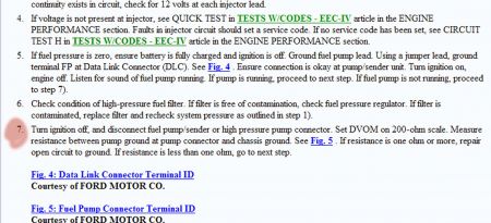

Replaced fuel pump less then a year ago, having trouble again, I don't hear pump motor winding, could it be electrical. Tom

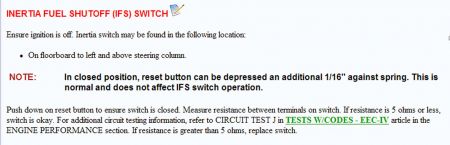

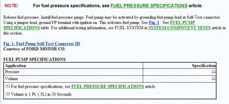

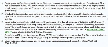

I sent a PDF file so you can see how to test the system...
