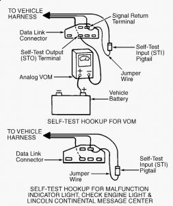

If ECT is bad it will be difficult or not start because it acts like a choke on fuel injected vehicles. Ignition module supplies spark along with the coil, if mod is going, one of the signs is hard/no start after missing and cutting out...coil too! If check engine light is on, lets read the codes, write them down and post results. Do this and count the flashes...Count the flashes, a 22 will flash as 2 flashes then a short pause, then 2 flashes, if more than one code is stored, the pause will be longer. The codes will display three times and end with 11 or 111. Write them down and post here. First do this with the ke on engine off, then again with it running.
https://images.2carpros.com/forum/automotive_pictures/62217_Ford_Self_Test_95_3.jpg

1. No check engine light ever comes on.
2. temp gage seems to operate properly - when in traffic it goes up and when on road it goes down...
3. This problem doesnt occur all the time, only when motor gets really hot. Then when it cools down, starts just fine.
Will check codes, but will take time. any other ideas I can check at the same time, ie - sensors.....

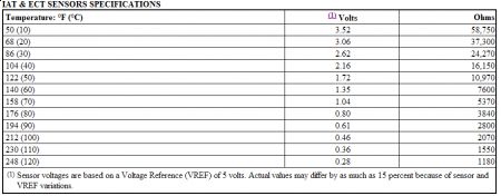

Temp gauge uses a temp sening unit, not the same as the ECT! (engine coolant temp) sensor. Check engine light should come on as soon as you turn the key to the on position, before you turn it to start, then go out after the engine starts? the one you want to check is on the thermostst housing, the one for the gauge is on left front corner of the engine. If you have an Ohm meter test it with these values.
https://images.2carpros.com/forum/automotive_pictures/62217_ect_Range_1.jpg

OK, Cool........will have to do my code reading tomorrow AM (Tues), no choice. Will check everything I can and then post the codes.

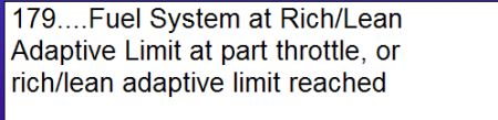

OK, did code tests. Did KOEO and got codes 11 and 1111, then from CM got codes 179 and 332 and that was all.

https://images.2carpros.com/forum/automotive_pictures/62217_179_1.jpg
https://images.2carpros.com/forum/automotive_pictures/62217_332_1.jpg
Upper intake is full of carbon. Remove EGR and clean the ports, May need to remove upper intake, clean out the carbon under it. The idle air control on the side of your throttle body is full of carbon as well, Ford recommends not cleaning these, just replace it, does not always set a code! ECT NEEDS to be tested have you done this yet!?
