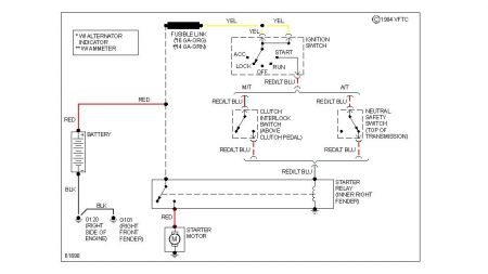

I've had starters go before, but this had no warning. I went to work and at the end of the day my truck would not start. I turned the key, had power but not even a noise from the engine. Some one said fusable link, low battery. I don't know. I pushed it to start and drove home. But same thing when I got home, only now I have no signals either, could be just a fuse I know but thought it might be relevent. If it is just the starter is there a suitable donner? Any help is better than no help. Thanks in advance.

The deal here could be low battery and bad connection at battery andt o the starter relay/starter, defective ignition switch, clutch switch, starter relay and starter itself.
Have helper hold key at crank position and look for power at the starter red and light blue wire at starter-do you have power? If so Bang on the starter-if it kicks over -replace it if not backtrack to the items above.
https://www.2carpros.com/forum/automotive_pictures/12900_starter_circuit_6.jpg
