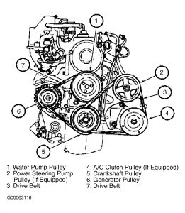

how to you change the alternator belt

Loosten the alternator bolts the alt will slide to loosten. Slide it the opposite way when replacing it. Here is a picture of the alt / belt. If you look at the alt near the #7 line listing, you will see the adjuster.
https://images.2carpros.com/forum/automotive_pictures/249084_altt_1.jpg
Let me know if this helps. Joe
