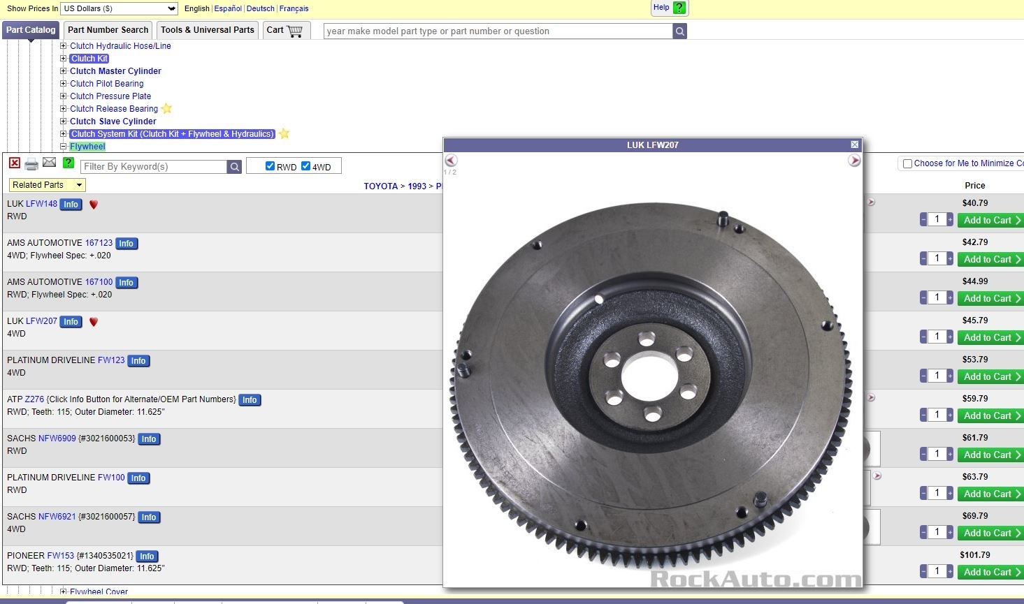

The truck listed above has a 1993 22R engine, it has an1983 clutch installed and a 1983 flywheel. None of the 1983 starters the owner bought would just barely touch the flywheel I bought a 1993 starter. The 1993 starter will start it a couple of times and then it is like it gets to a certain point and grinds, you keep trying to start it and it will crank. Question, do you have to match the clutch with the flywheel and do you have to match the starter up with the flywheel.
Can I turn the flywheel by removing the starter and turning the flywheel from where the starter is mounted so I can see if a tooth is broken? Can the flywheel be attached to the engine and be slightly off, if the flywheel bolts not being tightened in a star pattern.

Which flywheel did you use for the swap? Was the donor motor a 4 wheel drive?
There is a difference in the flywheel from the 2 to 4 wheel drive.

The guy who owned the truck thinks it may be a 2wd he doesn't remember, he said they had to match a 1983 clutch to a 1983 flywheel and put it on a 1993 4x4 Toyota pickup. How can I tell the difference? He says he doesn't see why they are different in flywheels.
Apr 2, 2021 at 9:31 AM

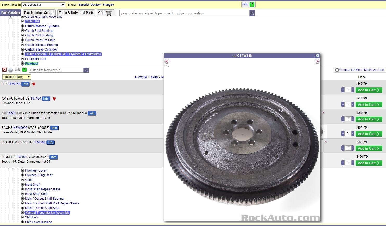

Do you have the old flywheel from the failed engine?
I posted pictures of the flywheels in a previous post. They are definitely different.

No Sir, he got rid of all that. would it be best to go ahead and remove the flywheel? it’s a 93 engine, 86 transmission with a clutch for a 83 truck.
Apr 2, 2021 at 2:17 PM
You should get the flywheel and the clutch for the 86 motor.
