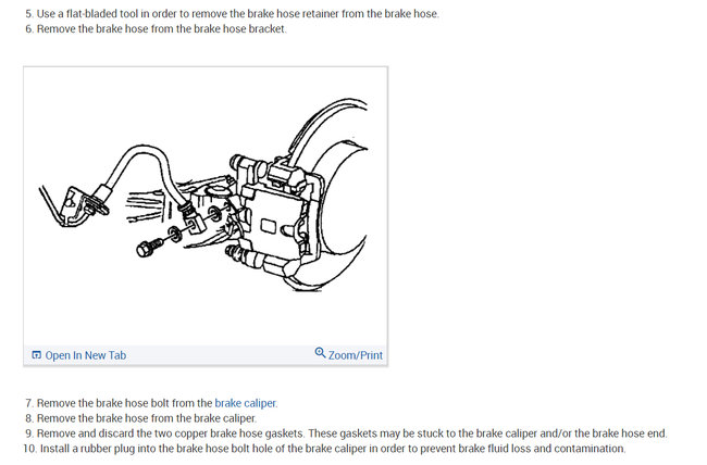

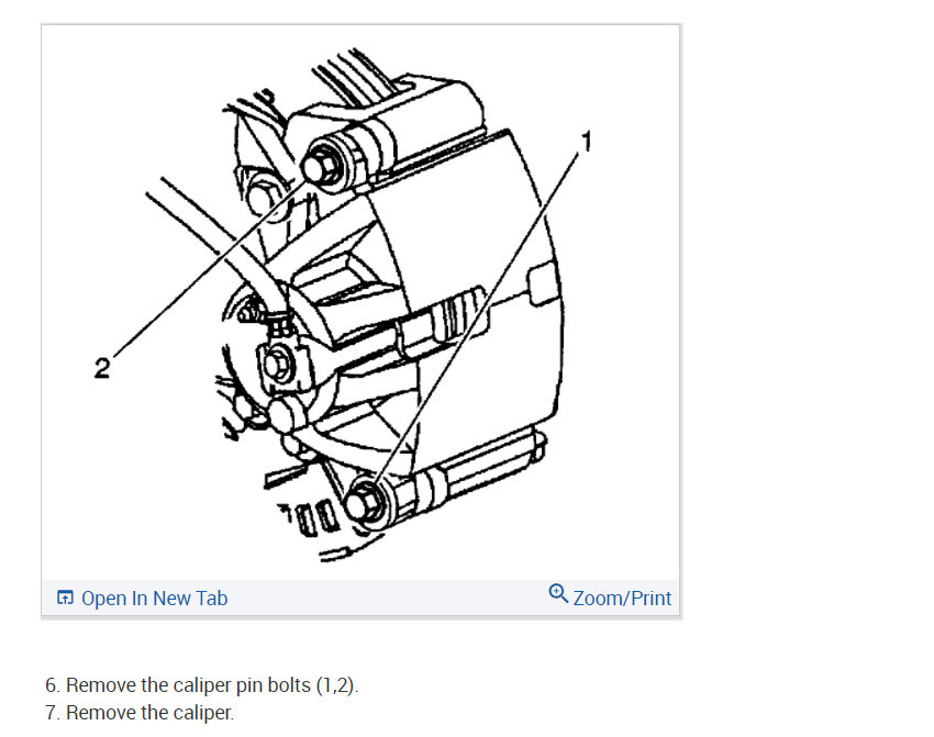

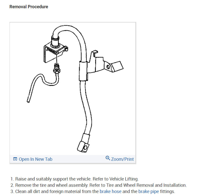

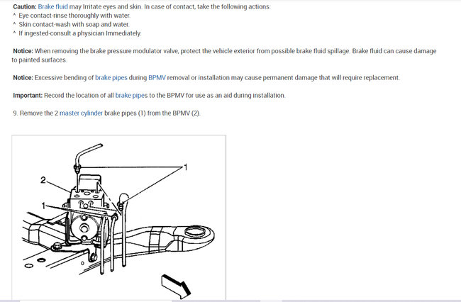

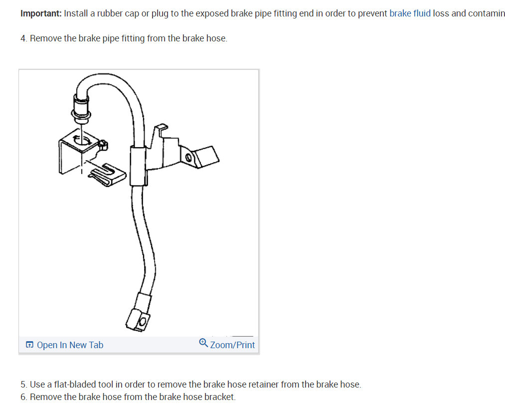

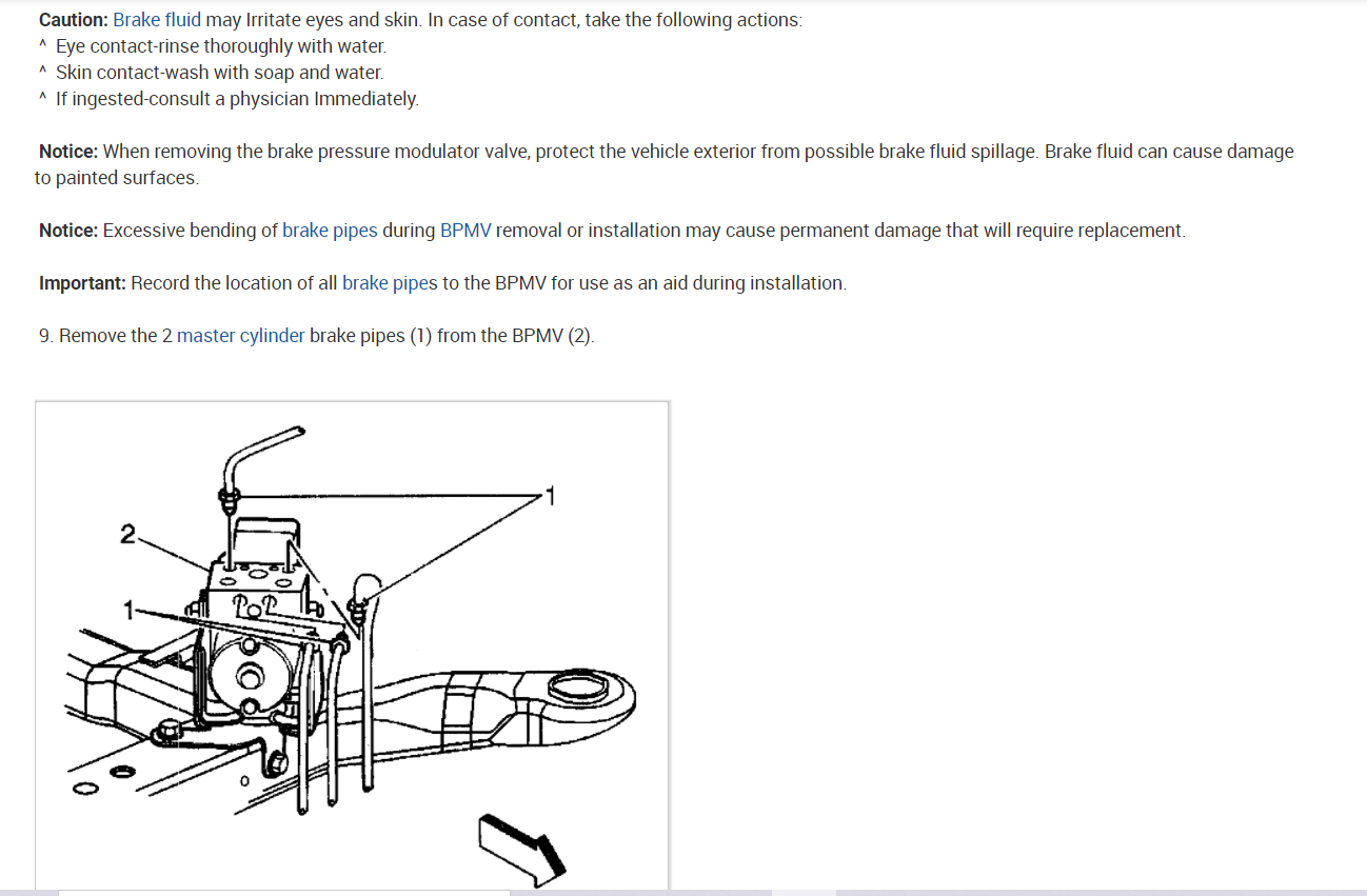

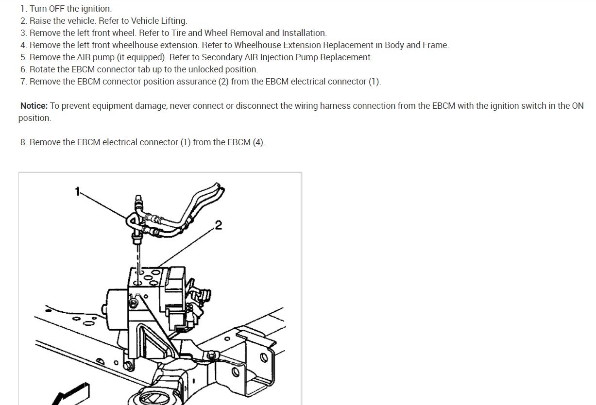

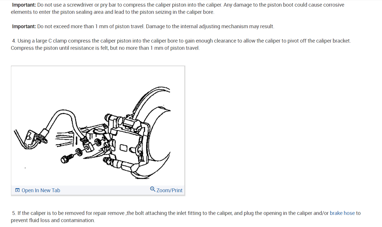

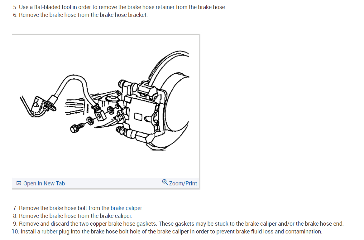

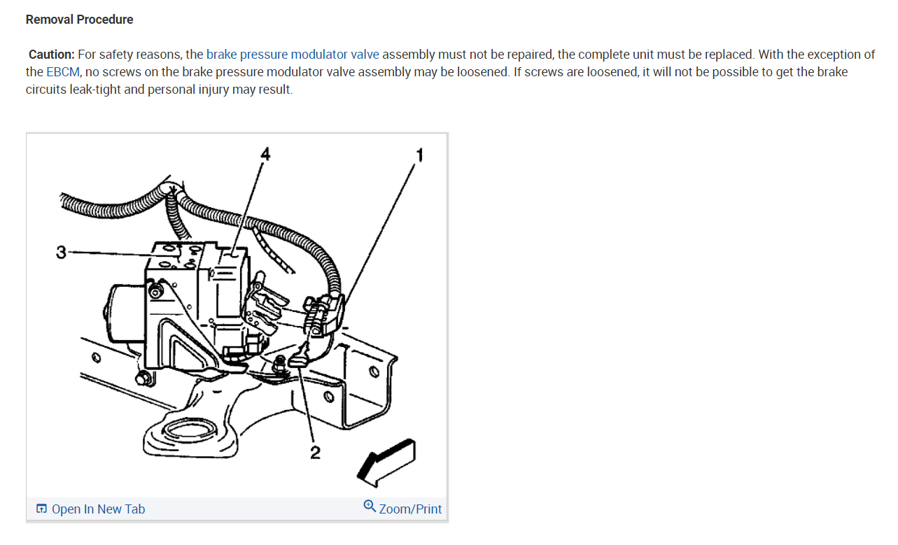

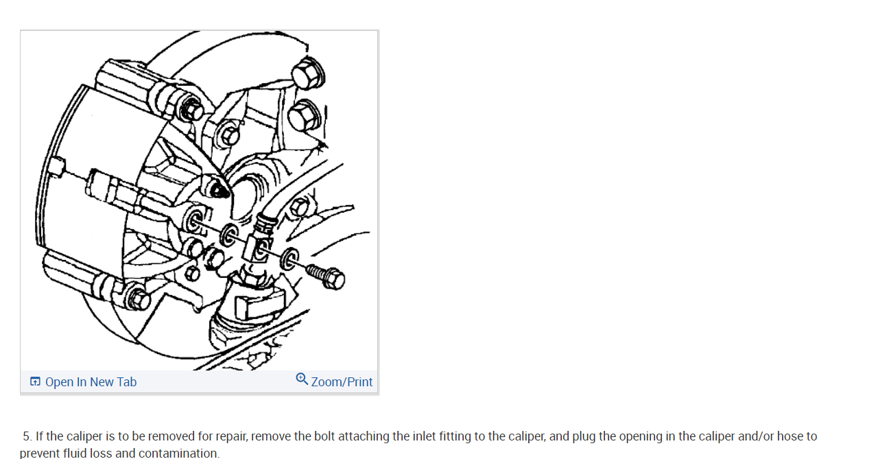

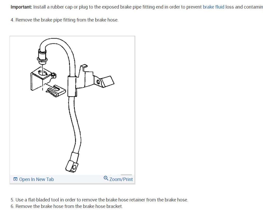

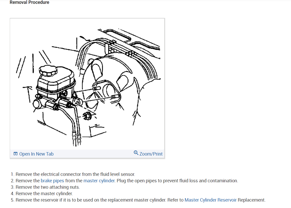

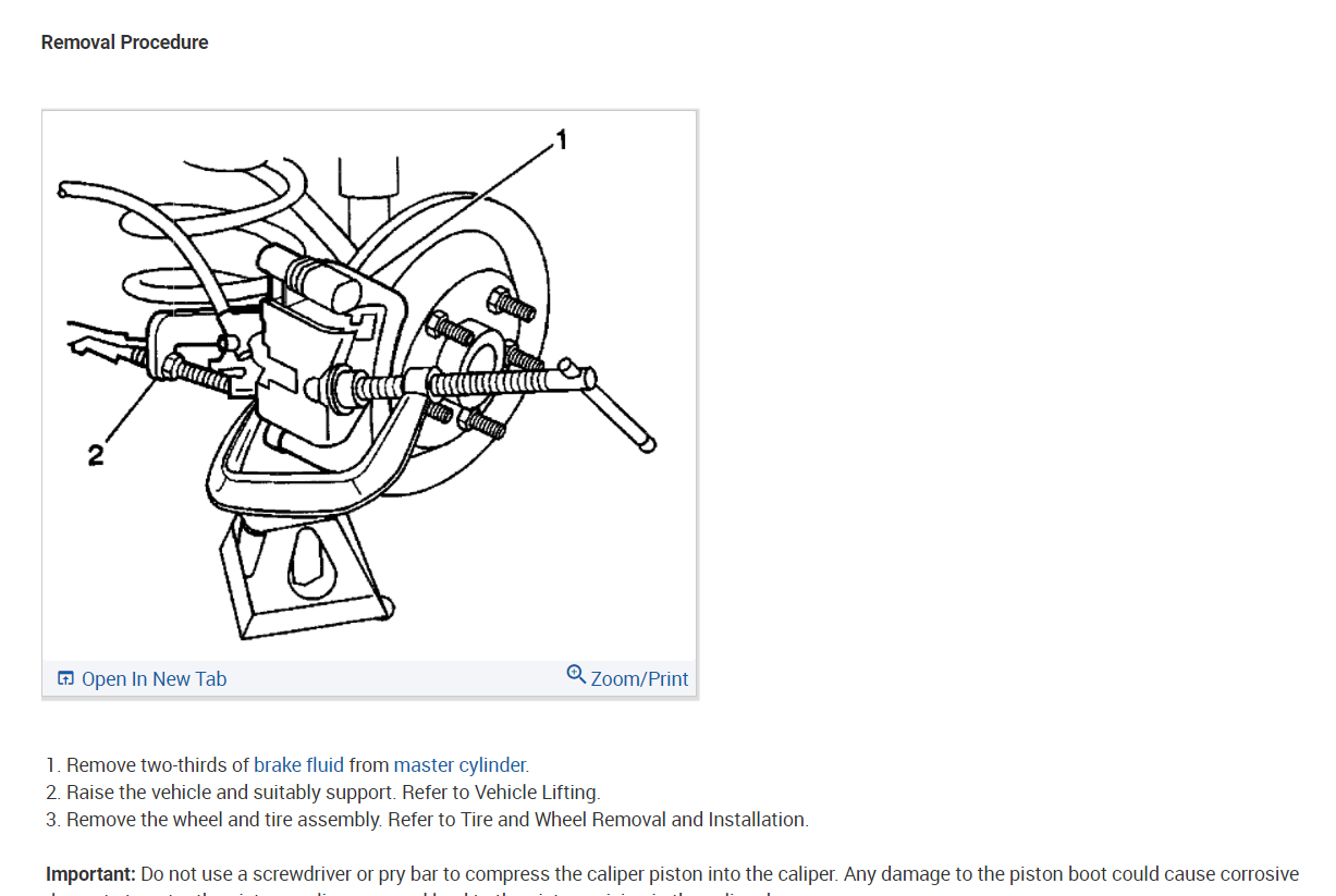

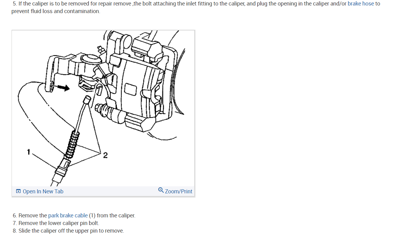

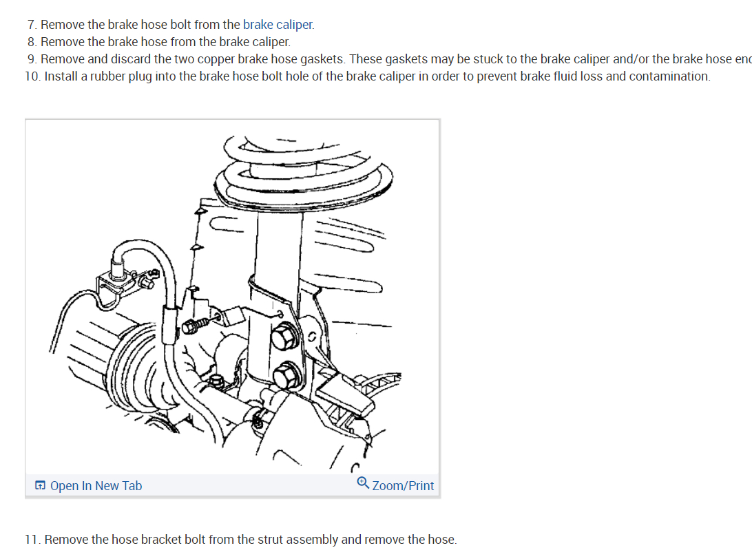

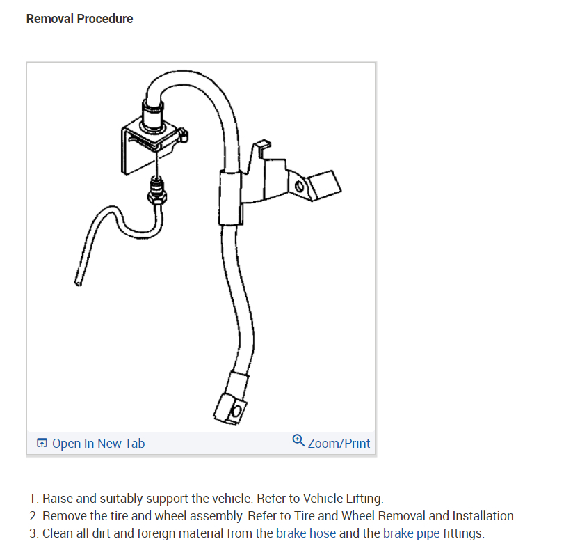

Good morning,

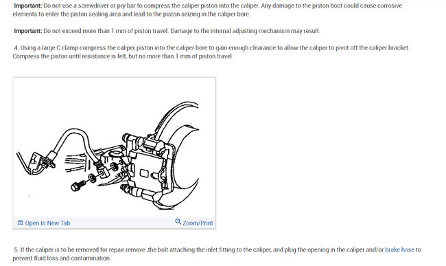

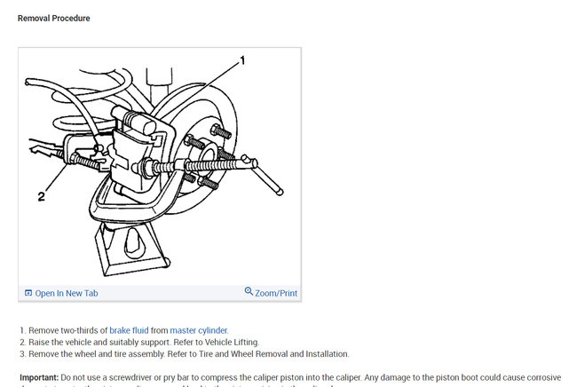

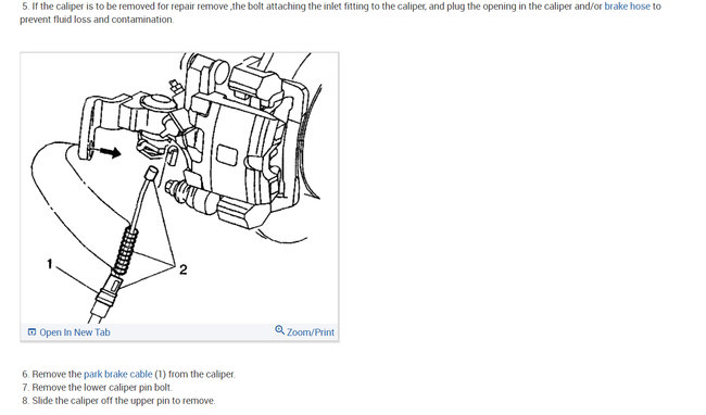

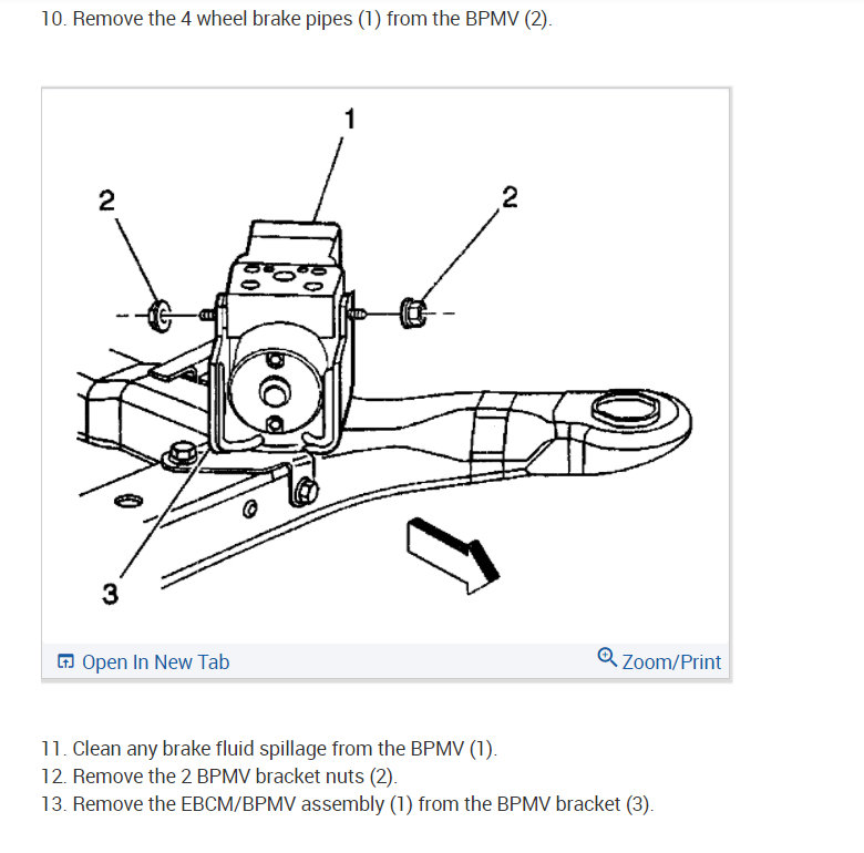

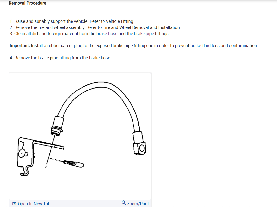

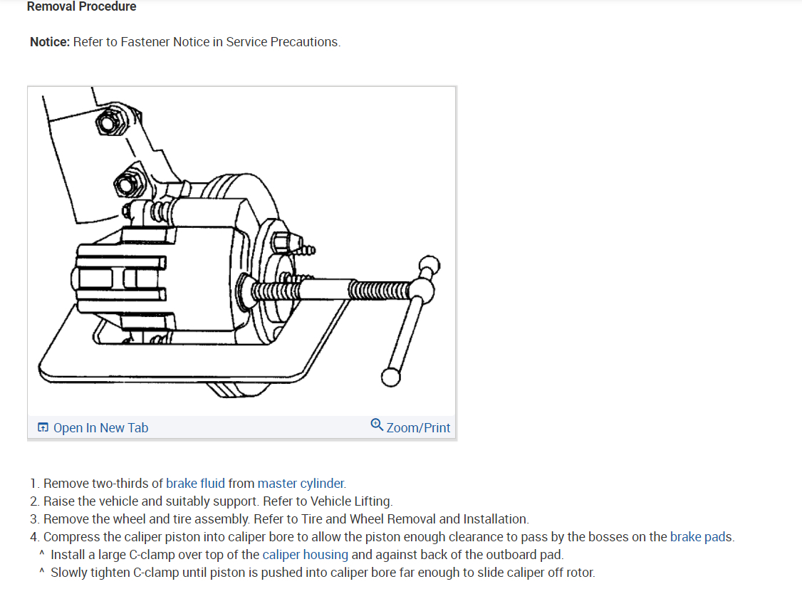

You have damaged the entire brake system. By adding that fluid to the master cylinder, you will need to change the master cylinder, calipers, brake hoses, front and rear, wheel cylinders in the rear and the ABS unit if you have ABS.
https://www.2carpros.com/articles/how-to-bleed-or-flush-a-car-brake-system
https://www.2carpros.com/articles/how-to-replace-a-abs-controller
https://www.2carpros.com/articles/how-to-replace-a-brake-master-cylinder
The fluid has damaged all the rubber components and the rubber will swell up and fail.
https://www.2carpros.com/articles/how-to-replace-a-wheel-cylinder
https://www.2carpros.com/articles/brake-caliper-replacement
Sorry, you have to replace all these items.
