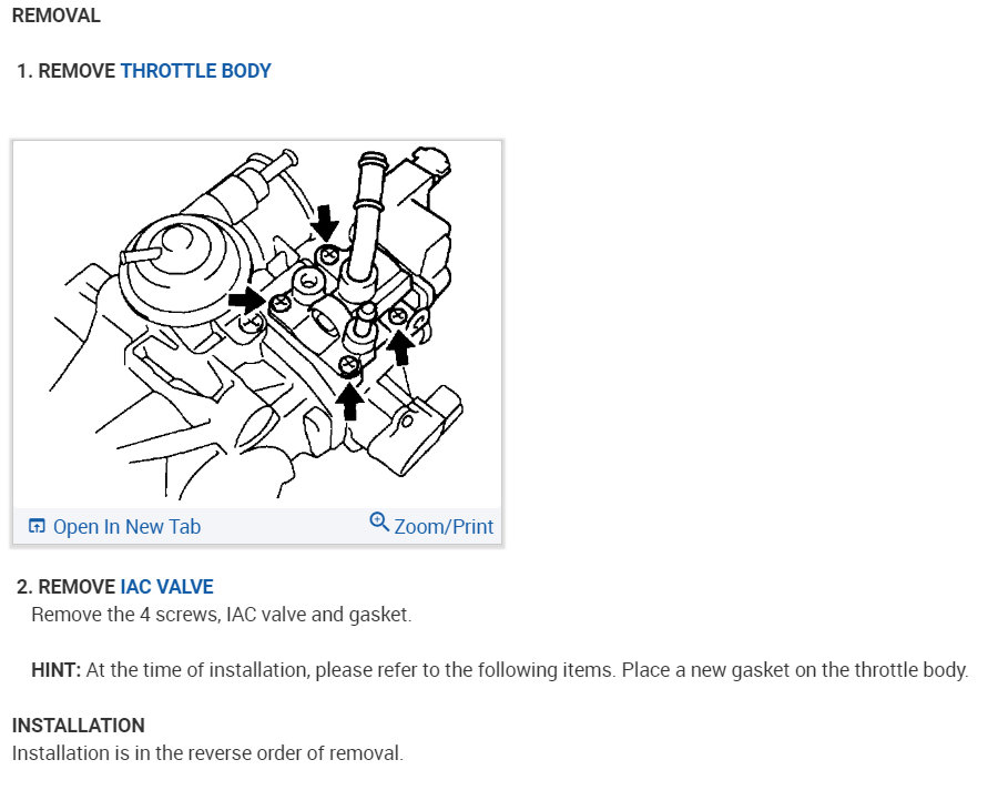

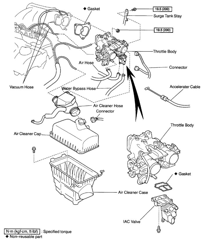

This is a common problem. it sounds like the IAC valve is dirty not allowing the engine idle speed to be adjusted. Here is a guide to help us fix the problem with diagrams below to how you how on your car:
https://www.2carpros.com/articles/how-to-replace-an-idle-speed-control-motor-iac
Clean the valve using carburetor cleaner.
