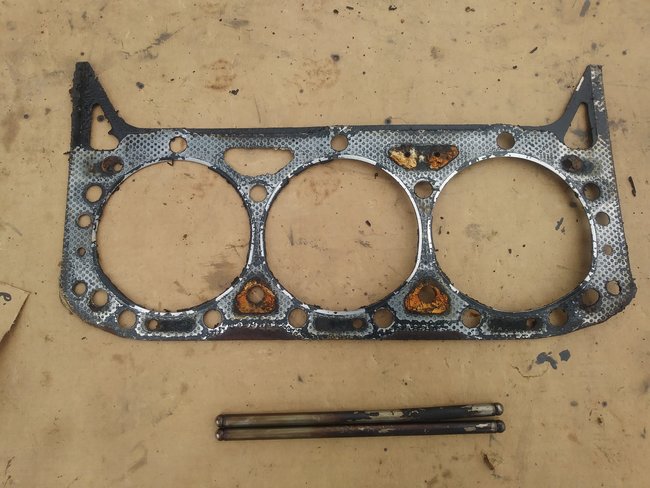

Hello CarPros. I started tearing my truck down. I found a bent push rod on# 2. so l'm taking the head off. I'll keep in touch. thank you guys!

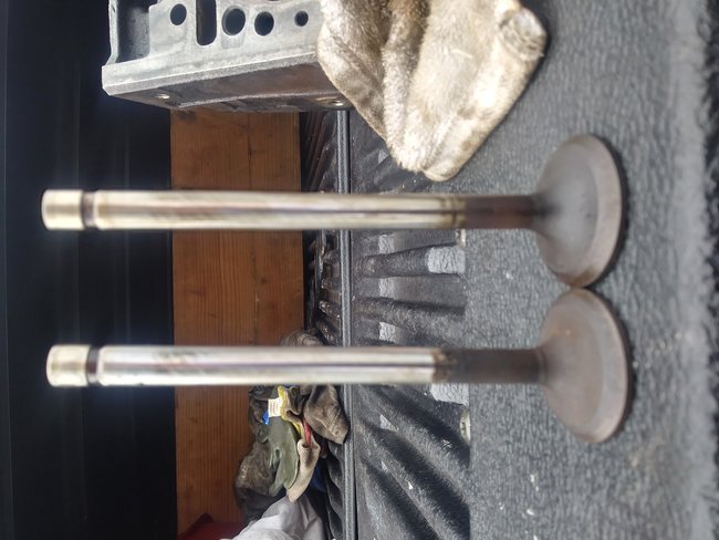

Hello CarPros. I got my right side head off today. I have a bent valve along with my bent push rod on#2 cylinder. I had to lightly tap out valve .I took out the valve from cylinder next to it to see how it fit in the valve sleeve from#2. it feels nice and tight and smooth. it's my belief I could lap another valve in#2 and would be okay. my problem is, I don't understand what caused this. I had no check engine lights on before this until I tromped down on my gas pedal. my only thought is maybe faulty fuel injection that made that cylinder hot and causing the valve to stick and bend it and push rod. I'm asking what would be your thoughts. I did buy and have the new fuel spider. thank you so much!!

Bent push rod.
Sep 24, 2020 at 7:09 AM
STEVE W.
  • 15,337 POSTS
That will cause the misfire. Good job finding it. Unfortunately you got hit with the binding valve stem issue. What likely happened was that you stepped down on the gas, the valve opened and had a slight bounce which caused it to bind, the piston came up and pushed it back into place, but now the bent stem was enough that the pushrod bent when it tried to move the valve again. Wouldn't be the first time. What I normally do with them is to pull the head off, remove the guide, install a new one, cut the seat and lap in a new valve. Or because they are sort of a known issue I'll even run a reamer set at the proper size for the guides bore and run it through them, just to be sure they are clear and round. Then do a valve job on the head.

The top of the piston has a little scuff mark where it pushed back the valve but looks okay. I'm buying a remanufactured head and putting it back together..
