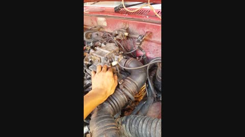

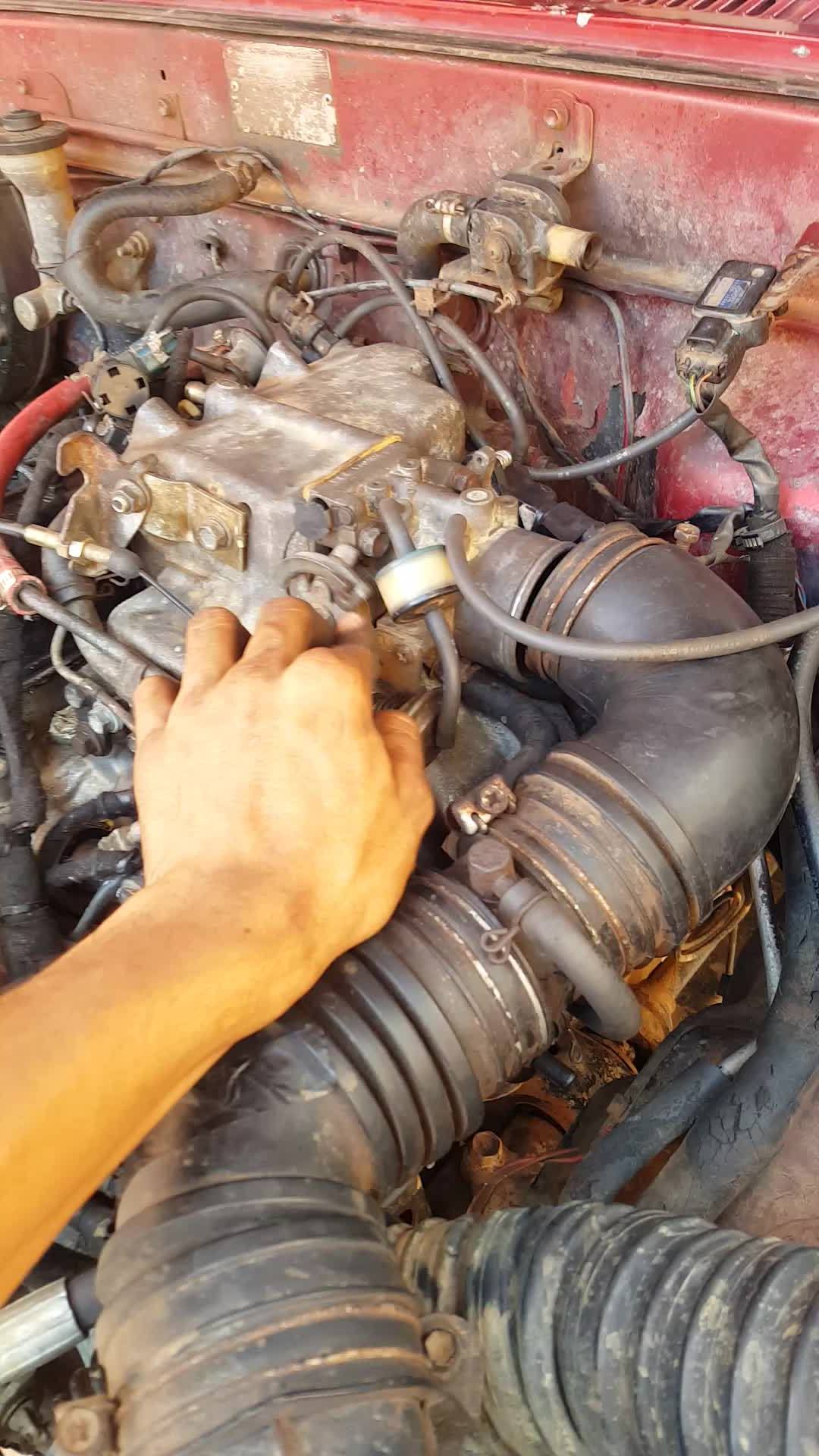

My 1989 Toyota Hilux Surf is giving me some gas problems. When it gets hot it backs down as I rev I have to keep the rev count high for it not to stall on me. It also throws black smoke.

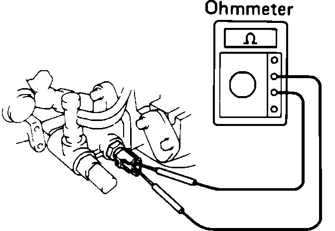

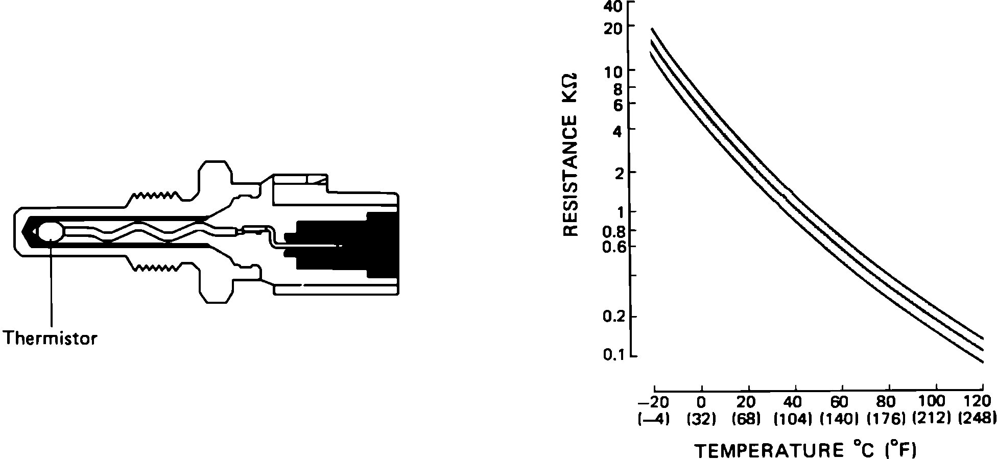

If you find that is the problem, here are the directions for testing the sensor.
COMPONENT INSPECTION
1. Disconnect the connector from the Water Temperature Sensor.
2. Using an Ohmmeter, measure the resistance between the terminals.
Testing Water Temperature Sensor
See picture 1
3. Refer to the specification chart and compare readings with appropriate temperature parameters.
Water Temperature Sensor (THW)
See picture 2
4. If readings are not as specified, replace the Water Temperature Sensor.

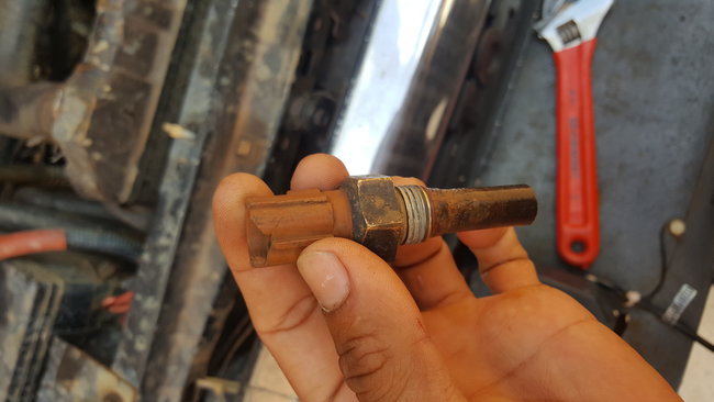

Hey thanks a lot man, those are some very great tips. I'll have to replace my temperature sensor because it's broken.

Here is a picture of the sensor.

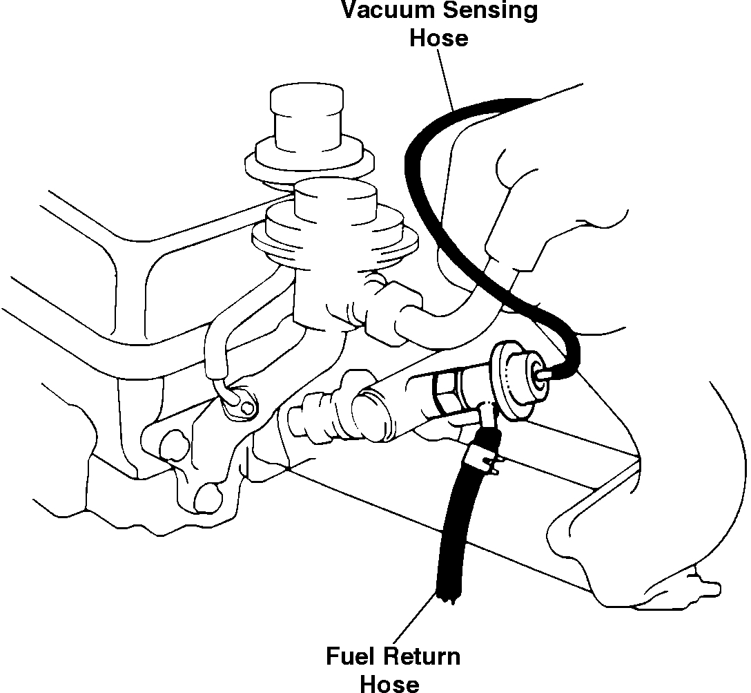

Does EFI engines have fuel pressure regulators?
Jan 20, 2019 at 11:29 PM
  • 110,241 POSTS
Hi and welcome back:

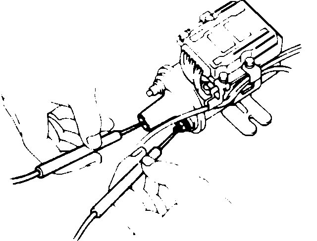

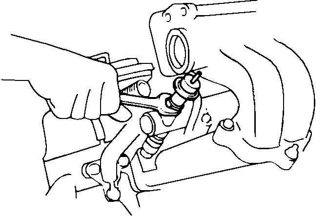

Yes, it does have one. It is mounted on the fuel rail. There will be a vacuum hose going to it. Remove the vacuum hose and confirm there is no fuel smell or evidence of fuel in the vacuum hose. If there is, it is drawing raw fuel into the engine via the vacuum hose and will cause a rich mixture. If you find the regulator is bad, here are the directions for replacement. Note: Picture one shows the regulator.
1. Disconnect the vacuum sensing hose.
Fuel Pressure Regulator And Hoses
See picture 1
2. Put a suitable container under the FPR to catch any fuel that escapes.
3. Remove the No.1 EGR pipe.
4. Loosen the hose clamp and remove the fuel return hose from the FPR.
5. Loosen the lock nut between the FPR and the fuel rail.
Removing The Fuel Pressure Regulator (FPR)
See picture 2
6. Unscrew the FPR from the fuel rail.
INSTALLATION:
1. Fully loosen the lock nut on the FPR and install a new O-ring.
2. Insert the FPR into the fuel rail, giving attention to the proper positioning of the pressure regulator.
3. Torque the lock nut to 22 ft.lbs. (29 N-m).
4. Reconnect the fuel return line.
5. Using a new gasket, reinstall the No.1 EGR pipe.
6. Reconnect the vacuum sensing hose to the FPR.
7. Ensure that any gasoline that escaped is thoroughly cleaned from the engine.
8. Start the engine and check for fuel leaks.
___________________
Let me know if this helps.

I'm still having the problem could it be that the throttle position sensor is bad??

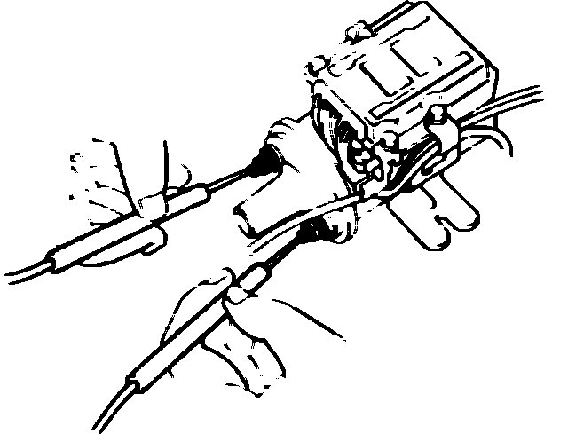

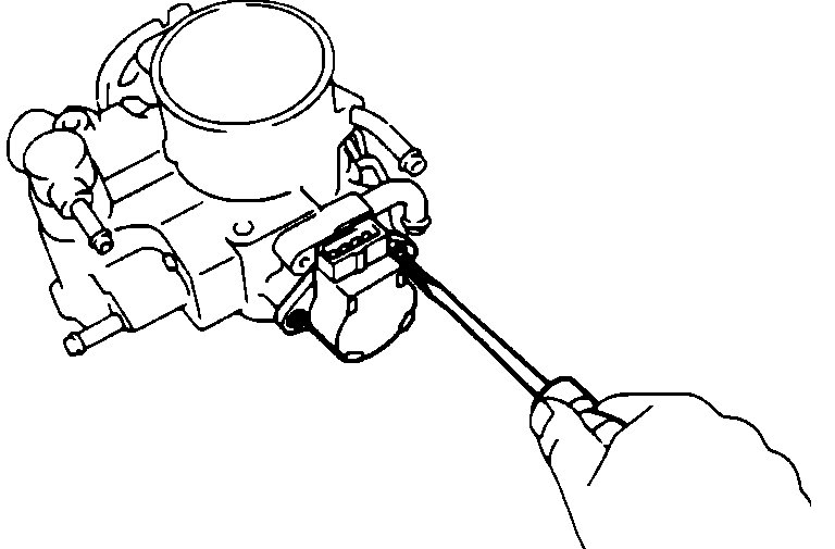

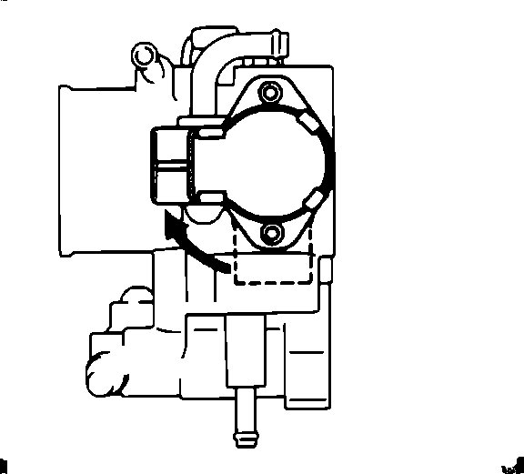

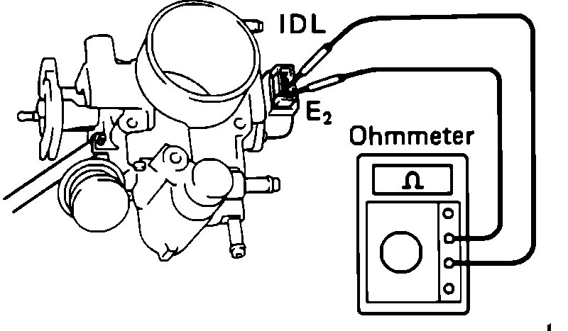

The throttle position sensor (TPS) could be an issue. The TPS sends a varying voltage signal to the ECU based on throttle valve position. The ECU can then adjust fuel delivery based on acceleration, deceleration, full throttle, or idle.
The TPS is adjustable. Here are the directions for adjusting and making sure it is where it should be. The attached pictures correlate with these directions.
_____________________________________________
1. Loosen the two set screws that secure the TPS to the throttle housing. (DO NOT REMOVE THE SCREWS)
TPS Adjustment Screws
See Picture 1
2. Connect an Ohmmeter to terminals IDL and E2 of the TPS after removing the connector.
3. Insert a 0.70mm (0.028in.) feeler gauge between the throttle stop screw and stop lever.
Checking TPS Adjustment
See Picture 2
4. Rotate the TPS counter-clockwise and slowly back clockwise until the Ohmmeter just looses continuity, (infinite ohms).
Adjusting TPS
See Picture 3
5. Secure the TPS with the two set screws.
6. Remove the feeler gauge and recheck TPS setting.
7. There should be continuity with a 0.57mm (0.022in.) feeler gauge inserted in the stop. There should be NO continuity with a 0.85mm (0.034in.) feeler gauge inserted in the stop.
8. Remove the Ohmmeter and reconnect the TPS connector.

I think I damaged mine I sprayed some cleaner on it n now it's idling up and down and revving out hard sometimes
Jan 22, 2019 at 11:12 AM
  • 110,241 POSTS
Welcome back:
Anything is possible. However, make sure there are no engine vacuum leaks that can act the same.

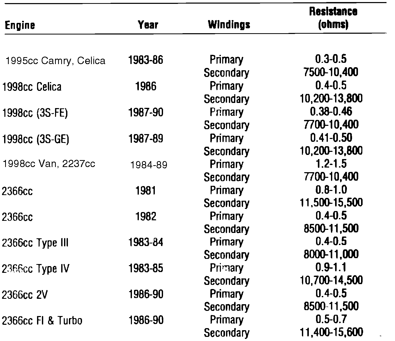

How do I test a distributor coil? What's the readings?
Jan 22, 2019 at 9:07 PM
  • 110,241 POSTS
Hi:
Here are the directions for testing the coil as well as the specifications.
1. Connect one end of an ohmmeter to the (-) side of the ignition coil. Connect the other end to the (+) side of the ignition coil.
Primary Coil Test
See pic 1
Primary Resistance (Cold): 0.5 - 0.7 ohms
1. Connect one end of an ohmmeter to the high tension terminal of the ignition coil. Connect the other end of the ohmmeter to the (+) side of the ignition coil.
Secondary Coil Test
see pic 2
Secondary Resistance (Cold):11.4k - 15.6k ohms
2. If Primary or Secondary coil resistance value is not within specifications, replace ignition coil. For further information, refer to SPARK TEST.
Pic 3 is the resistance specs.
Let me know what you find. I have to be honest, I really feel this has something to do with fuel pressure because of the black smoke you indicated. Have you confirmed fuel pressure and checked the regulator?
Let me know,
