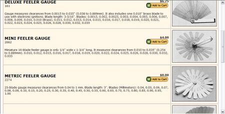

What is the "feeler gauge"? On the Ohmeter, what's the difference on the red probe and the black probe? Which is suppose to be on what? Am I suppose to leave the probe on the terimals for a while? I'm clueless!!! I am so sorry! I'm a single mom (of 5 kids & 3 step-kids) who can do repairs around the house, work a full time job, trying to start a new business but when it comes to car repairs, I don't have a clue! Thanks for all your help!!

A feeler gauge is a tool that measures a gap thickness-look below
https://images.2carpros.com/forum/automotive_pictures/12900_feeler_gauges_1.jpg
Put the feeler gauge thickness .018 thousandths of an inch at the throttle lever Put the red lead to the IDL and black to E-2 The same as VTA Loosen the TPS and move it till this is no reading on the meter. Then for the VTA-measure it should give you a reading between 3,000 to 10,000 ohms
