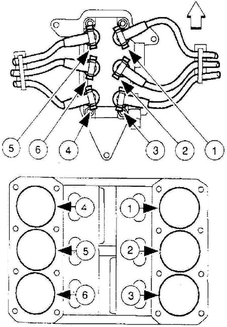

I put a new engine in my truck. And it is just not right it is not idling correct. We think we have the firing order off. Does anyone know the exact firing order for my SUV or have any suggestions on what to check?

Here is the engine ignition system firing order so you can get back on the road. 4.0 liter.

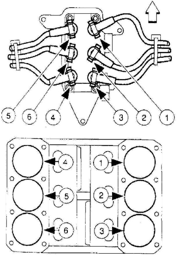

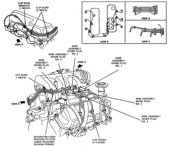

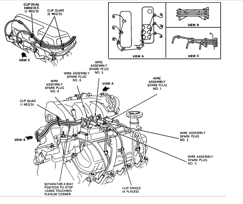

Hi and thanks for using 2CarPros. Com.
I have attached a picture for you to follow. Additionally, picture two is for routing the plug wires. Make sure to follow it. The wires melt from the heat of the exhaust manifolds if not routed correctly. Note: The arrow in the first picture is pointing toward the front of the vehicle.
Let me know if this helps or of you have other questions.

Firing order for 4.0 l engine is 1 4 2 5 3 6

Re check your firing order, set up wires this way and re try to start.
https://www.2carpros.com/forum/automotive_pictures/62217_FO_17.jpg
