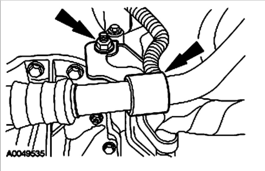

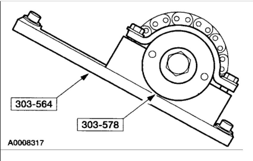

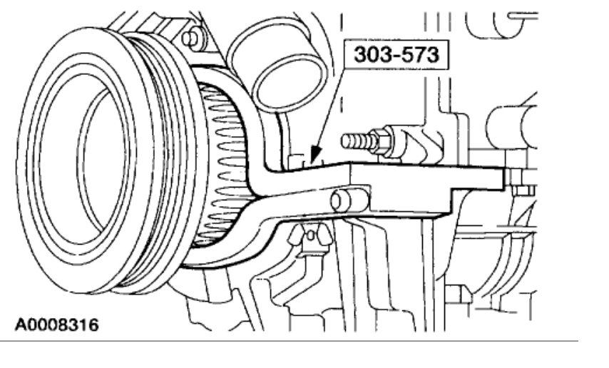

My timing cassettes broke s well as the balance shaft chain while the engine was running i have pulled the motor and have installed all new timing chains and tensioners but i have no idea how the timing is supossed to be i have a hanyes manuel and can understand about setting the crankshaft to jackshaft timing but dont know how to set the timing on the camshafts that are linked to the jackshaft
Dec 17, 2009 at 2:37 AM
  • 55,647 POSTS
Here is how the job is done to replace the timing chain and to retime the engine camshaft.
You must re-time the LH and RH camshafts when either camshaft is disturbed.
Turn the crankshaft one revolution clockwise.

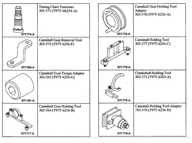

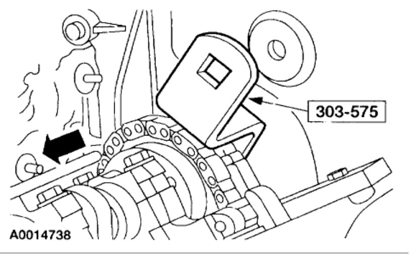

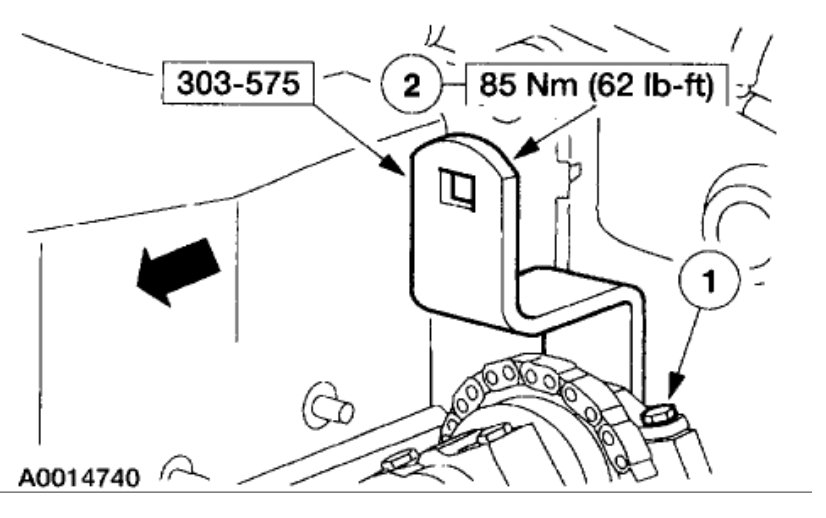

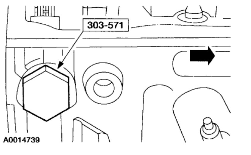

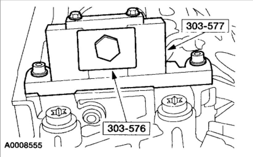

Install the special tool. The special tool must be installed on the damper and should contact the engine block, this positions the engine at top dead center (TDC). Using the special tool, loosen the RH camshaft sprocket bolt. The right-hand camshaft sprocket bolt is a left-hand threaded bolt. Position the camshaft timing slots below the centerline of the camshaft to correctly fit the special tools and install the special tools on the front of the RH cylinder head. The camshaft timing slots are off-center.
Install the special tools on the rear of the RH cylinder head. Leave the top two special tool clamp bolts loose. The right-hand camshaft sprocket bolt is a left-hand threaded bolt.

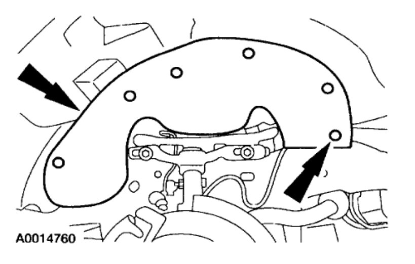

Check out the diagrams below
