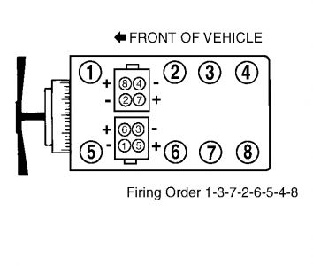

350VORTECK
what is the firing order and what are the cylinders by number(1 thru 8)

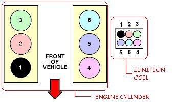

Engine Performance problem 6 cyl Four Wheel Drive Automatic 178k miles
I paid a guy to tune up my explorer. which he ripped me off. instead of putting the brand new plug wires on that I bought for my explorer, he put used plug wires from a completely different vehicle on, and did not get the firing order correct. I now have the correct plug wires, but I don't know the correct firing order. My Explorer has a 4.0l SOHC V6 engin.
Oct 9, 2020 at 2:40 AM (Merged)

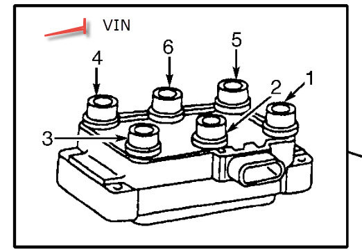

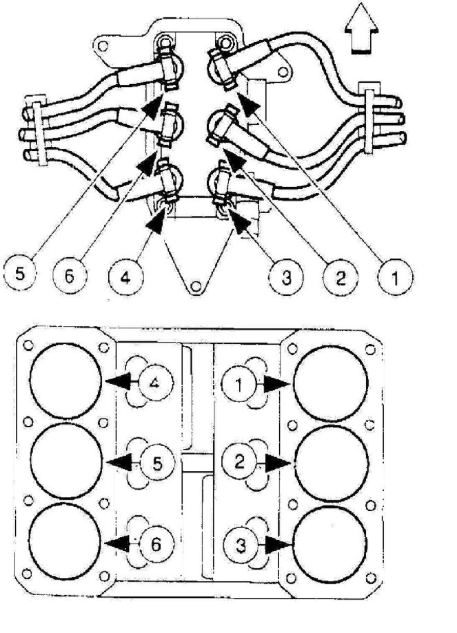

BLUELIGHTNIN6
  • 16,542 POSTS
Hello Below is the info. you requested. 1997 Ford Explorer 4WD 4.0 liter SOHC V-6 VIN "E"
https://images.2carpros.com/forum/automotive_pictures/261618_92722991_1.gif
Hope this helps.. Thanks for using 2carpros.com!
JLVANZANT
  • 6 POSTS
is that the same for the ignition coil?
BLUELIGHTNIN6
  • 16,542 POSTS
The smaller picture is the ignition coil. Below I have highlighted and labeled each one..sorry for the confusion
https://images.2carpros.com/forum/automotive_pictures/261618_Noname_109.jpg

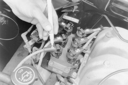

JLVANZANT
  • 6 POSTS
yes it does. my next dumb question is. on the diagram of the ignition coil. which side of the diagram is the connection from the ignition module located. I really miss the days of the distributor cap and rotor button.
BLUELIGHTNIN6
  • 16,542 POSTS
Ah, no such thing as a dumb question. In fact, this is a really good question, hehe. I think the picture below will help you out. Just in case you can't see the writing on the wires, the 3 wires on the left of the picture are 1 (starting at front where hand is) , 2 and 3. The wires on the right side of picture are 5 (starting at the front again) , 6 then 4.
https://images.2carpros.com/forum/automotive_pictures/261618_0900c1528018eb4a_1.jpg
You should be able to find the connector from this picture. Thanks for using 2carpros.com!

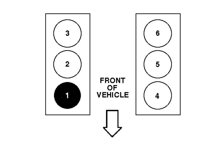

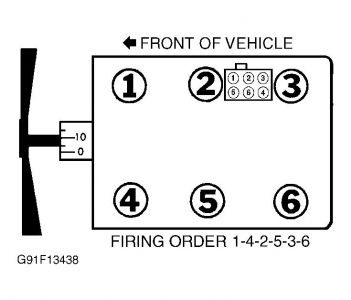

BK49512
Six cylinder four wheel drive automatic
I put a new engine in my truck. and it is just not right it is not idling correct. we think we have the firing order off. does anyone know the exact firing order for my SUV or have any suggestions on what to check?
  • 55,051 POSTS
Hello, Here is the engine ignition system firing order so you can get back on the road. 4.0 liter.
https://images.2carpros.com/forum/automotive_pictures/12900_fo_74.jpg
LARGER IMAGES BELOW Please use 2CarPros anytime, we are here to help. Please tell a friend. Cheers, Ken

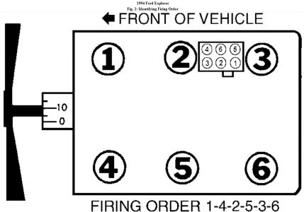

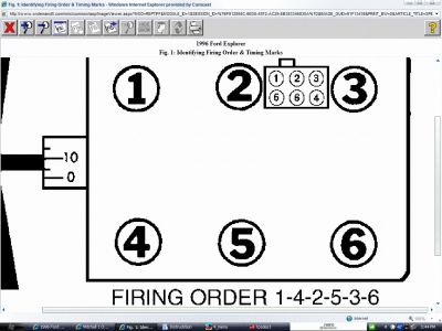

WILSONADY87
I messed and cant remember were to put the spark plug wire on the distibuter coil from the spark plug.
MERLIN2021
  • 17,250 POSTS
https://images.2carpros.com/forum/automotive_pictures/62217_FOV6_1.jpg

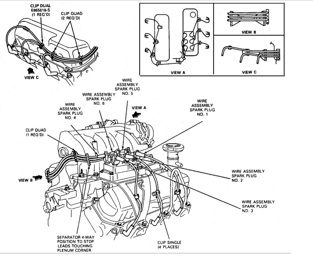

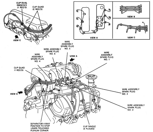

MELCHIZEDEK
My problem is, she Idles rough after starting especially when I put her in gear or turn the AC on. I smell raw fuel and I suspect that the firing order is off. Not quite sure.

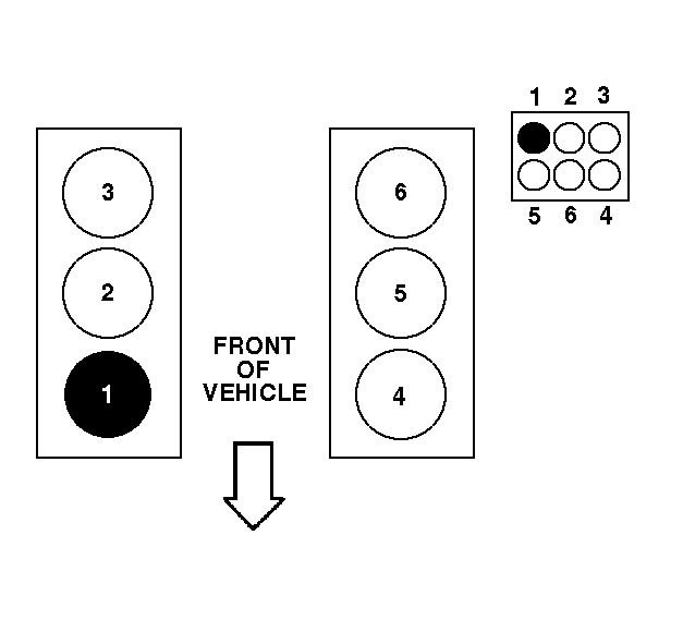

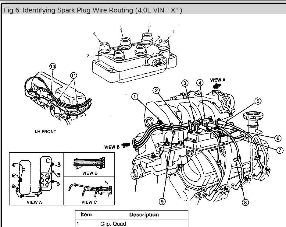

  • 110,236 POSTS
I have attached a picture for you to follow. Additionally, picture two is for routing the plug wires. Make sure to follow it. The wires melt from the heat of the exhaust manifolds if not routed correctly. Note: The arrow in the first picture is pointing toward the front of the vehicle.
Let me know if this helps or of you have other questions.

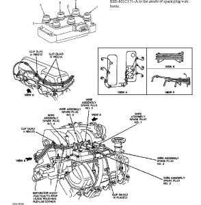

SERVICE WRITER
  • 9,123 POSTS
https://images.2carpros.com/forum/automotive_pictures/30961_expl_1.jpg

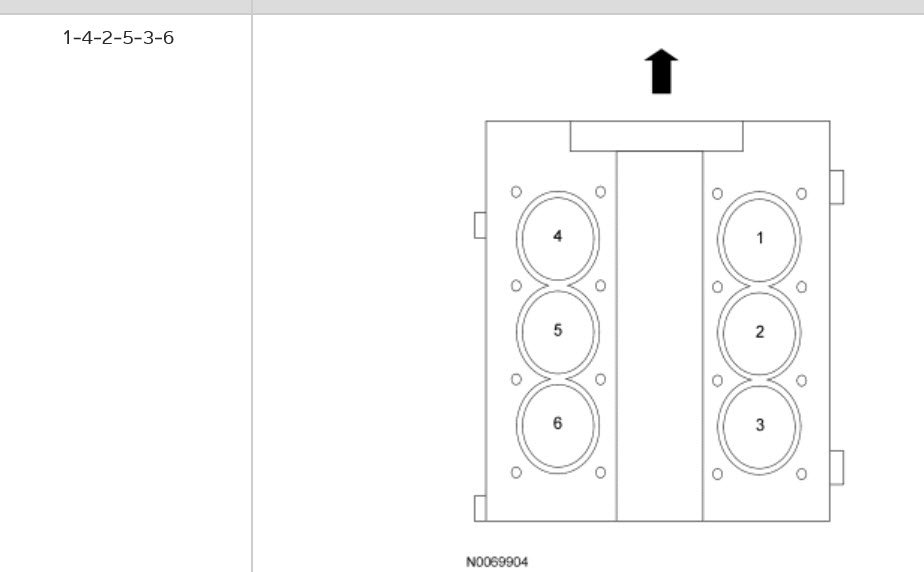

MNMFAIRBARN
Need to know the firing order
BMRFIXIT
  • 19,053 POSTS
https://images.2carpros.com/forum/automotive_pictures/99387_explor_1.jpg
Firing order for 4.0 l engine is 1 4 2 5 3 6

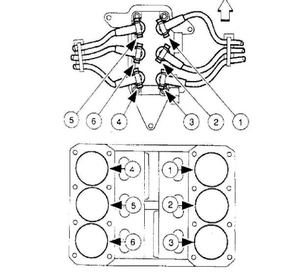

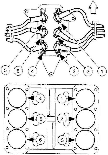

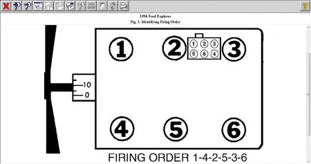

TOMD1210
i just replaced the plugs and wires. the proper spacing was 0.54 all 6 are exactly the same. brand new wires just bought today. the problem is the engine wont turn over for more than a few seconds. the engine jumps and shakes. i think it might be the distributor cap, but before i spend the money if its not that i would like a second opinion.
Mar 13, 2021 at 10:15 AM (Merged)
MERLIN2021
  • 17,250 POSTS
Re check your firing order, set up wires this way and re try to start.
https://images.2carpros.com/forum/automotive_pictures/62217_FO_17.jpg
