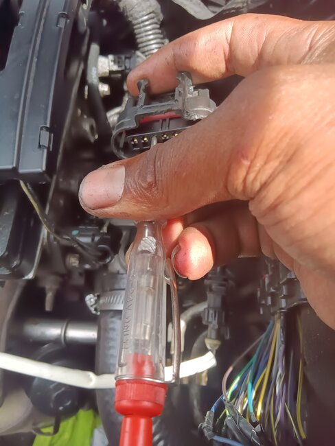

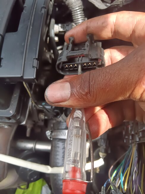

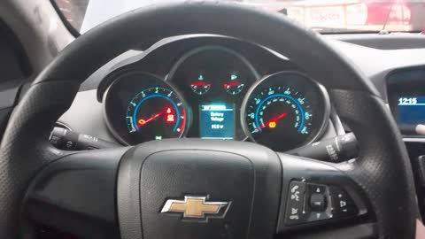

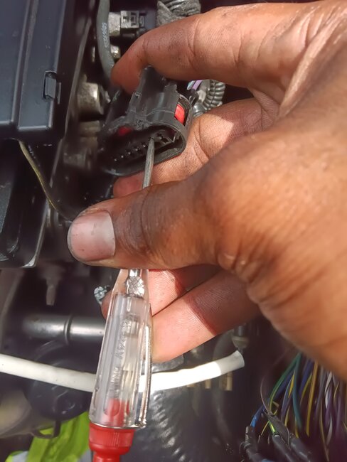

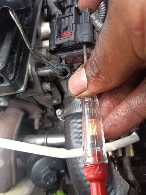

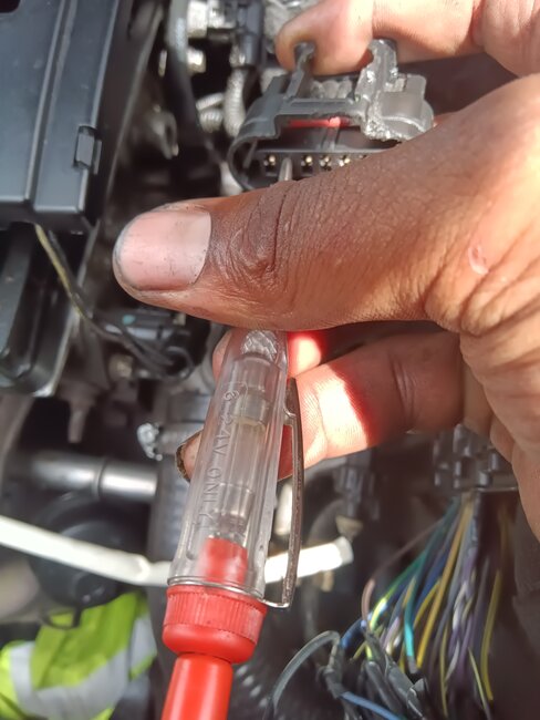

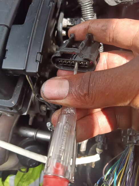

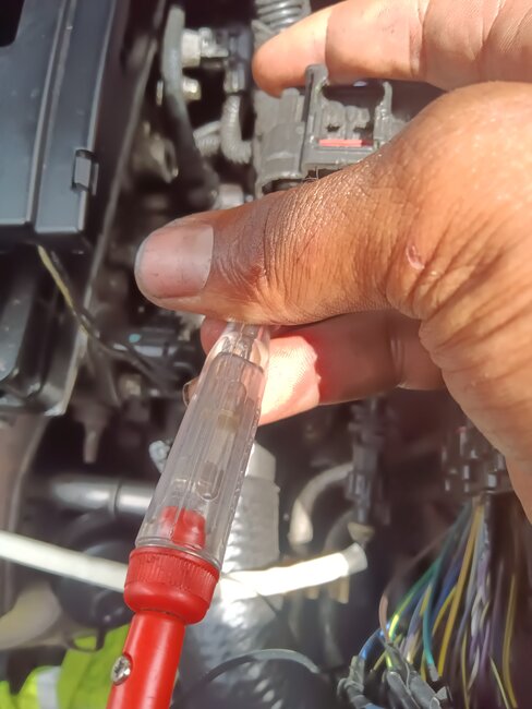

Hey, I recently replaced my ECM x2 harness due to a failure with the oil pressure pan. After getting the wiring and pins back correct, soldered and taped the starter went out. I checked to make sure the motor wasn't seized by turning the flywheel. I tested the starter to confirm my suspicion, so I replaced it and tried to crank it. After doing so I realized I wasn't getting fire in my ignition control module. I tested it with my test light to see if the ignition positions would light, the only one that lit up was the power train. I wanted to know if it was an alternating or direct current that goes through it to the coil pack. I'm thinking this would be considered a no crank no start. Okay here's an update. So after removing and putting fuses and relays back I got it to crank but not run. I checked the ignition fuses including the 2 relays. I also checked the ecm and bcm fuses. All of which have fire coming to and from them. When cranking it sounds like it's a really rough crank. I was thinking it might be the crankshaft position sensor but I really don't know.

Thanks for the video. It helps. It looks like the battery needs to be replaced but to be sure we can use this guide to confirm the issue:
And this guide may help as well:
Please go over these guides and get back to us.

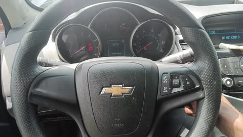

Here's a video of me cranking it after I did my load test.
Aug 7, 2023 at 11:41 AM
COREYABRAM901
  • 10 POSTS
When cranking I observed that the light went completely out and back on. I'll get another battery and see what happens. I'll keep you informed and thanks.
Aug 7, 2023 at 11:57 AM
  • 55,721 POSTS
Yes, please do, thanks for the videos. When the engine is cranking over it sounds like something is wrong, but I will be able to tell more once the new battery is installed, please upload a new video of the engine cranking over so I can see what's going on.

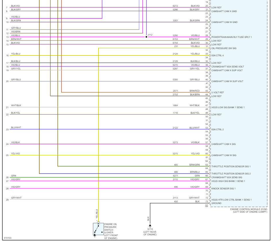

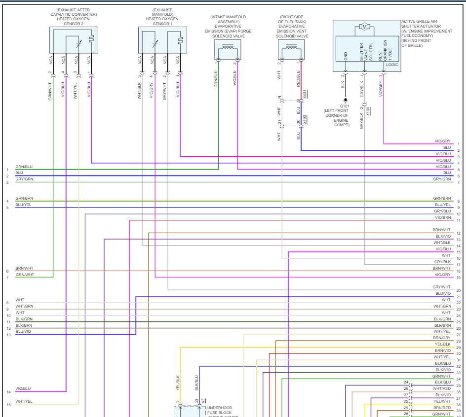

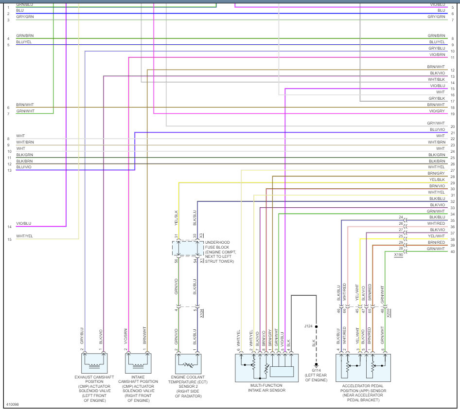

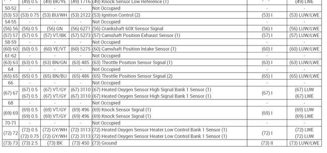

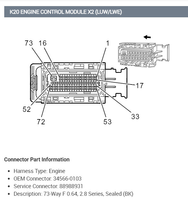

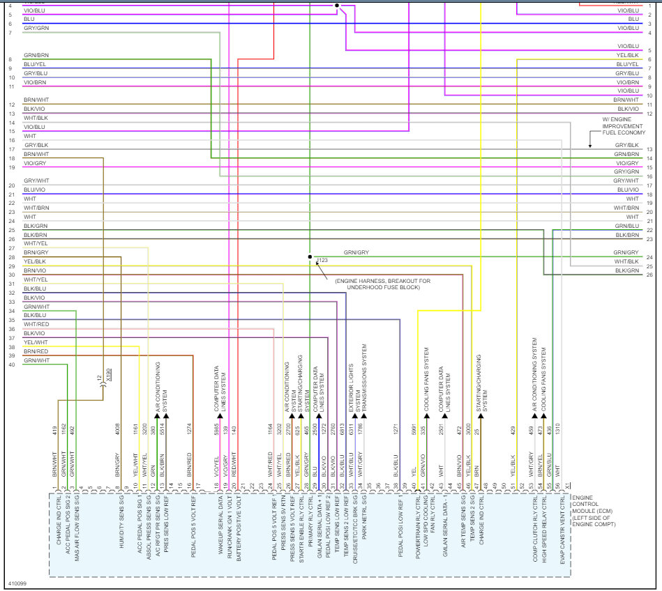

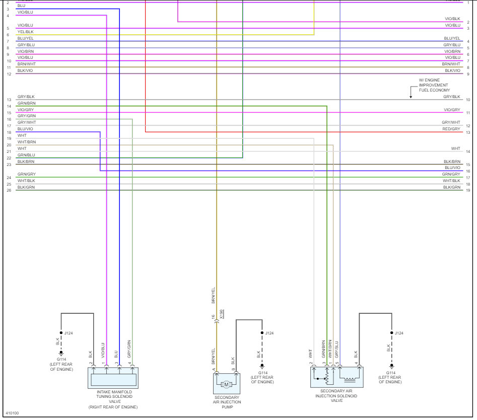

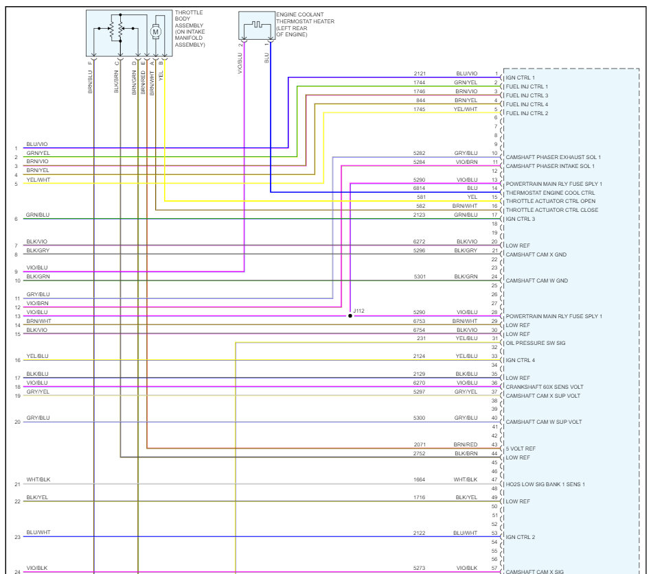

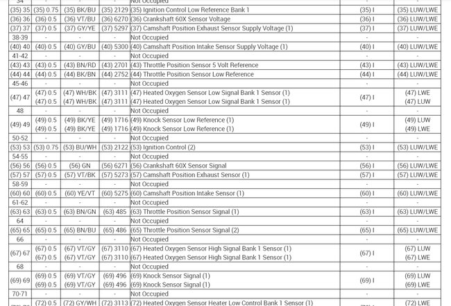

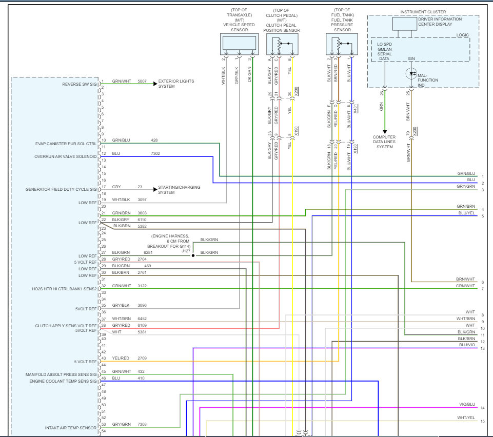

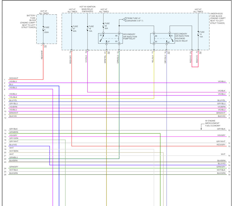

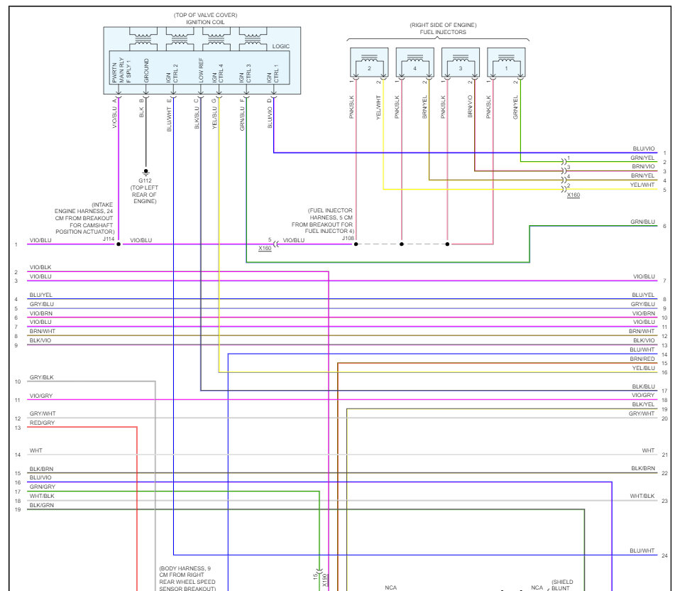

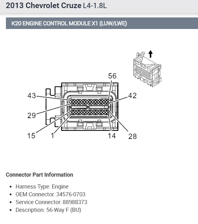

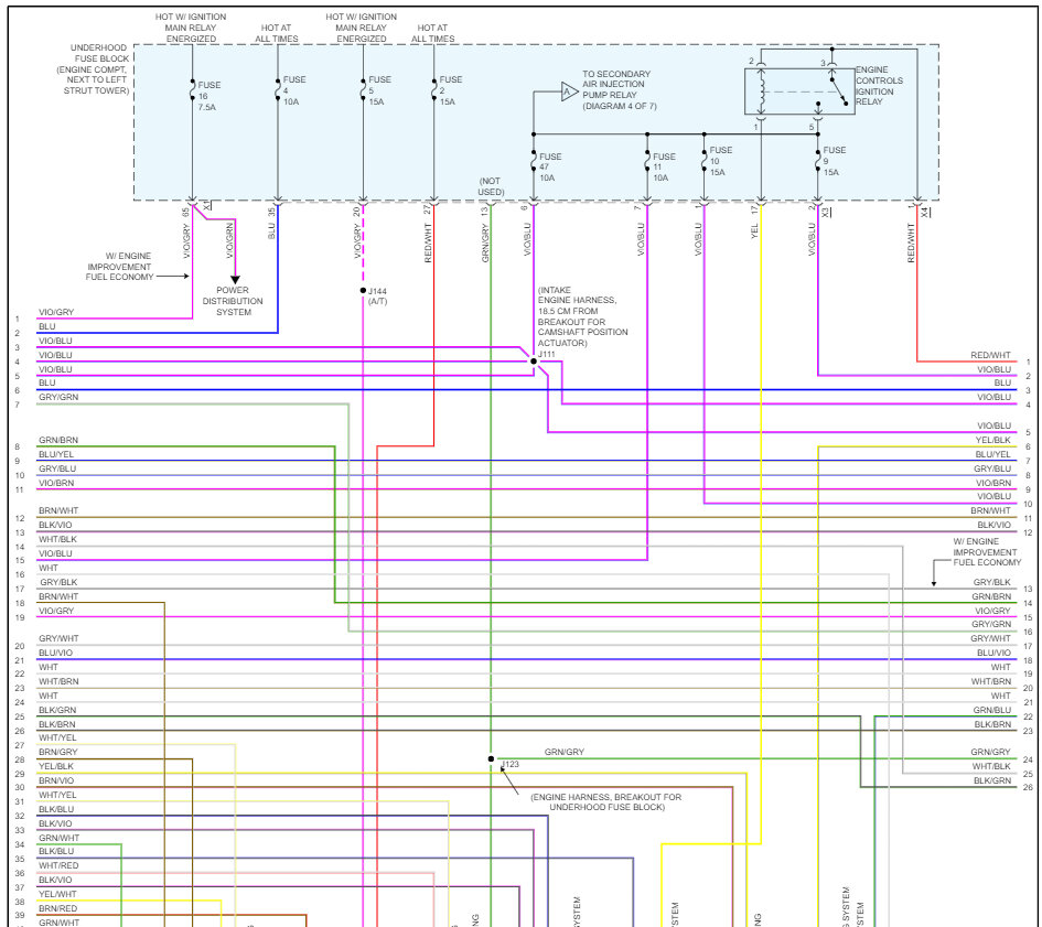

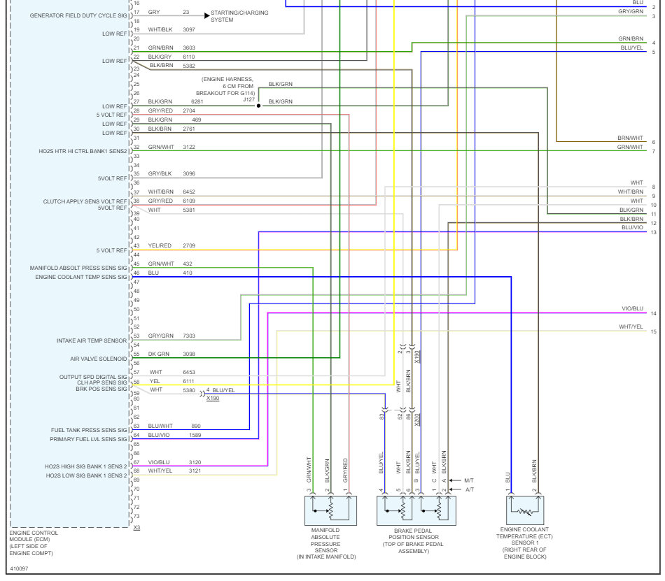

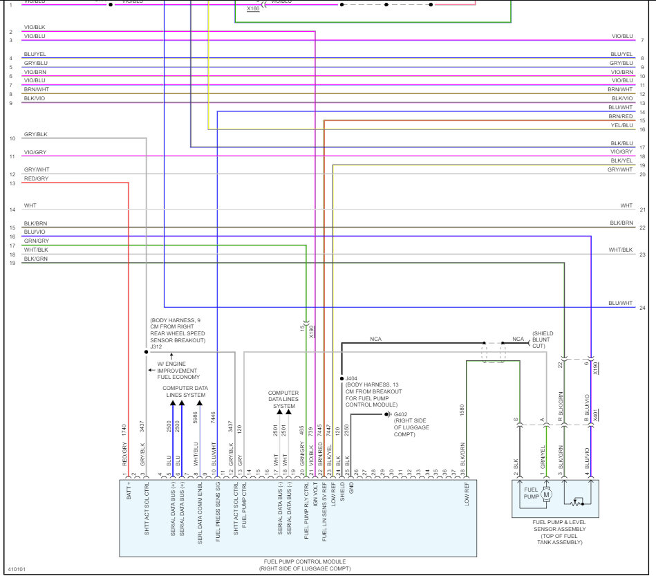

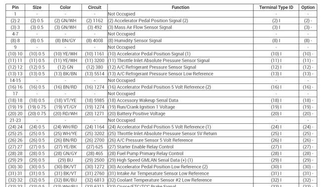

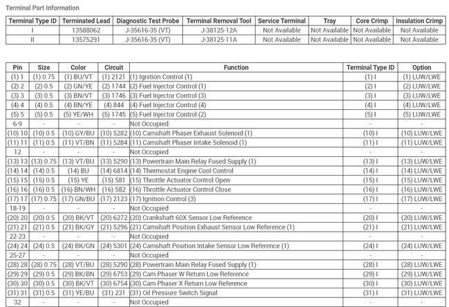

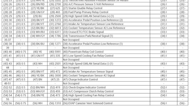

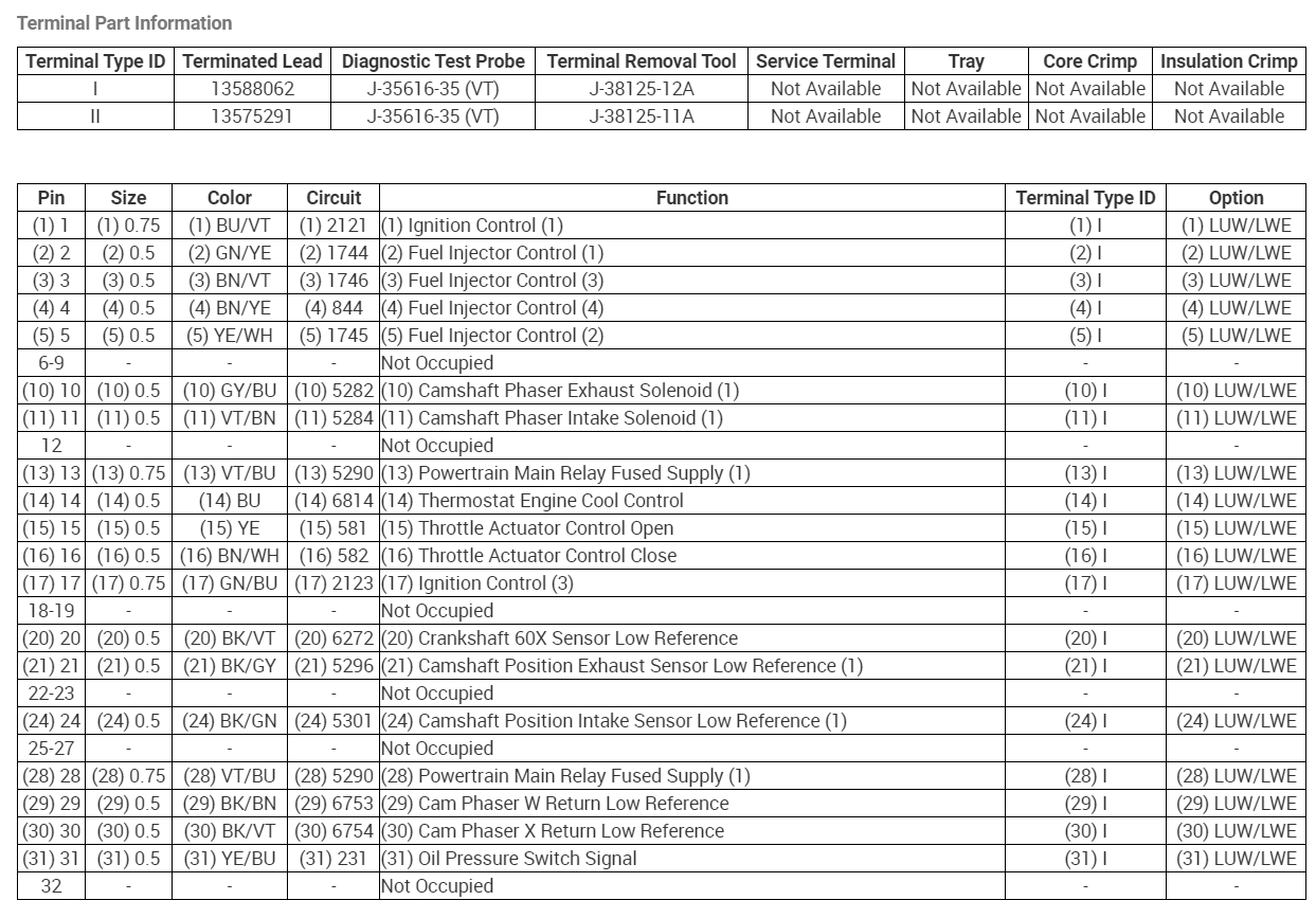

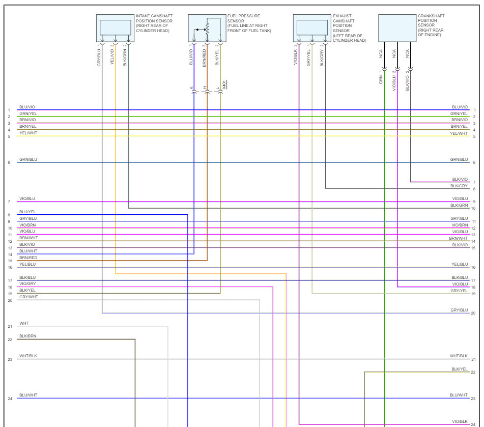

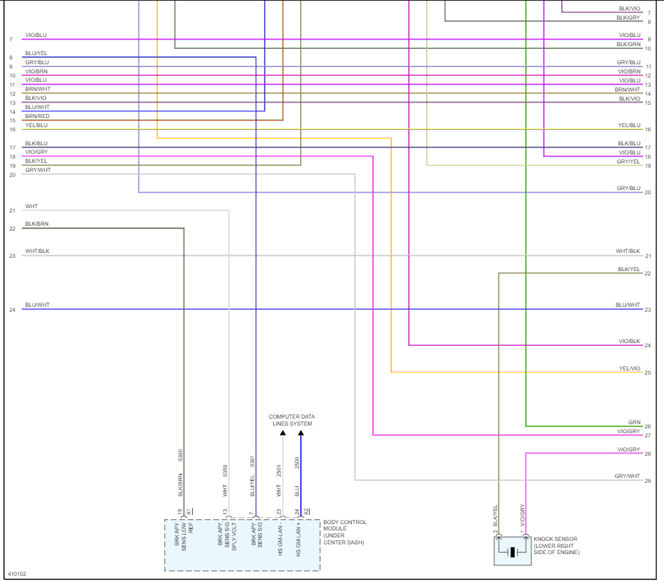

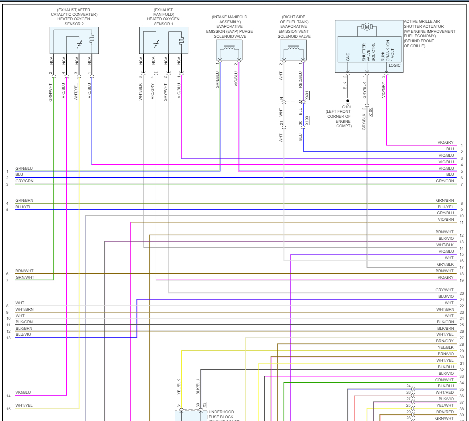

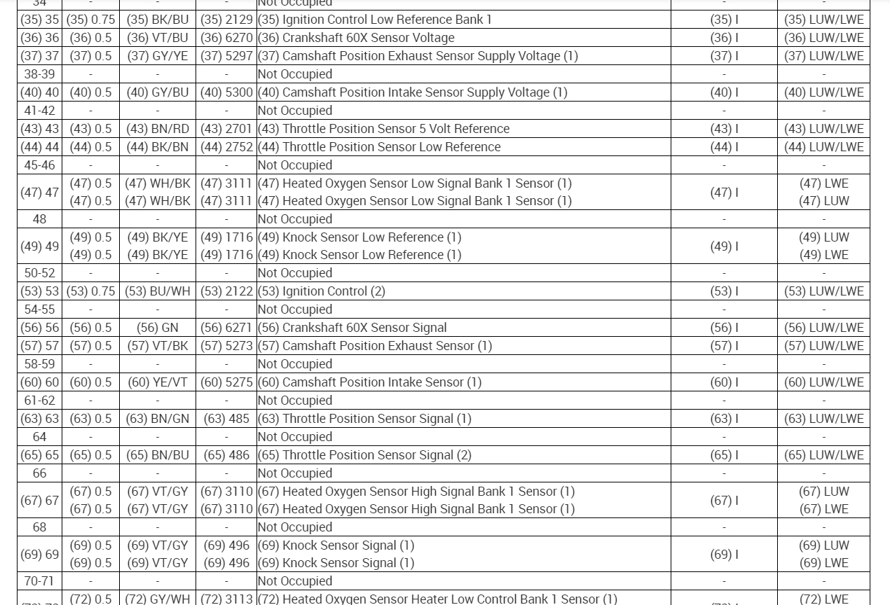

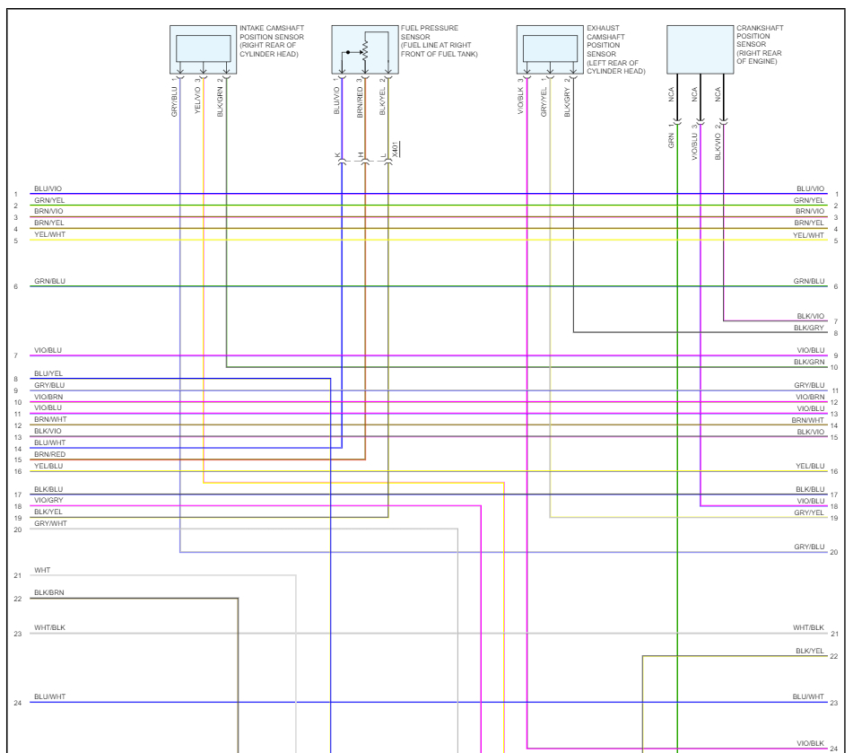

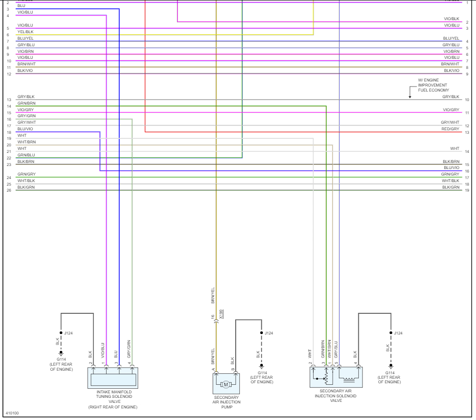

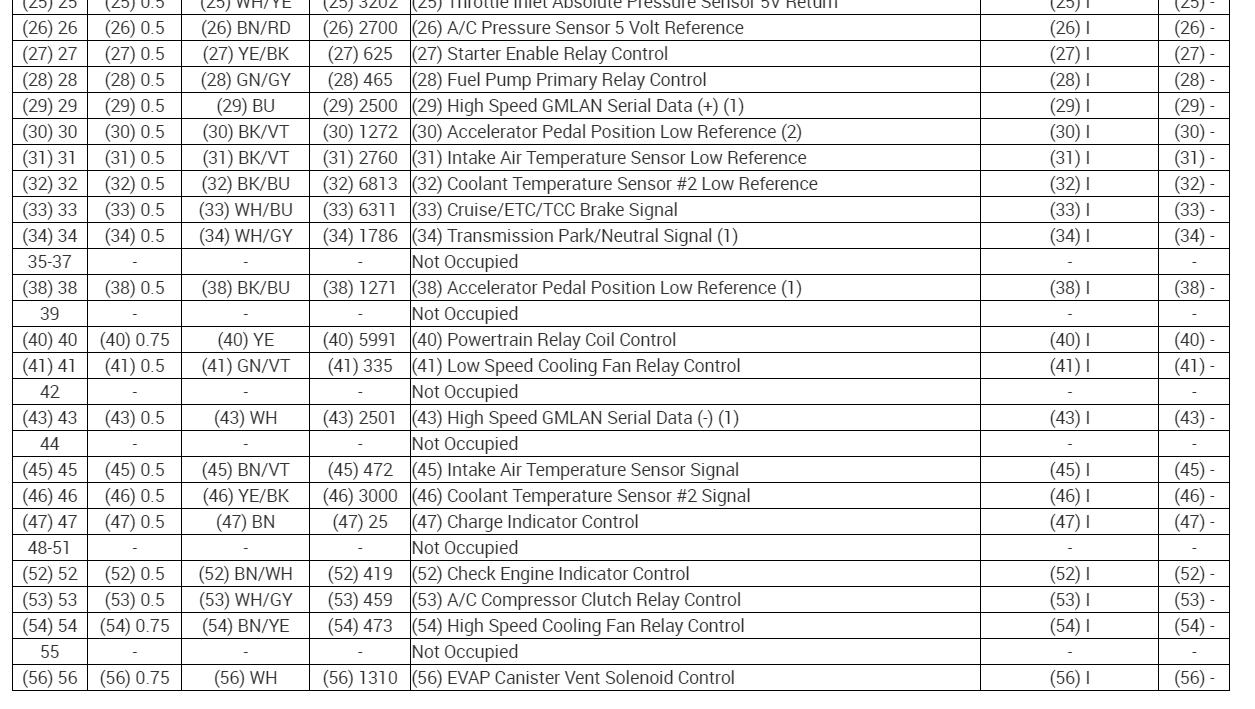

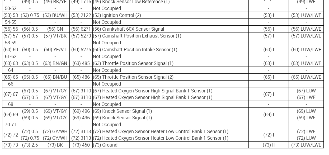

Hello Mr. Ken, I put the new battery on, and the problem continues. I was wondering if you had the ECM x2 pinout diagram for the 2013 1.8l Chevy Cruze.
Aug 12, 2023 at 7:35 AM
  • 55,721 POSTS
Can I see a video of the engine cranking over? Here is the pinout and PCM wiring diagrams requested and a guide to help you test the connections:
Check out the images (below). Please let us know how it goes
Aug 14, 2023 at 4:09 AM
