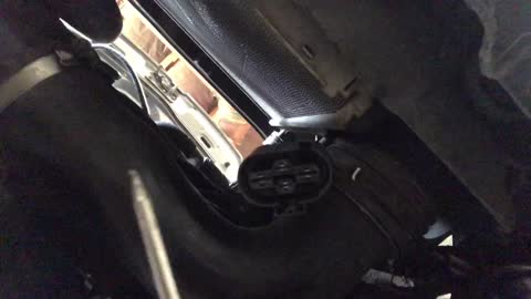

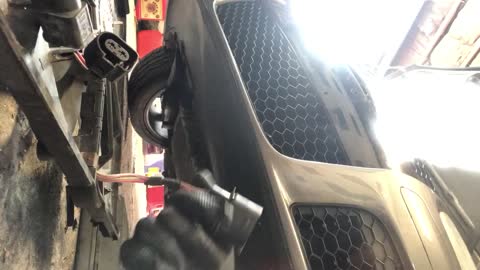

There is ground coming from the big wire coming down which connects to the big fan and there is positive as well, but when connected, there is no ground at the smaller fan connector, which feeds from the big fan.

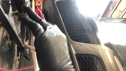

These videos may explain it better. I also went to Advance and borrowed the whole fan assembly, they let me do that, hooked it up, same thing neither one are running with A/C on.

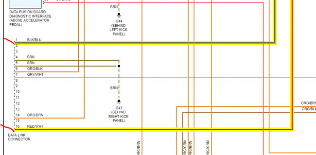

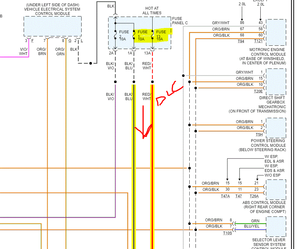

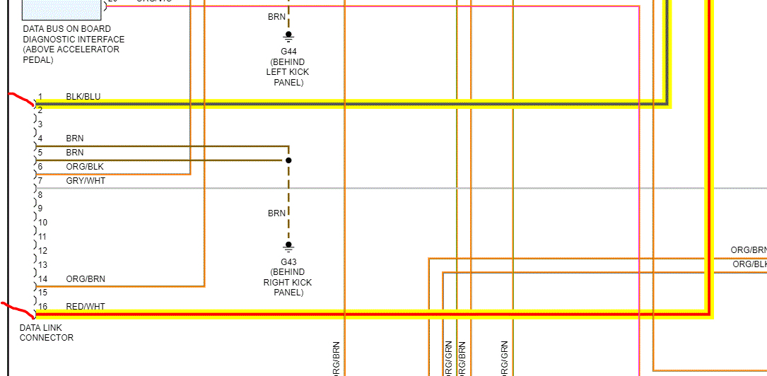

Okay, lets step back and check two fuses. See picture 1. If the fuses are good, check pins 1 and 16 on the DLC for power. See picture 2.
