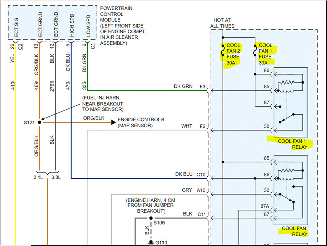

Have you done the basics such as check fuses and relays? If you look at pics 1 and 2, they show the entire wiring schematic for the cooling fan circuit. I highlighted the fuses and relays.

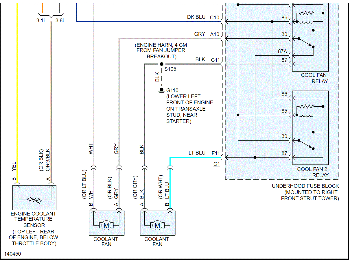

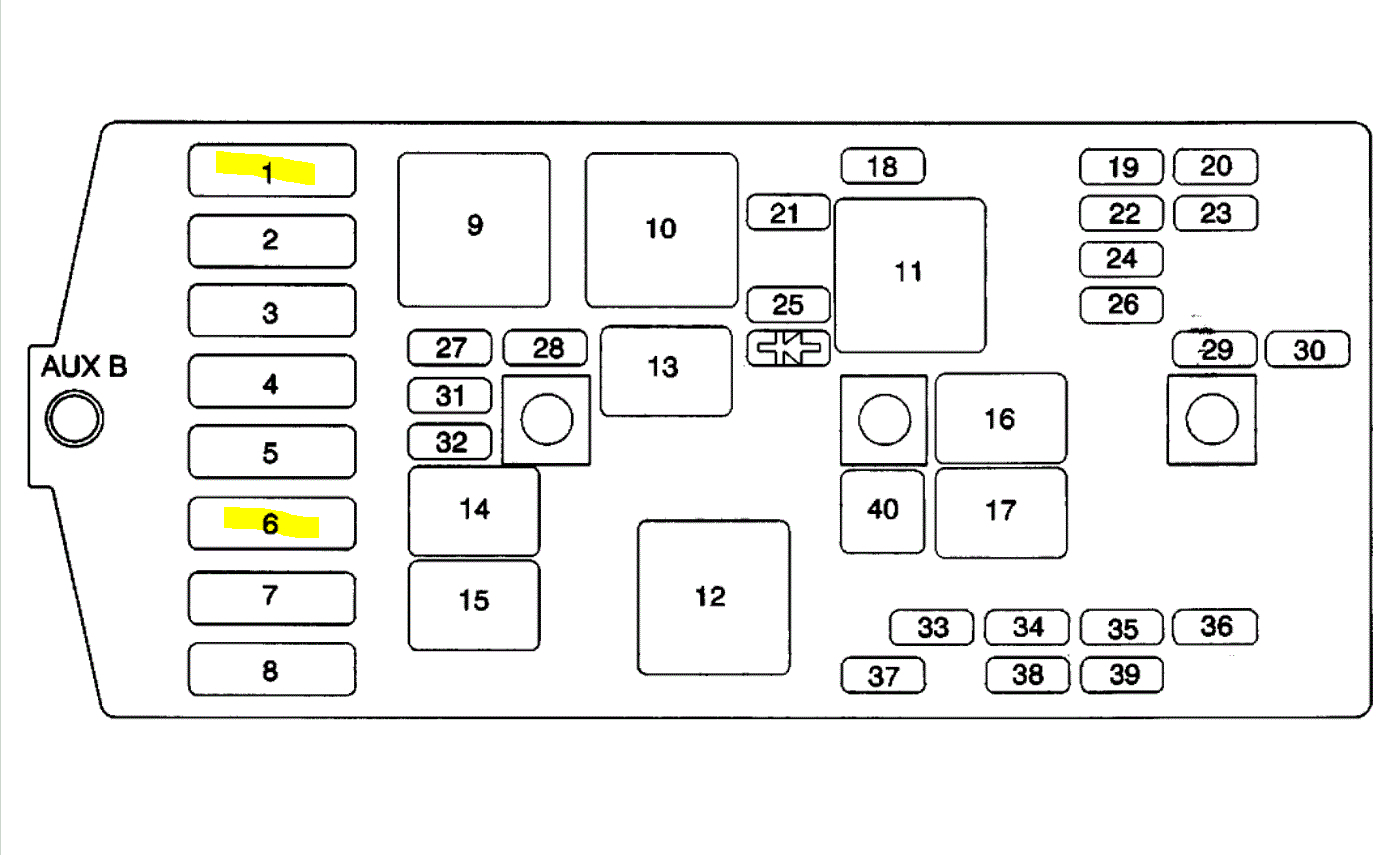

If you haven't checked the fuses, do that first. In pic 3, I highlighted the two fuses which power the cooling fans. In addition to checking the fuses, make sure there is power to them. Here is a link you may find helpful:
Also, switch the relays with different ones in the box having the same part number and see if that makes a difference.

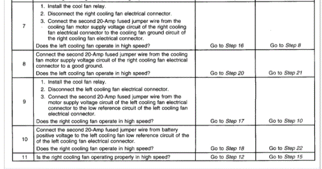

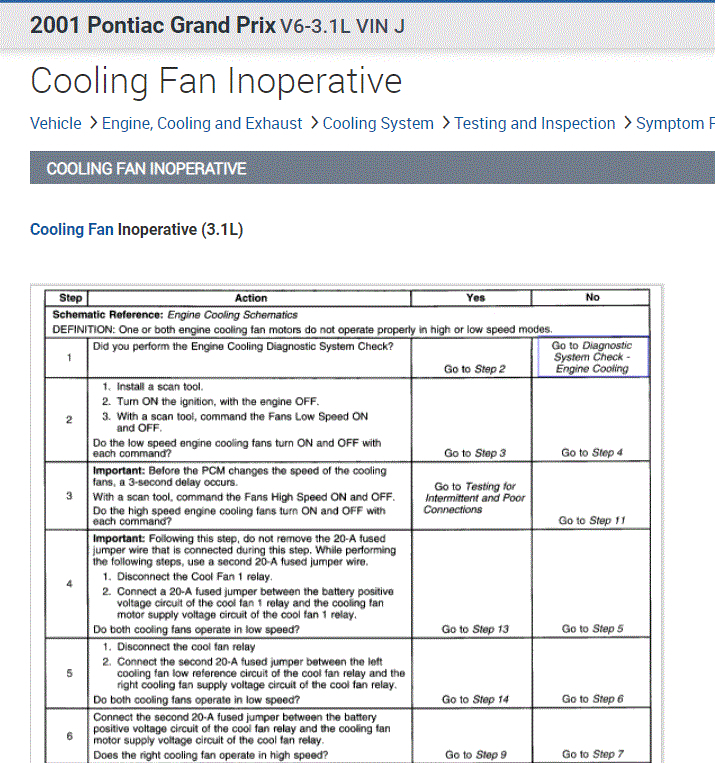

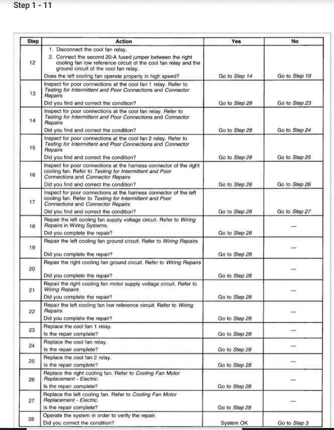

The last pics are the diagnostics for inoperative cooling fans. Take a look through them and see if you are comfortable performing the tests.
