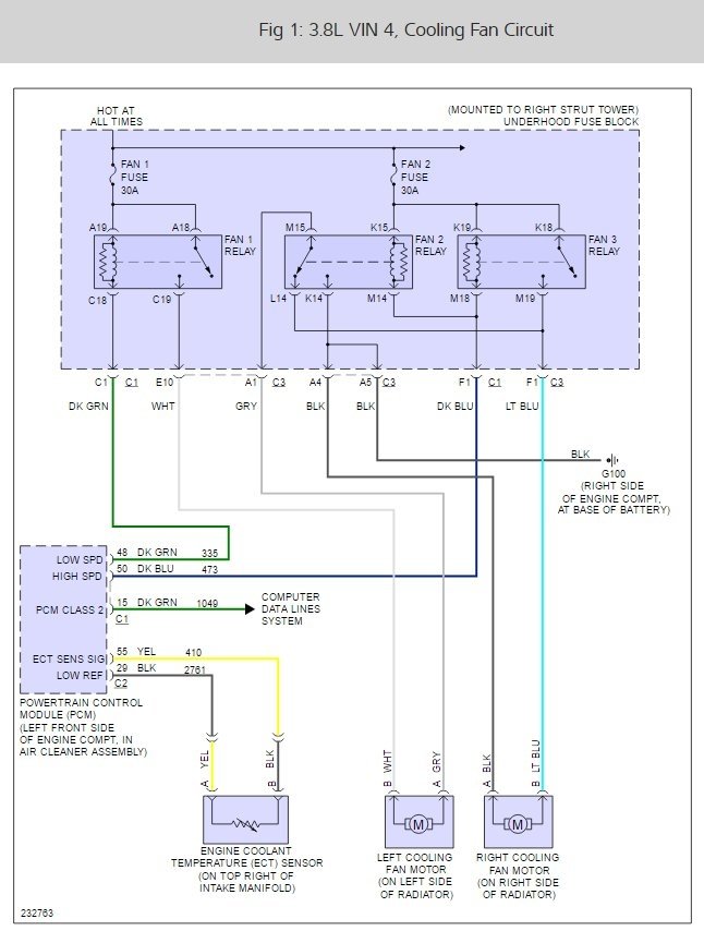

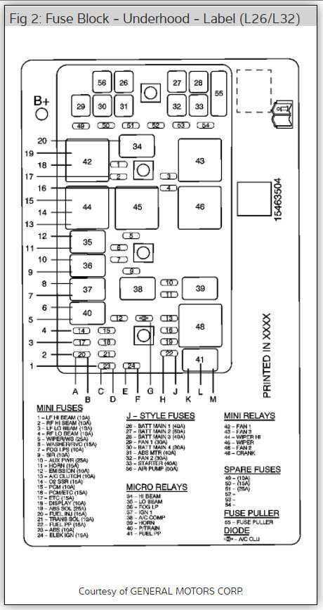

The fans are not coming on. What could be the cause of this?
Nov 12, 2009 at 12:45 PM
BMRFIXIT
  • 19,053 POSTS

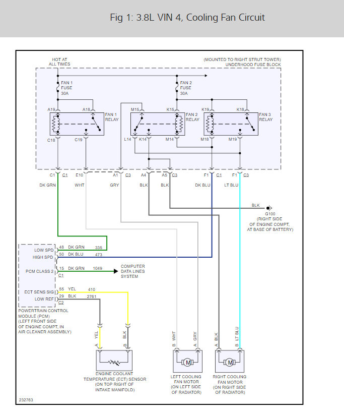

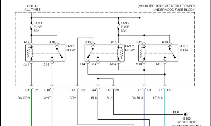

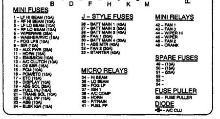

It sounds like it could be a fuse or relay not working but to be sure here are two guides and the cooling fan wiring diagrams so you can see how the system works with the fuse and relay locations as well.
and
Check out the diagrams (Below). Please let us know what you find. We are interested to see what it is.

Yes, It was overheating and loosing coolant. We could not locate a leak, we replaced the thermostat and now we found that the fans are not working. Can you tell me where I can locate the fan switch and fan relays so that I can check them?

did you check for codes check fuses and relays under the hood

I checked the fuses but I am not sure the relays were checked. Is there a fan switch I can check? And what codes and where would I find them?

It sounds like a relay could be bad or a fuse, Here are some guides and the radiator fan wiring diagram (below)
and
and
Please run some tests and get back to us so we can continue helping you.

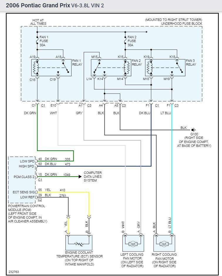

The cooling fans on my 2006 Gran Prix do not come on. What is up?

That could be either the fan relay or the fan motor itself. Follow the guides and wiring diagrams below to troubleshoot the problem.
https://www.2carpros.com/articles/how-an-electric-cooling-fan-works
Please run down these guides and diagrams and report back.

Thanks for the guides. Replaced the relay and it is working great again.

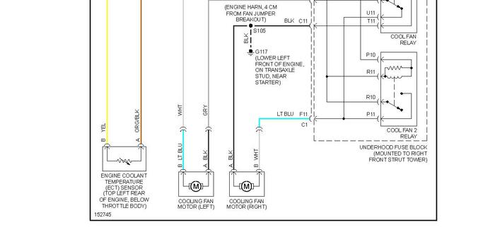

We have a 1998 Pontiac Grand Prix. Cooling fans work when AC is on, but they will not turn on when engine gets to 230 degrees Fahrenheit without the AC on. We have swapped relays, changed the coolant temp sensor....still no luck. Anything we are missing? We know the coolant 1 and coolant 2 relays are working because the fans come on with the AC. Not sure of the function of the other NO/NC relay.

Your car is responding exactly the way it was designed to. It was programmed to come on at 230 without A/C
Here is a description of the circuit from the service manual
ELECTRIC ENGINE COOLING FAN AND RELAY
These vehicles use 2,360 mm (14.2 inch) cooling fans to aid air flow through the radiator. Electric motors drive the cooling fans. These motors are attached to the radiator. Motor size varies with each engine option.
A coolant temperature switch activates the fan motors. This switch regulates voltage to the cooling fan relay. This switch operates the fan whenever the engine coolant temperature exceeds 11O°C (230°F). For location and diagnosis, refer to Diagrams. A transducer can also activate the circuit, depending on the A/C compressor head pressure going to the condenser.
The engine cooling fan relays provide the high current required for the cooling fan motors using a low current signal coming from the Powertrain Control Module (PCM) . This signal is a function of various inputs.
Refer to Diagrams for further information and diagnosis of the cooling fan relay.

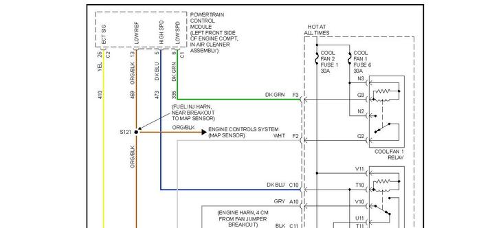

my cooling fans are not working and my car's thermostat is indicating that it is hot. What can possibly cause my fans to not work? Can it be my fuses and what will happen to my car if I continue to drive like that? What do you suggest I do and what must I check to confirm the problem a-z
Mar 10, 2019 at 4:13 AM (Merged)
  • 75,992 POSTS
Direct battery voltage to the fan motor if its comes on-start checking the fuse/relay/coolant temperature sensor/sender to include the thermostat.
