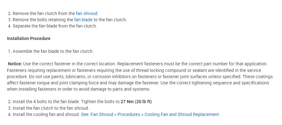

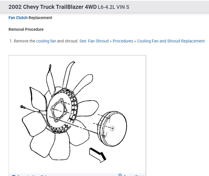

Let me know. As far as the fan clutch, here is a link that explains in general how one is replaced:
https://www.2carpros.com/articles/fan-clutch-removal
If you look below, I attached the directions specific to your vehicle.
Let me know if this helps.
