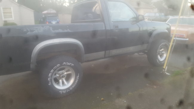

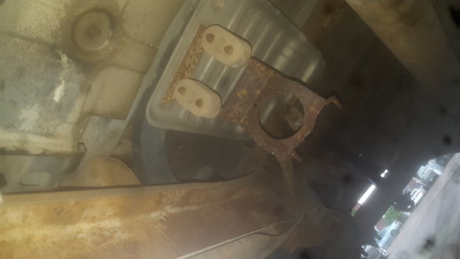

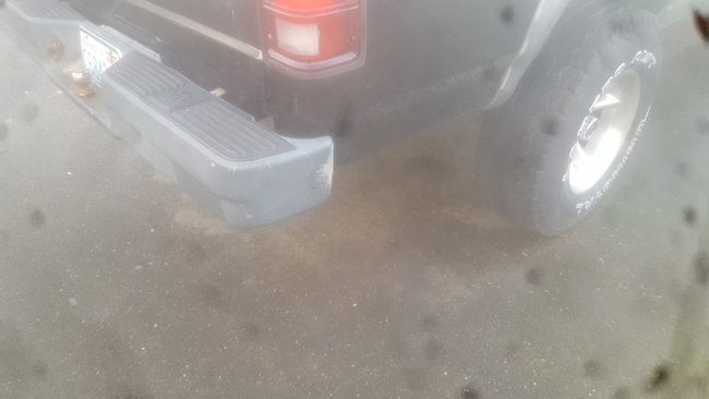

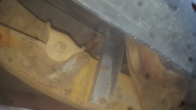

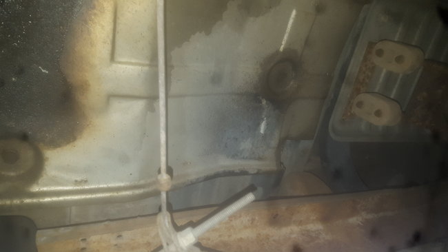

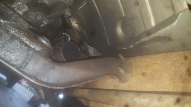

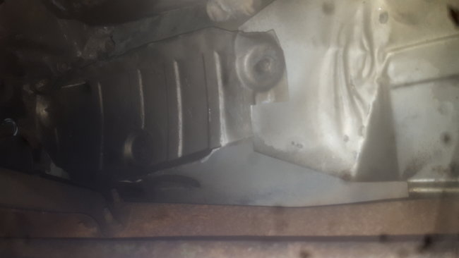

So for the past two years this has been my project truck and I've done everything myself to get it going. But when I did the clutch I had to do some exhaust cutting so all that's left is the Y pipe that goes from the manifolds down to the O2 sensor. I have never once welded in my life but I'd like to do the exhaust myself. I only have about $220.00 saved up and I'd like to do the exhaust on a budget and learn some welding while I'm at it. I'm thinking about doing the exhaust short and simple having it come out before the back tires and possibly up and over the frame, but for me it's easier said than done and I'd like some professional advice in how I should get the job done. Oh, and I've been looking at mufflers and I cannot really tell what kind I should get but my only preference is if it can give an idle that people cannot hear from inside their house I don't really feel like being the one really loud guy that starts his car in the morning though it would be nice if it had a deep grumble.
If more pictures are needed I can upload more.
Thanks for any advice.

I see it's apart right before the catalytic converter. Federal law requires a converter to be installed. With that in mind, I don't know the state you are from, so be careful with where the exhaust exits. Make sure what the state requires.
Next, as far as fabrication, when it is done, shops have a pipe bender to customize things to what they need. Also, there really isn't enough room to take the exhaust over the frame. It will hit and create a ton of heat under the bed, so I don't recommend that.
Now, as far as welding, the best thing to do is get some scrap metal and give it a try. The exhaust will need welded in a manner that requires there are no pin holes in the weld. For the muffler options, I really recommend you ask the local parts store. There are so many aftermarket ones available. Plus, you want it quiet in the vehicle and you didn't mention other than that. If you want to hear it when driving (other than an idle) that is going to require a specific type of muffler.
