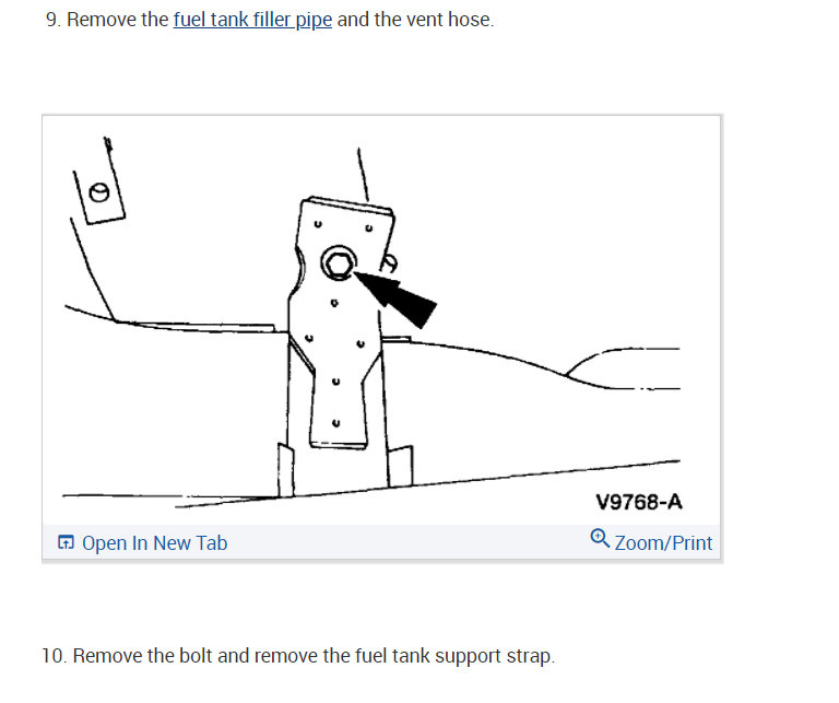

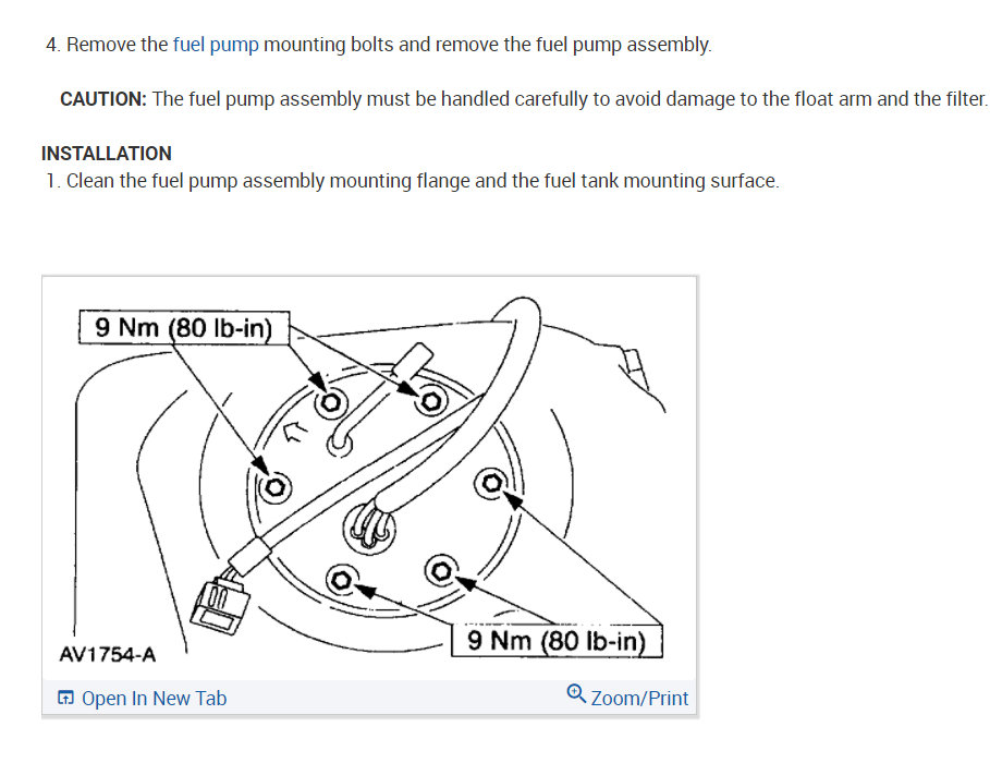

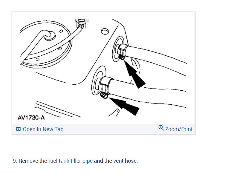

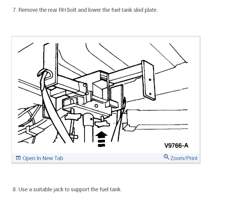

Good morning,

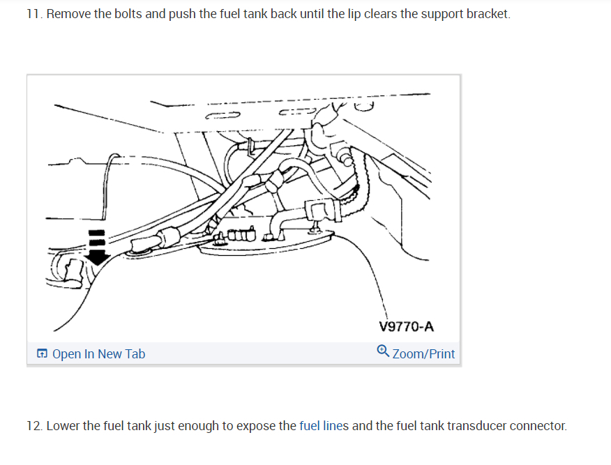

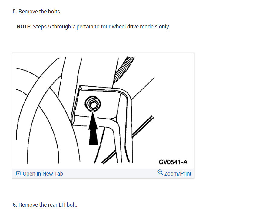

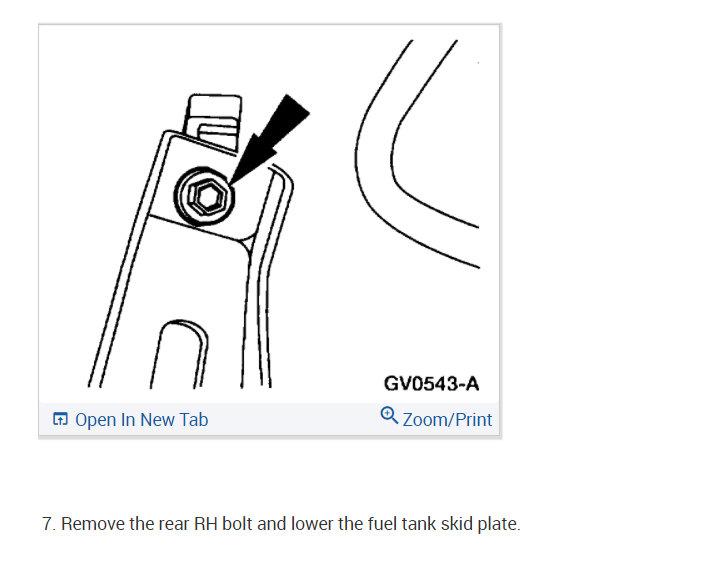

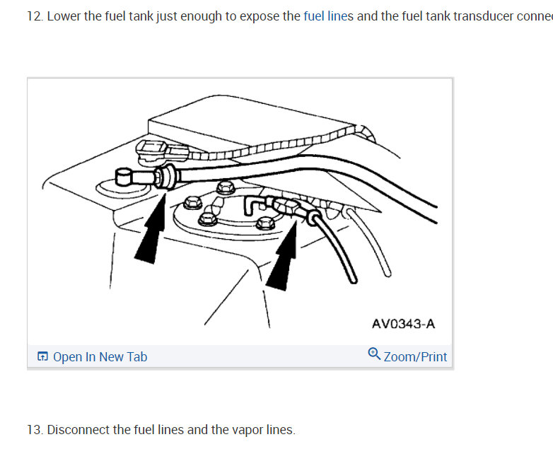

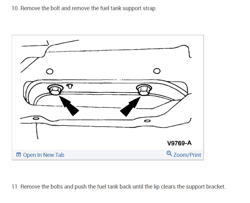

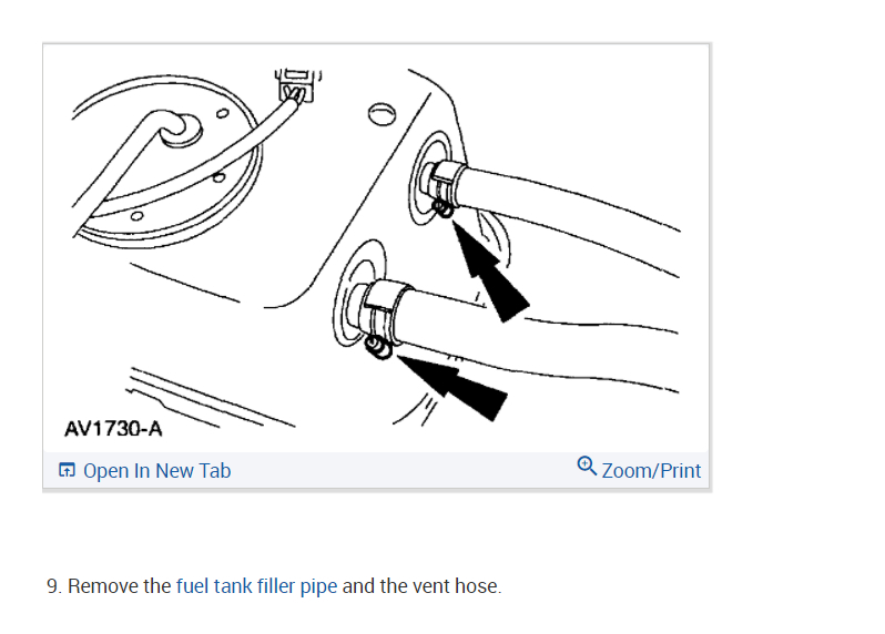

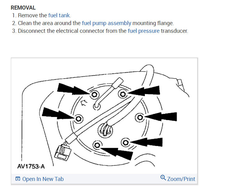

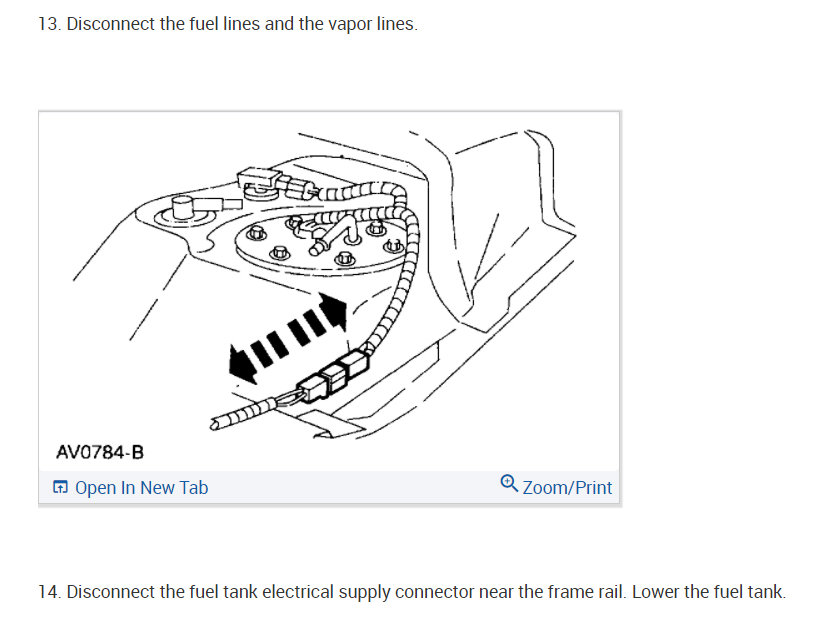

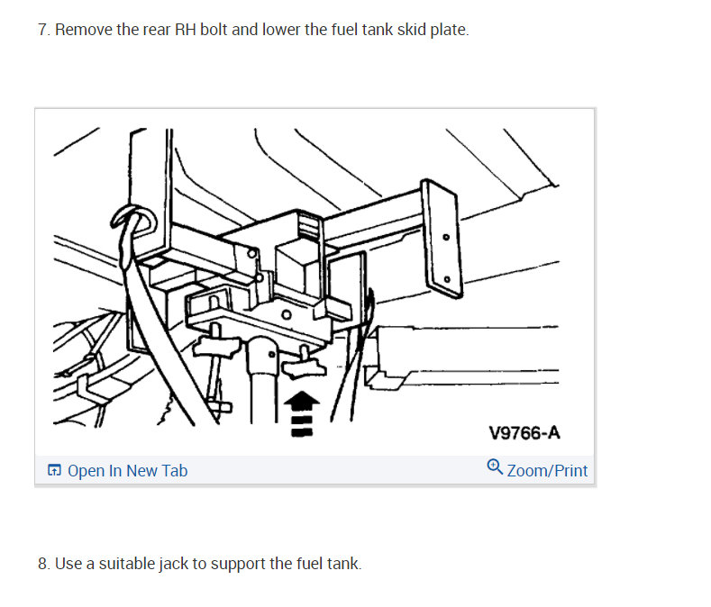

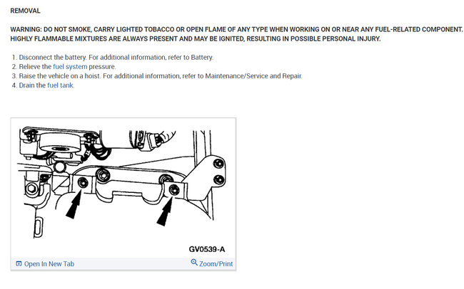

This sounds like a fuel delivery issue from a possible bad fuel pump.
Fuel in the tank keeps the pump cool. When the tank runs low in fuel, the fuel heats up and the pump will overheat. I would check the actual pressure to be sure it is putting out the correct pressure. You can rent a tester at a parts store for the test. There is a test port on the fuel rail to place the tool.
Fuel Pressure .................... 65 +/- 8 PSI
I would also clean the throttle body very well of all carbon buildup. I attached a guide for you for the procedure. Carbon build-up will not allow enough air into the system for proper idling.
