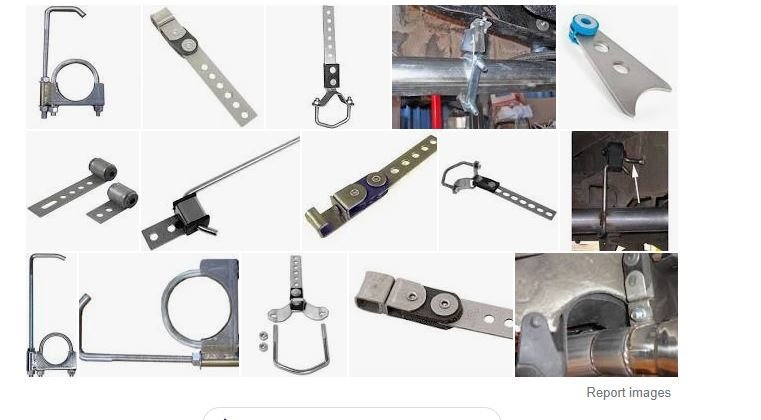

One of my hanging rods for my exhaust rusted off one in the middle and one closest to the muffler. where is an ideal spot to try to hang it from that wont interfere with moving parts as I'm driving? Thank you in advance.

Good morning,
You can get universal hangers at a parts store and mount one end to the body and the other to the muffler to secure it.
https://www.2carpros.com/articles/how-exhaust-systems-work
I attached a picture of the hangers available for this repair. Any parts store will carry these in their stores for purchase.
