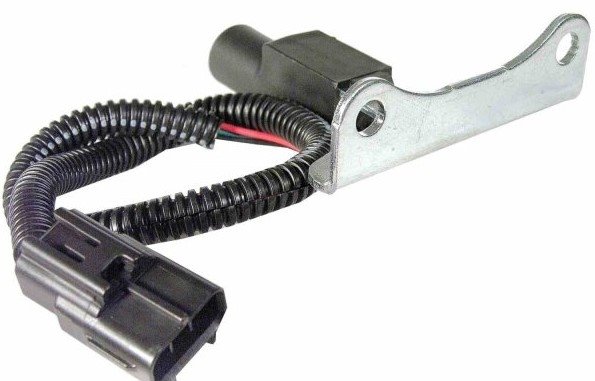

My 9vehicle doesn't seem to be running hot, temperature gauge normal, no boiling, etc. But under the hood seems excessively hot, so much so that it causes the truck to shut down. Once it cools off it will crank and go until it gets excessively hot again, normally after about 15 or 20 miles or so is when it shuts down.

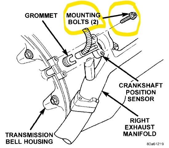

That description sounds like a failing crankshaft sensor. On that engine it is located above the passenger side exhaust manifold. It is held on by two bolts. You remove the bolts and remove the sensor. To get to it remove that tire and then the fender liner plastic, which allows access to the sensor at the rear of the engine. The new sensor just bolts in, and you tighten the bolts to around 8-9 ft lb.
A quick test to verify that it is the problem would be to cool the sensor off once the engine shuts down, the cans of air you can get in office and electronic stores will work for that. Simply shake the can and turn it upside down. Don't spray yourself as it can freeze your skin instantly. Run it until it shuts down, spray the sensor, if it starts back up when you get back into the seat you have your answer.
