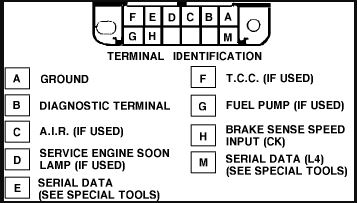

Normally the radiator hoses will be close enough to the same temperature you wouldn't feel much difference at running temperature. You said the fan doesn't come on? That could be the cause of it running hot if it doesn't work. For that I would look at the temperature sensor as you said it does turn on with the A/C, That means the power, relay and the rest works. It just may be that the coolant temperature sender is faulty, the resistance numbers for testing are in the diagram. You could test that by grounding pin B in the test connector under the dash. If you ground that and the temperature comes back down to normal then the fan isn't doing it's job.

Sender was replaced so I do not think that's the issue. I will check your recommended diagnostics. Maybe I should just replace that radiator? Would that seem to be the weak link in the lack of cooling? This inspite of not finding a "cool spot"??

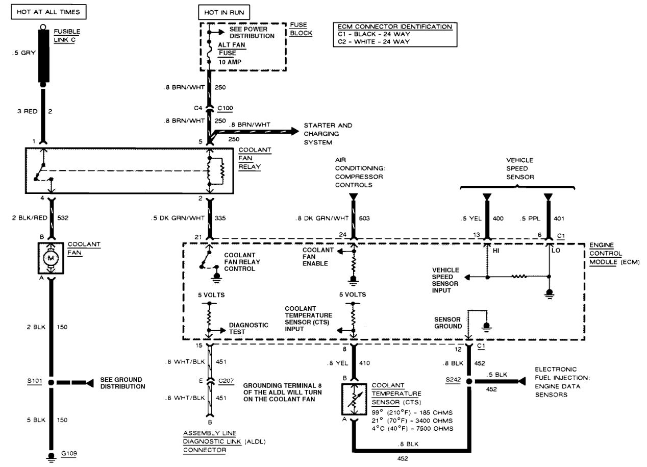

Going back to define cool spot on radiator. A good portion of the right side stays about 260F while a bottom portion indicates 390 to 400 F . Is this a normal heat distribution?
Thanks so much for your continued help. My sensor harness by the way indicates 12V to the connector. Looking at the diagram you attached it indicates 5V ??

There should be two sensors if I recall. One is for the fan control and one for the gauge.

Sensor for the fan control don't know where this is located. I only know the one on the valve cylinder location. Also I ordered another fan relay, but guess according to the schematic you sent its located near the ECM?

I found my block-check kit and will try it tomorrow. The relay will come soon and there are 3 in a row. I need to know which one is for the fan. The schematic you sent me should indicate the position? Cannot find solution on internet. The closest one is for a Fiero where 3 relays are in a row. I cannot find markings on the panel itself, but will investigate further as it maybe covered in dirt and grease?

The cooling fan relay is mounted above the brake master cylinder on the firewall.
