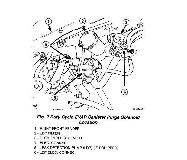

Hi, the fuel trims go negative 30 at idle when the EVAP purge comes on. But if I pinch off the EVAP purge line, LT trims improve to negative 7 and ST varies positive and negative within the zero range.It seems to be pulling fuel from the tank, but I don't understand why yet. Thanks for you help. Frank

This indicates the solenoid is no good. The solenoid is normally closed until the PCM commands the EVAP system test.
Common failure.
I would replace the solenoid and retest.

Thanks for your response. The solenoid is working because I can feel it operating. It starts operating about 5-mins after starting from cold. Should it come on at idle or only when driving? Another thing is; once it runs the first cold start and purges and goes off, it turns on again, if I stop the engine and restart it. I feel that it is staying on too long and running too often. Something I did not mention before is that I can't get the EVAP. nor the catalyst monitor to run no matter how many times I do the drive-cycle. Can this problem also be caused by a bad LDP reed-switch? Is the gas tank EVAP line suppose to be open the purge solenoid when the pump is running? Thanks for your help. Frank.

Just because the solenoid is working does not mean it is good.
I would replace it and retest.
No to the catalyst monitor. The purge has nothing to do with the current issue.

well, I had already bought a new purge solenoid but it did not appear to be making any difference. so I reinstalled the old one just to get a comparison. So on your suggestion, I put the new one on again ran the engine and the purge came on: The LT went to negative 25 and back to negative 14. After I stopped the engine and restarted, the trims are now at negative 7. I suppose it is normal for the engine to run rich when the solenoid is purging, but I have never seen it go to negative 25 to 30 before, that is why I decided to ask for some help. There is still a problem, because the EVAP-.monitor won't run; does that have anything to do with the reed switch Roy ? The LT trims have been running negative 10 for months and I figured it was an exhaust manifold leak and/or, the EVAP-system: I think I fixed the exhaust manifold leak but I am not sure about the whole EVAP system. What do you think? Thanks , Frank
